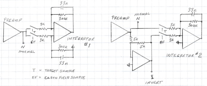

    You are looking at PI_noise_4. I added pictures to show schematic, when I did scope shots PI_noise_4 reply#9 I made an error on the second picture which I corrected in reply#10. Look at first two pictures in PI_noise_6, the first picture bypasses the sampling integrator with a gain of one. The second includes the sampling integrator with a gain of one, noise about four times higher. Why does sampling cause higher noise? Some of the pictures in PI_noise_4 reply#9 were included to answer reply#8

      I started with a 2C integrator, #1 of the thread. The 2C integrator doesn't cancel EF as good as the 1C integrator for me so I have been using the 1C integrator. Had the same problem with the 2C integrator, noise higher than it is with the integrator bypassed. I'm not expecting the amplifiers to lower the noise, want to know why the integrator with a gain of one increases the noise.

          I have found that a 2C integrator does not give as good an EF cancellation as a 1C integrator even if the capacitors are accurately matched and 1% resistors used on both sides. I also put a balancing 200R trimmer ahead of the gates to match the ON resistance. The best EF cancellation is to have a cross coupled differential output stage with a gain of 1x after the preamp which then feeds the two gates and then into a 1C integrator. The 4066 need to be upgraded to a device with better matching between gates otherwise the small differences in ON resistance will limit the cancellation. If you want to keep it, use a balancing trimmer again.
          To make balancing easier, I inject a sine wave of about 4Hz into the preamp input with a summing resistor (220K in my case) and scope the integrator output. Adjust trimmer for zero movement of the base line. I use an analog scope 10mV/cm and dc coupled.

                  This is interesting, is a 1C integrator also known as a single ended integrator ?
                  and how does it cancel EF ?

                      Don't know what all it's called. I removed the inverter and the inverted input from the schematic since I wasn't taking an EF sample for the noise test. A schematic I posted awhile back including the inverter.

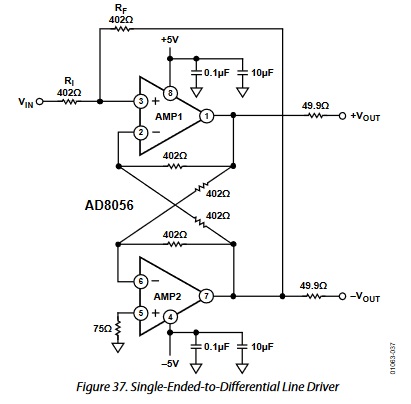

                          The cross coupled stage after the preamp gives two outputs, one normal and the other inverted. That means that after gating, you can sum them into a single ended integrator and common mode signals, such as EF, cancel. You can use just a simple inverter stage but I believe the cross coupled system gives better accuracy.
                          Using the NE5532, I made all resistors 1K, except for the 75R which I believe was 180R (not critical). If you want some gain make Rf variable or different value. Exact symmetry is maintained as gain is varied. You could make the whole preamp like this but I preferred an independent front end. My present arrangement is gain 10x for front end and 47x for differential. You don't need the 49.9R resistors of course and would go straight to your integrator input gates with resistors summed on the inverting input of the integrator, which has a single R and C in the feedback.

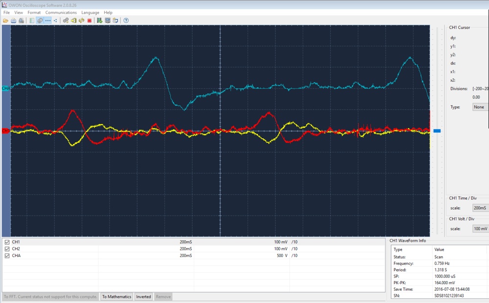

                            NOISE SEEN DYNAMICALLY
                            I like to look at the noise dynamically. Here is the output of the integrator, for a Nickel target pendulum swinging at 13cm above the coil.
                            The coil is 245mm diameter, but I find it better to define the distance as just over 1r, or half the diameter.
                            4 different sample windows are taken, the red and the yellow traces are window 2 and 4. The blue trace is the mathematical function of the scope, channel 1 minus channel 2.
                            The noise:
                            noise level on the board GND, about 10mV PP at frequencies of 2.5MHz, 2MHz, 4.1MHz. I don't know what I can do about that.
                            The most worrysome noises were at 50mV, PP, 0.22 Hz and 20mV, PP, 6.3Hz, so I increased the frequency of the high pass filter to 3.2Hz. Now I will look again in detail at the output traces to see if there is any improvement.
                            The preamp is the LME4999. I am now looking for another opamp with good 1f noise figure.
