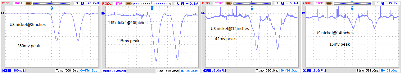

              Monolith suggested using a pendulum to swing the target in another thread(Amplifier frequency response). A test swinging a US nickel 8, 10, 12 and 14 inches above the coil on a pendulum(about 76 inches in length, .36Hz). The target was pulled back 17 to 18 inches and let go and caught on the return. Should be about 1 meter/second peak velocity. Coil, Rx(two eight inch round coils, figure eight) Tx(oval coil surrounding Rx). Nickel centered over point where two coils touch, swings end to end. Loose about 2/3 of the signal for each two inch increase in distance. Eventually you run into noise level. The reason I wonder what is causing the noise increase when sampling. I would be interested if some one would do a test. Look for noise at post amplifier out on a scope, normal and with a added capacitor across the fdbk resistor of the last stage preamp (fdbk RC=200usec to 500usec). I have been getting about 1/4 the peak noise with the added capacitor. The short glitches happen when the control one shots switch and are there even if the scope ground and probe are connected to common. Thought I had solved the glitch problem, evidently not.
              • #52
                Still a very good signal S/N, at 14inches, specially when considering an 8 inch coil. 1.75 times diameter of the TX coil is excellent.
                The glitches seem to be inherent to our quality level Digital Storage scopes. I have also observed various aliasing errors on my scope.
                There is a tiny noise sinewave of about 2K frequency visible on the 14 inch picture. Is that your PP rate?
                The analog switches add some noise. I add a discrete LP filter at the output of the switch that seems to help.
                Limiting the bandwidth to the desired one seems to be a good idea for every opamp circuit, but maybe it would even be a good idea to reduce the pass-band frequency for the initial stages to the absolute minimum in the intention of reducing as much noise as possible before further amplification. In the case of your last stage preamp, I would consider 5Hz as low, but I have not measured the actual target response time of an 8 inch coil. At 1m/s, the time of the target above the 8 inch coil is 200ms = 5Hz, or should we call it 10Hz, as the response is more like a half sine wave? However, at a distance, the detection field is narrower than the coil, so the frequency increases. A common frequency used is about 15Hz.
                I found that for the pendulum, filling a glass bottle with water, so that the pendulum is really heavy, helps keeping the pendulum swinging for quite a while, giving me time to look at the scope and saving traces.

                  green, I recall seeing "1 metre/second" mentioned on other forums..... and what Monolith says about limiting bandwidth ties in with that maybe. Possibly half or even a little more than less than half of what you are using currently...

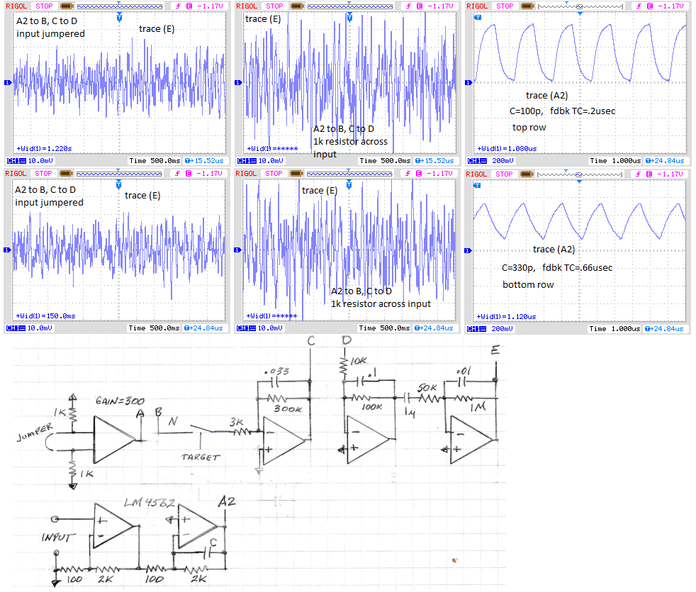

                    Not sure what the 2Hz oscillation is. It's not always there, comes and goes. The butterworth filter overshoots at about that frequency with a step input. Next order I'll add a Bessel filter and try it. Sampling at 1kHz, about 10usec target and EF sample.
                    The noise is a lot lower with the integrator input connected to common, so I'm thinking the switches aren't causing the problem.
                    More scope traces comparing the different output stages in(Amplifier frequency response)thread. Look at the enclosed schematic. Integrator cutoff 16Hz low pass, two more stages with a 16Hz low pass cutoff. More on the added filtering in(Amplifier frequency response). I don't know what the best frequency cutoff is. A scope trace of target signal and noise should give a good indication.
                    I use a bottle of water for the pendulum. I caught it on the return swing so at least half of the trace was noise.

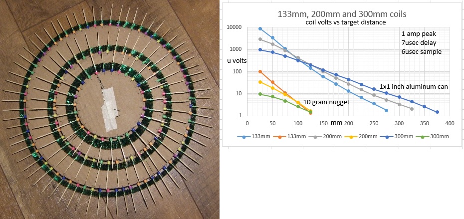

                            I had seen Eric's chart before but I don't remember reading the explanation with it. I ran a test with three different size coils, 200mm/1.5, 200mm and 200mm x 1.5 that I posted in another thread awhile back. Same current profile for all three coils. Instead of same number of turns I multiplied amplitude reading by 300uH/coil inductance for each coil. Same inductance instead of same turns. The results look similar except signal out is the same at a distance half way between their radius. 200mm coil, 300mm coil((100+150)/2=125mm))crossing.
