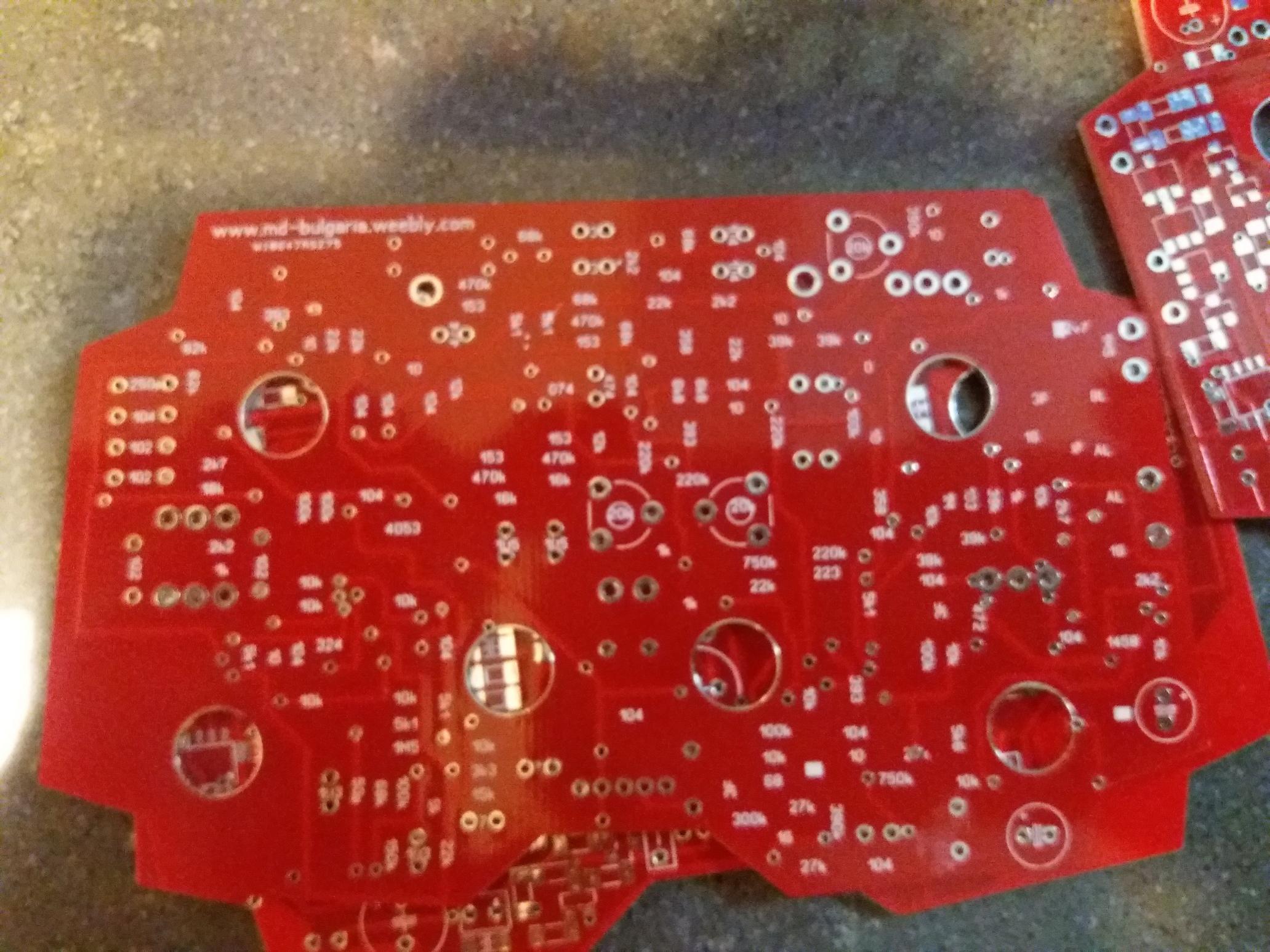

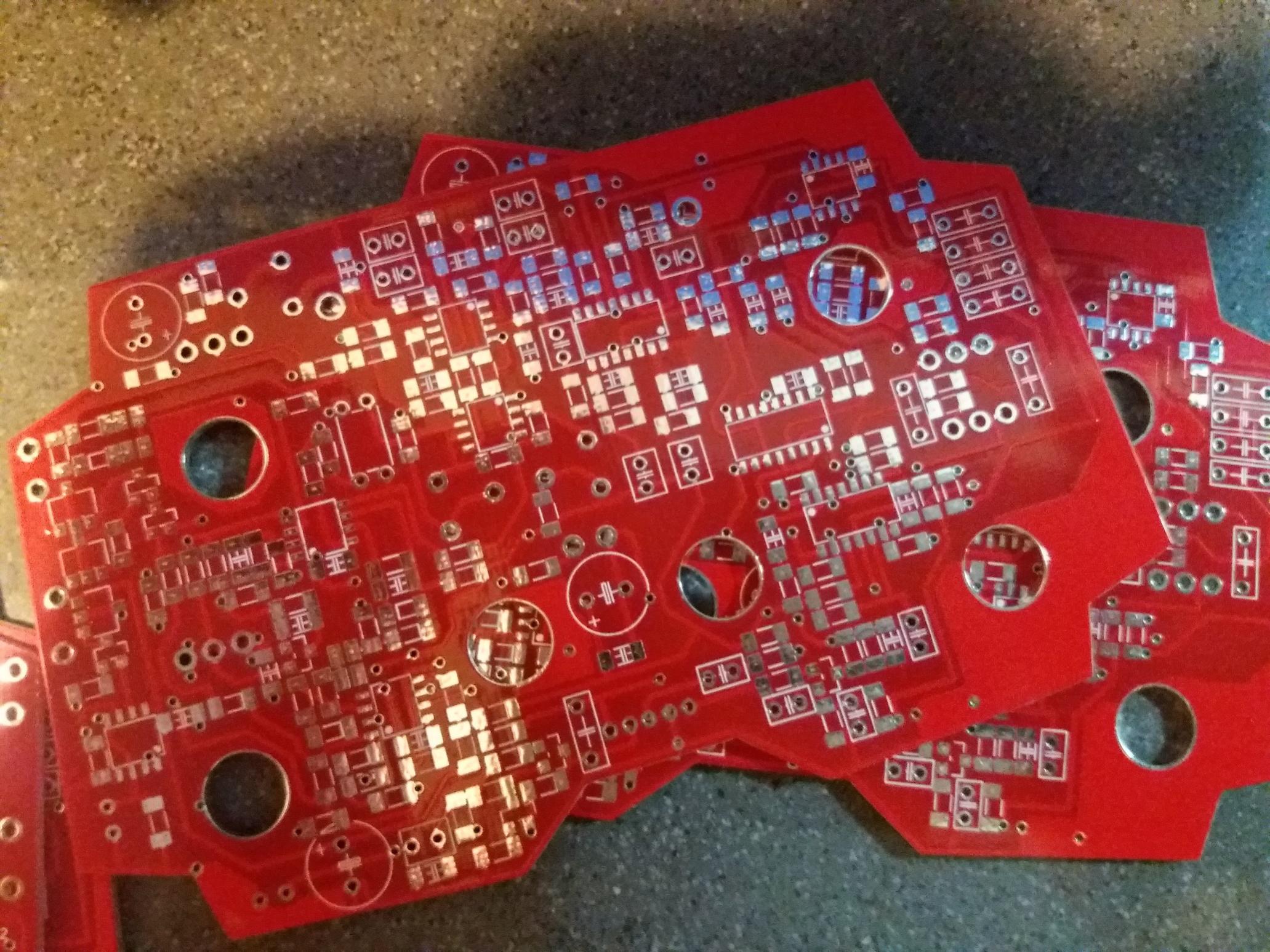

                        • Pcb for Magnum -13 euro+free shiping
                          • Is this a surface mount board?
                            • Originally posted by multieagle View Post
                              yes
