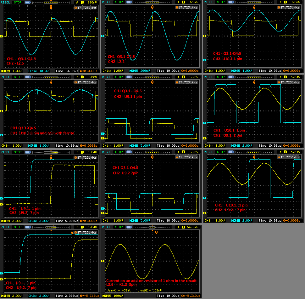

    • about gm5
      some oscillograms
      • What is proper voltage range of Rx offset at input of 4053, about 500mV at 18kHz is it acceptable?

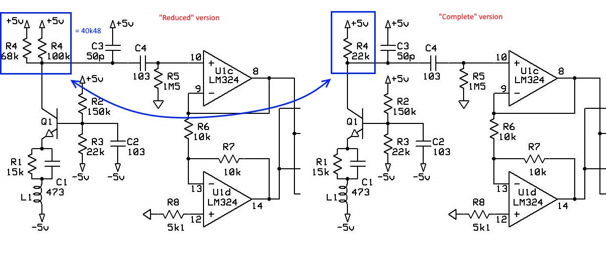

          • Hi Ivconic,
            Thank you for the "Magnum on steroids" project . I noticed a difference between the complete and reduced circuits:
            Could you clarify? (Sorry if this has already been mentioned, but I couldn't see it in the previous pages).
            Mike

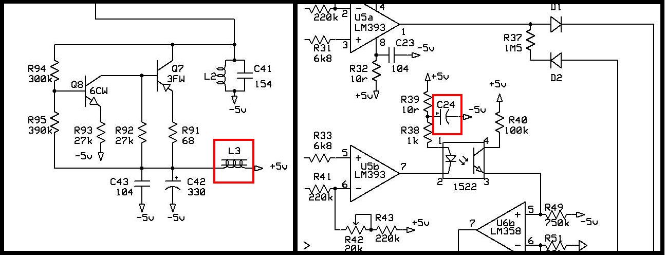

                • Also, what are the values of C24 and L3 please?
                  • As Ivconic said: L3 is there to additionally filter voltage. You can omit it and put a wire jumper. Or put 100uH inductance (drossel).

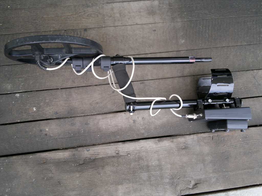

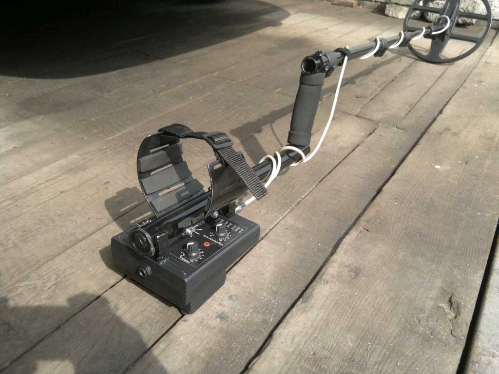

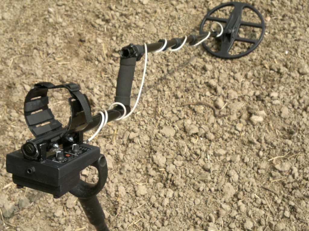

                            • Hello Ivconic, big thanks for this thread. This unit is really deep and fast it really suprised me. Could You please explain more about adjusting R35 and R42 - how to do it right. I`m not sure if i made it correct. Here is my Magnum with 10.5" coil:
                              • Originally posted by reiv View Post
                                [ATTACH]39699[/ATTACH]
                                [ATTACH]39700[/ATTACH]
                                [ATTACH]39701[/ATTACH]
                                Wow, this shaft look's really amazing mate. Are those part's from bike?
