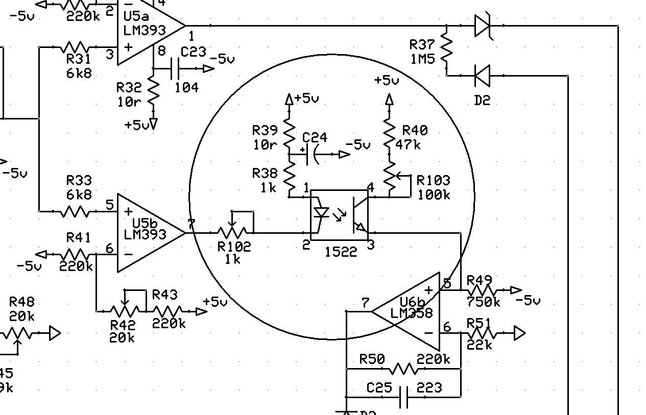

    Can somebody plz tell me what are those marked points? I tried to find on schematic, but no luck. Thank's.
    [ATTACH]37722[/ATTACH]
    "A" and "B" are for switch, 1 or 2-tones audio.
    "C" is optocoupler.
    "E" is inductor.
    For "E" you can put simple wire junction.
      "C" is optocoupler.
      "E" is inductor.
      Many, many, many thank's Ivica. Nothing without you.
      • Hello ivconic Explain the purpose of variable regulators R35, R42, R59, R60, R90. Thank you.
        • Originally posted by Artyom View Post
          R35= Basic treshold
          R42= additional Treshold for 2-tone option, important at switching/biasing the optocoupler
          R59= can be omitted (shorted) or fixed value = additional precise adjustment for "audio pitch", affects frequency and duty cycle at audio generator.
          R90= Audio pitch, audio frequency, also can be fixed value, according to your own preference
          After playing a bit with R59 and R60 i got the impression that those two values can be completely omitted or put as fixed values, not important benefit from having those as variable adjustments.
          R35 and R42 are somewhat tricky to adjust for nice working 2-tone option. Otpocoupler choice can play significant role here.
          I think multiturn trimmer potentiometer is mandatory choice here, just as it is case at original Golden Mask detectors.
          I used ordinary trimmers and i faced somewhat difficulties to adjust them properly. My mistake...

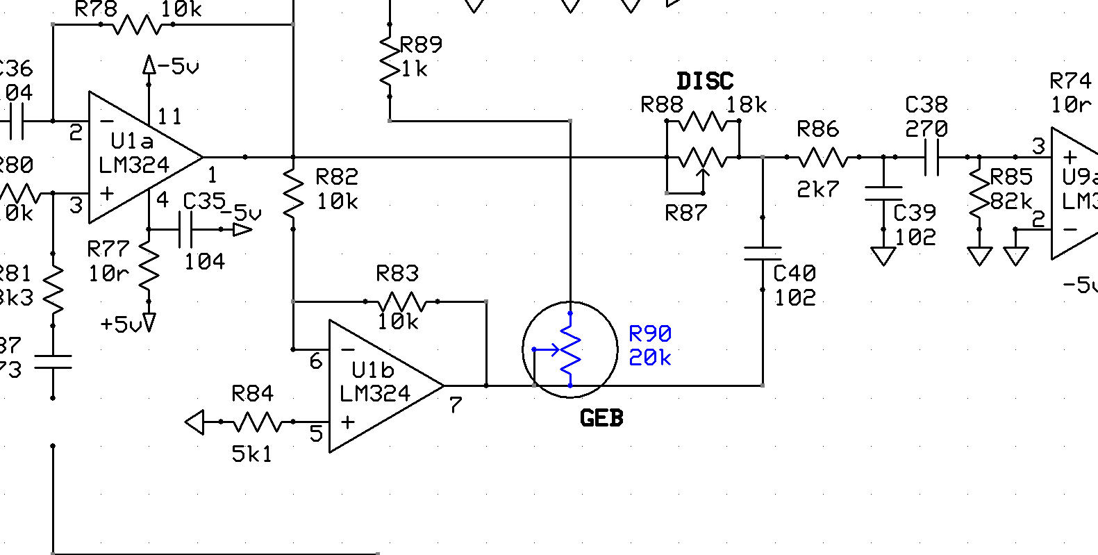

            • Thanks for the reply. Not seen on the ground balance control scheme. The adjustment is carried out?
                "...R90= Audio pitch, audio frequency, also can be fixed value, according to your own preference..."
                This is typo! It should be
                "R60= Audio pitch, audio frequency, also can be fixed value, according to your own preference..."

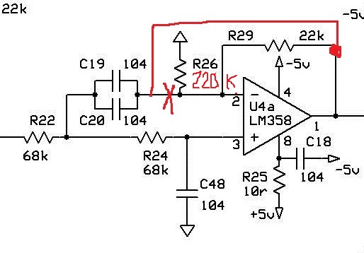

                        • When operating the ground balance with this type of filter to a lot of signals from earth salts. Another reject ground channel similar in Tesoro Golden Sabre must. Many details of the change in tone .Faults in filters?Click image for larger version
                          • Originally posted by scs View Post
                            When operating the ground balance with this type of filter to a lot of signals from earth salts. Another reject ground channel similar in Tesoro Golden Sabre must. Many details of the change in tone .Faults in filters?[ATTACH]37751[/ATTACH]
                            Actually GEB is working very fine and accurate at this detector.
                            It is the DISC which need improvements, it is not quite accurate at higher depths than 10-15cm in a soil.
                            Medium sized rusty iron pieces are easy fooling it.
                            That's the only drawback at this detector (also explanation why it is so successful "collector").
                            Thanks for the suggestion! I will try that way.
