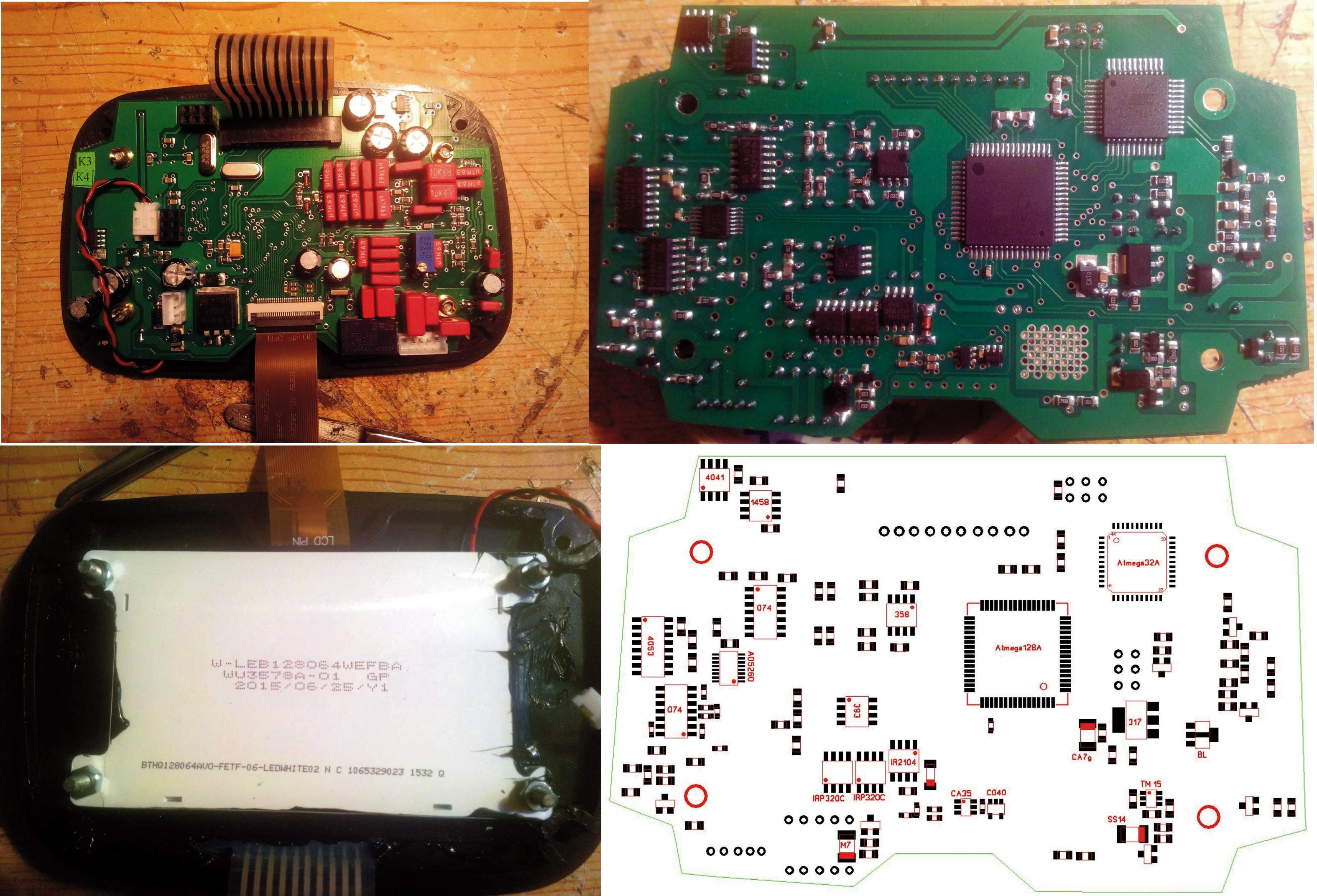

        I think "extra" wirerounds has nothing to do with changing of frequency.
        Those are there wired the same at all models starting from model 1+ to model 5 and serves to provide a portion of TX as reference for synchronous demodulator.
        Speaking of model 5... i tested it detailed for some time.
        It is decent try from manufacturer but i would have some remarks.
        Software, the code, is somewhat slow in behavior.
        There is annoying start up with complicated bitmap and it still haven't finishes; while at the same time you can hear detector behavior in background, for example.
        Walking through menus and adjusting the parameters; i have direct impression that Atmega (one of those two) is used as bare "digital potentiometer" and nothing else.
        Skim look on electronics shows the concept. It is obvious that it is still fully analogue design with addition of digital pot and LCD jingle&bells.
        In essence it is still the model 4. A bit slower and sloppier in behavior. Audio is also kinda mum and inert, comparing to model 4.
        Overall, despite the remarks, i am really impressed with the effort, knowing from earlier that it is small and independent manufacturer who started in similar fashion as many enthusiasts here on forum.
        Fabrication quality is way over the hobbyists level, this is important to point on. Almost competitive to main league.
        Still... if you ask me; model 4WD is my favorite and winer. Way over and far from closest competition and copies i mentioned earlier.

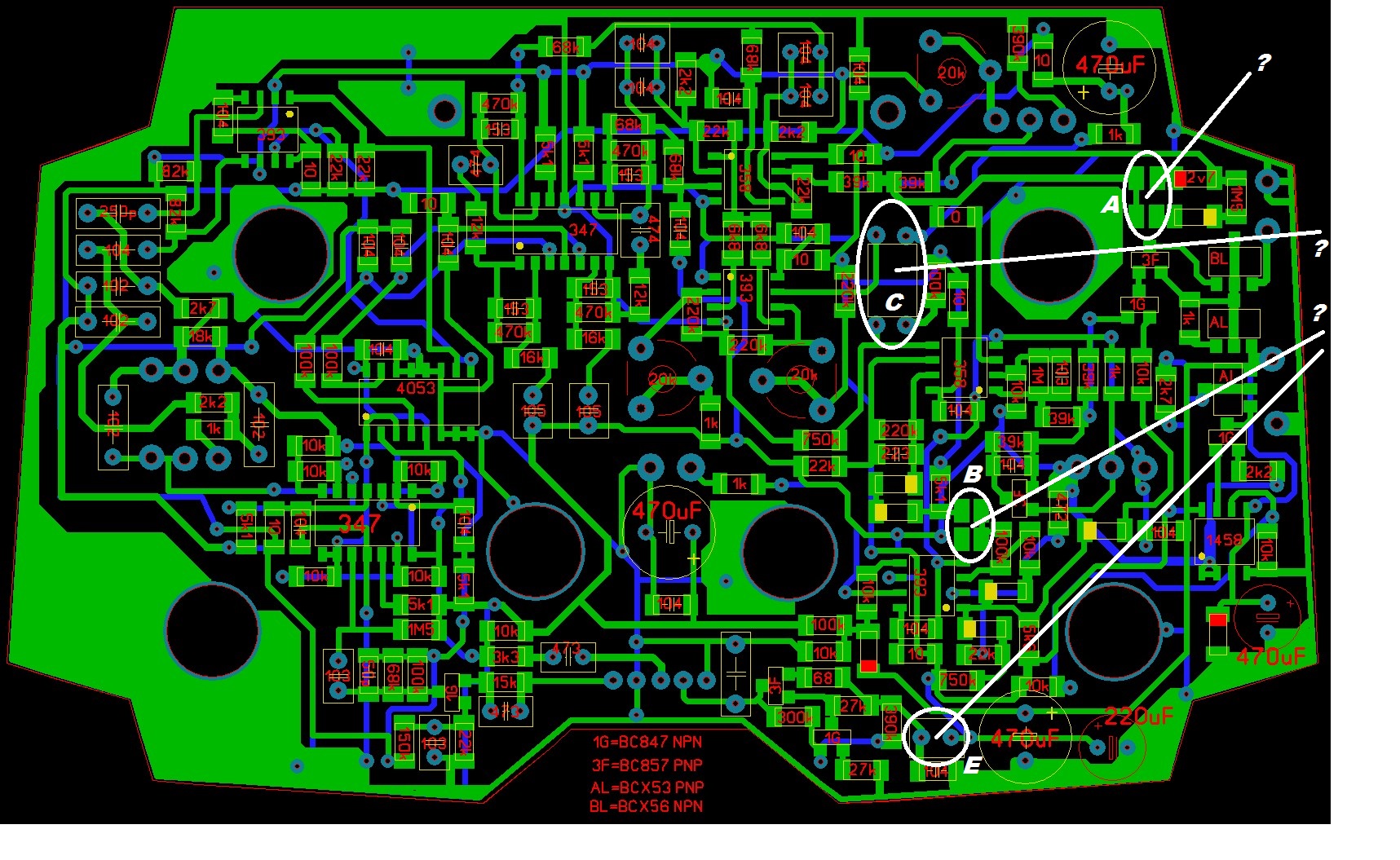

                              • Can somebody plz tell me what are those marked points? I tried to find on schematic, but no luck. Thank's.
