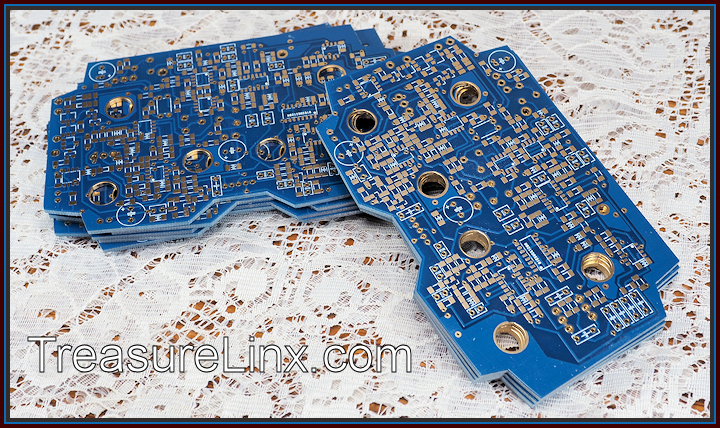

                Had some PCB's made up of "mag_redu_pcb" version:using 1206 sized SMD components.
                Should arrive this week Tuesday.
                I have been studying the schematics and PCB layout this morning.
                  PCB's have arrived, now to hunt down some parts

                        seems like i have to order some from the chinese guy in the hamburg harbour here in germany
                        what manufacturer did you choose sven? itead studio or so?
                        sorry but gold and blue looks like a good adult film ;-)
                        • #42
                          ...i looked the pcb again -holy **** the are so cool

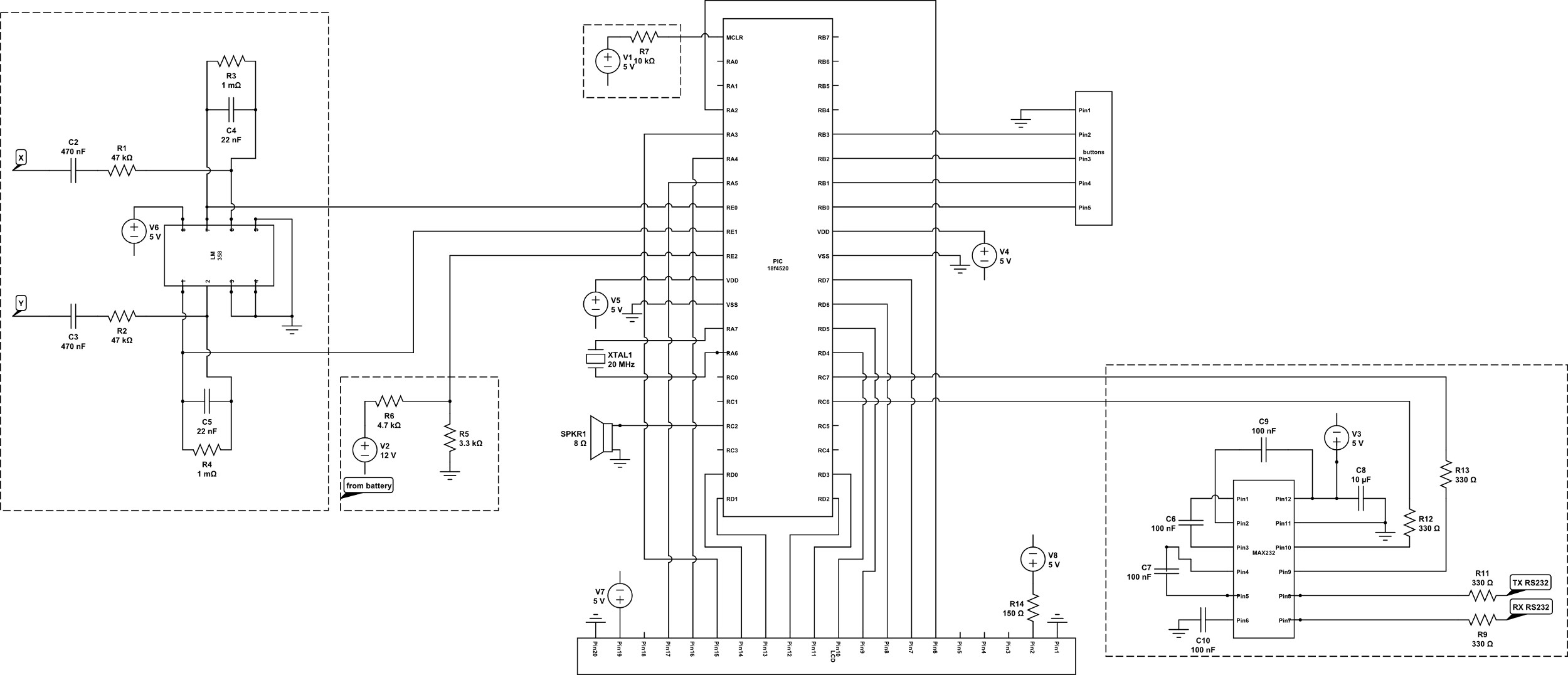

                            can we attach this
                              have mine made at PCBWay http://www.pcbway.com/
                              • #45
                                Good job.....
