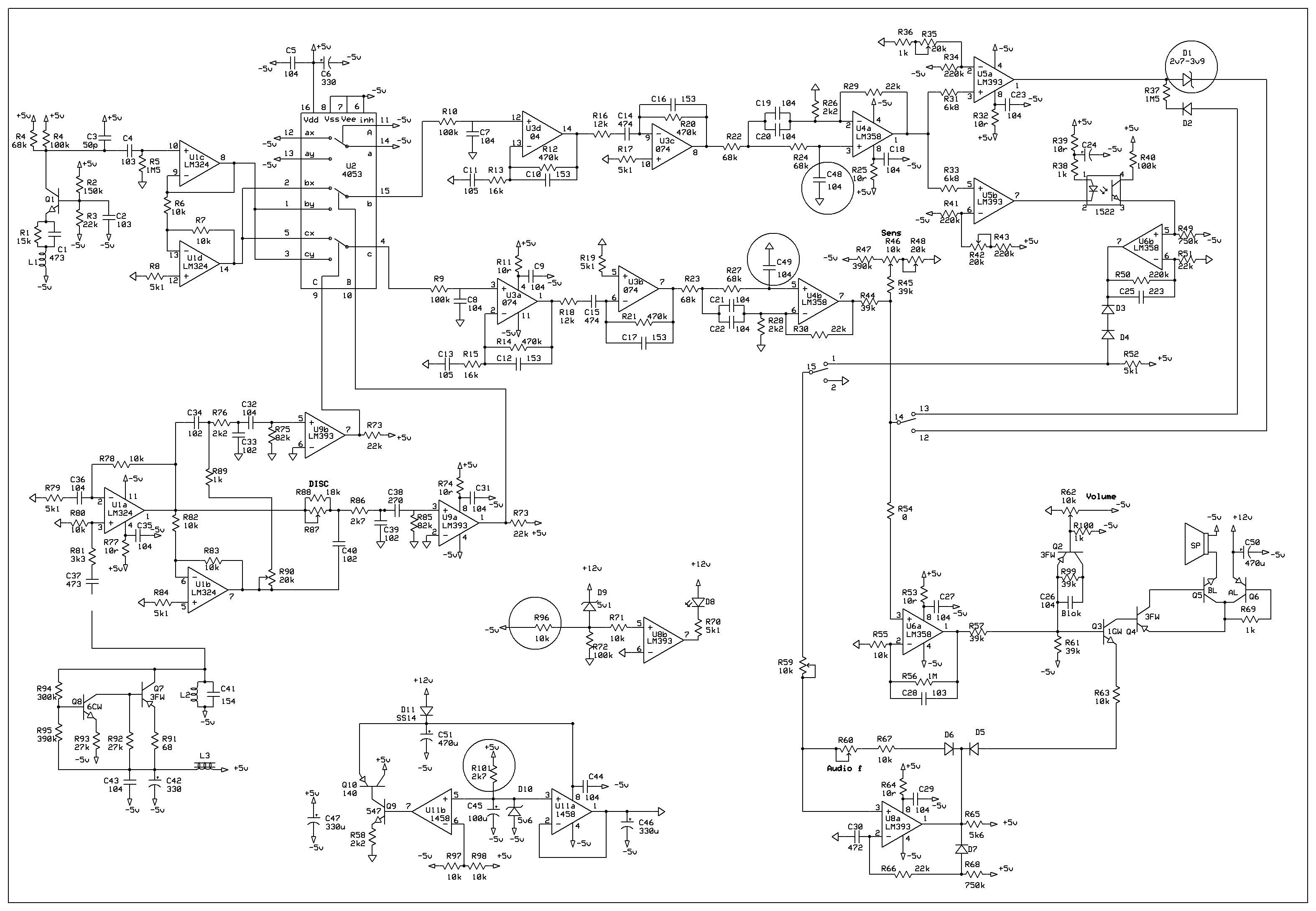

              Ivonic
              Part values?
              After looking at the schematics, I believe i came up with the correct parts values for the SMT board, just not sure.
              Rather than post my guesses here and confuse people as to what is correct or not. Would you please give the correct values.
              Would be greatly appreciated. Thank You
              Electro caps along with min. voltage rating

                It is 4053 on original. 74HC4053 i haven't tried yet.
                LM1458MX (i used MC1458 though), BU4053BCF-E2 and LM324ADR2G should be alright.
                Elcos are 330 to 470uF, voltage ratings usually slightly above power supply, you can use 16v/25v/35v.
                Put all 470uF where you have enough room to place it. Cap no. 4 is 100uF.
                All unmarked SMT caps are 100nF.
                Diodes all 1N4148 SMT equivalents... let's say MMSD4148, LL4148 etc.
                Except for the 3 zener diodes; 5V6, 5V6 and 3V9.
                B on your sketch can be 2V7 to 3V9, i put 3V9.
                A and C are 5V6.
                C zener is for low battery alert (Led diode). Maybe you will have to adjust it for accurate alert level.
                By "adjust" i mean; maybe you will have to experiment with other zener values; 4V7, 5V1...
                It can depend on supply voltage and type of battery you use.
                Actually it is all easy traceable using posted schematic.
                Just follow schematic and see what component is tied where on pcb.
                A1 and A2 are screw holes.
                C1 speaker minus and C2 speaker output.
                C3 is +12V and C4 is battery minus.

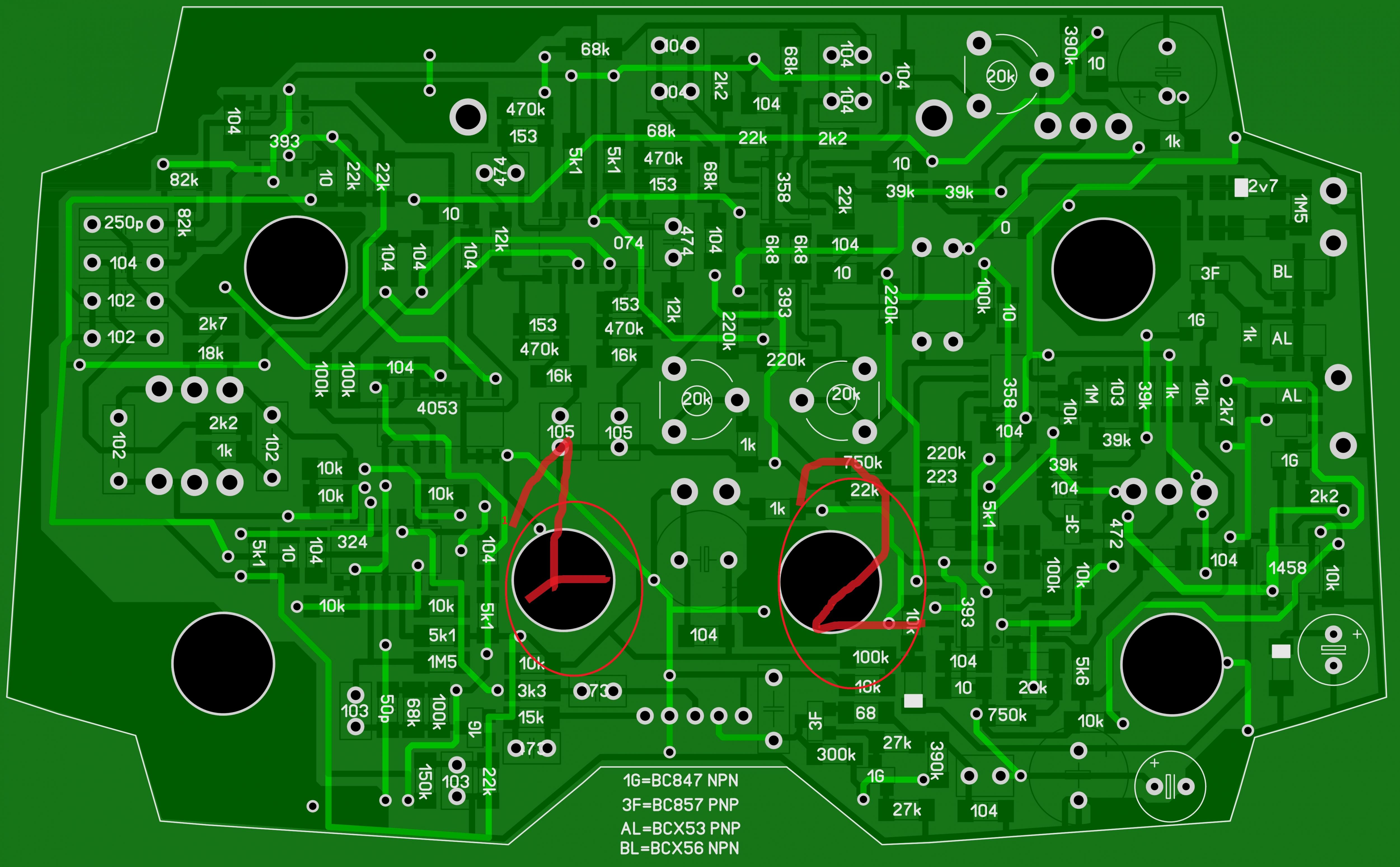

                      these two holes for what they.When the mask is for ground balance for two tones[ATTACH]37181[ATTACH]

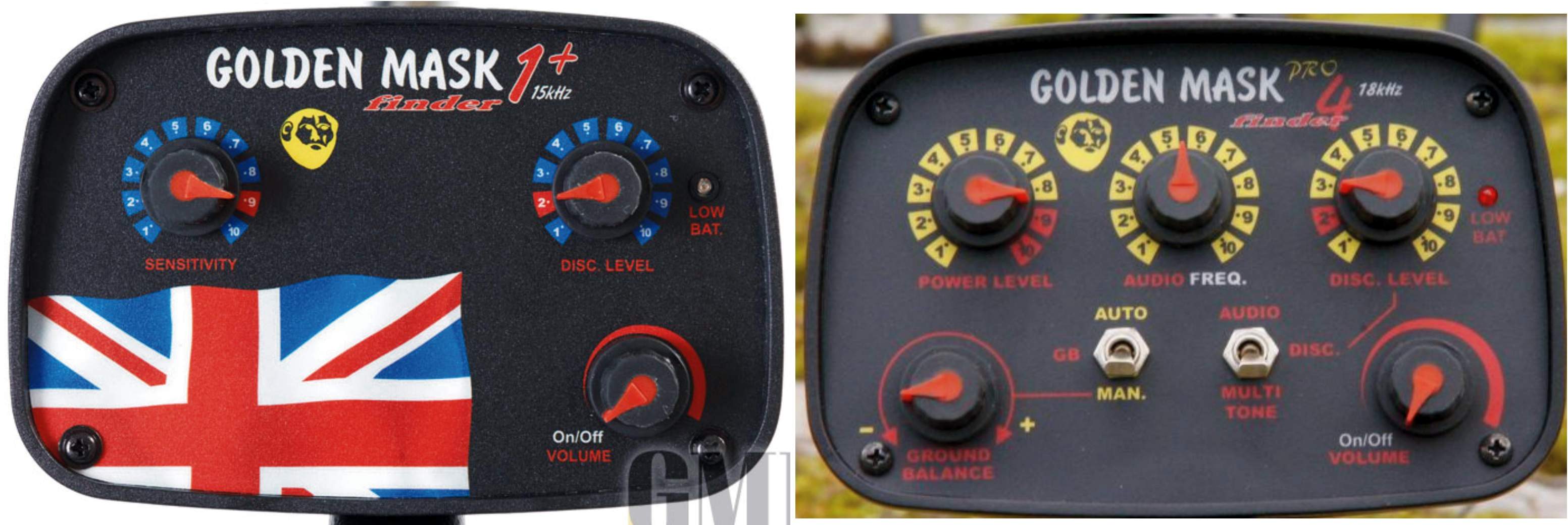

                        From the model "1+" up to the model "4WD" it is all the same pcb.
                        Except for some components added or removed from the pcb and front panel.
                        Some front panel commands are "locked" with fixed presets inside the model "1+",
                        while the same ones are presented on the front panel on model "4WD".
                        According to this you may anticipate the rest of missing components.
                        For example, for changing TX frequency between 8 and 18kHz, you need to add
                        switch and two non polarized capacitors: 100nF and 470nF.
                        "Auto GEB" is fixed preset inside with trimmer and "Manual" is with potentiometer mounted on front panel.
                        Another switch is just switching between them.

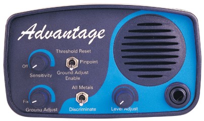

                        P.S.
                        This is nothing new. This is quite old "practice" already seen at some manufacturers in the past.
                        First what comes to my mind is the case of Minelab Musketeers: Colt, XS, Advantage...
                        Pretty similar story...
                        • #57
                          Inside all 3 boxes is the very same pcb.
                          Same story.
