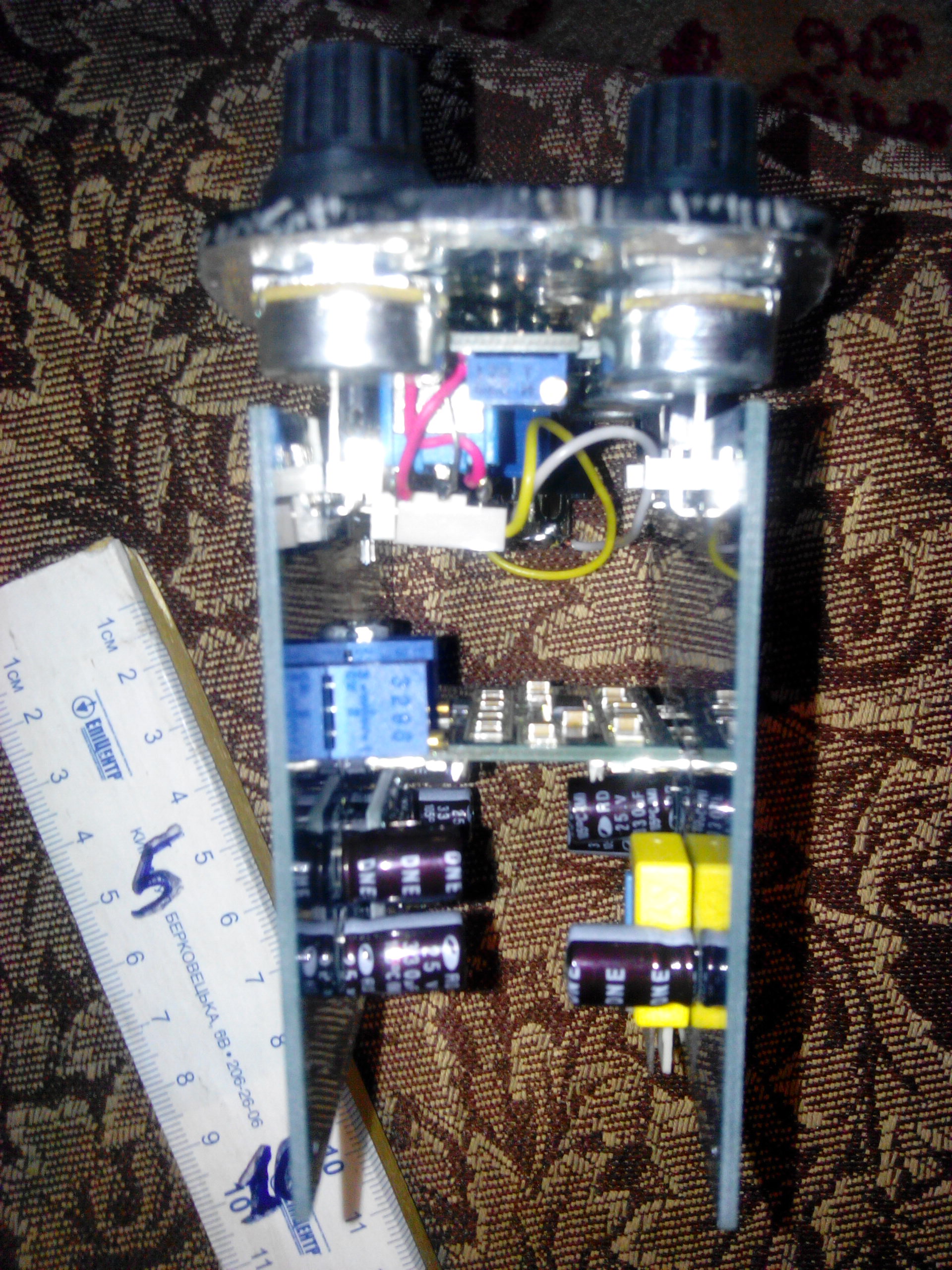

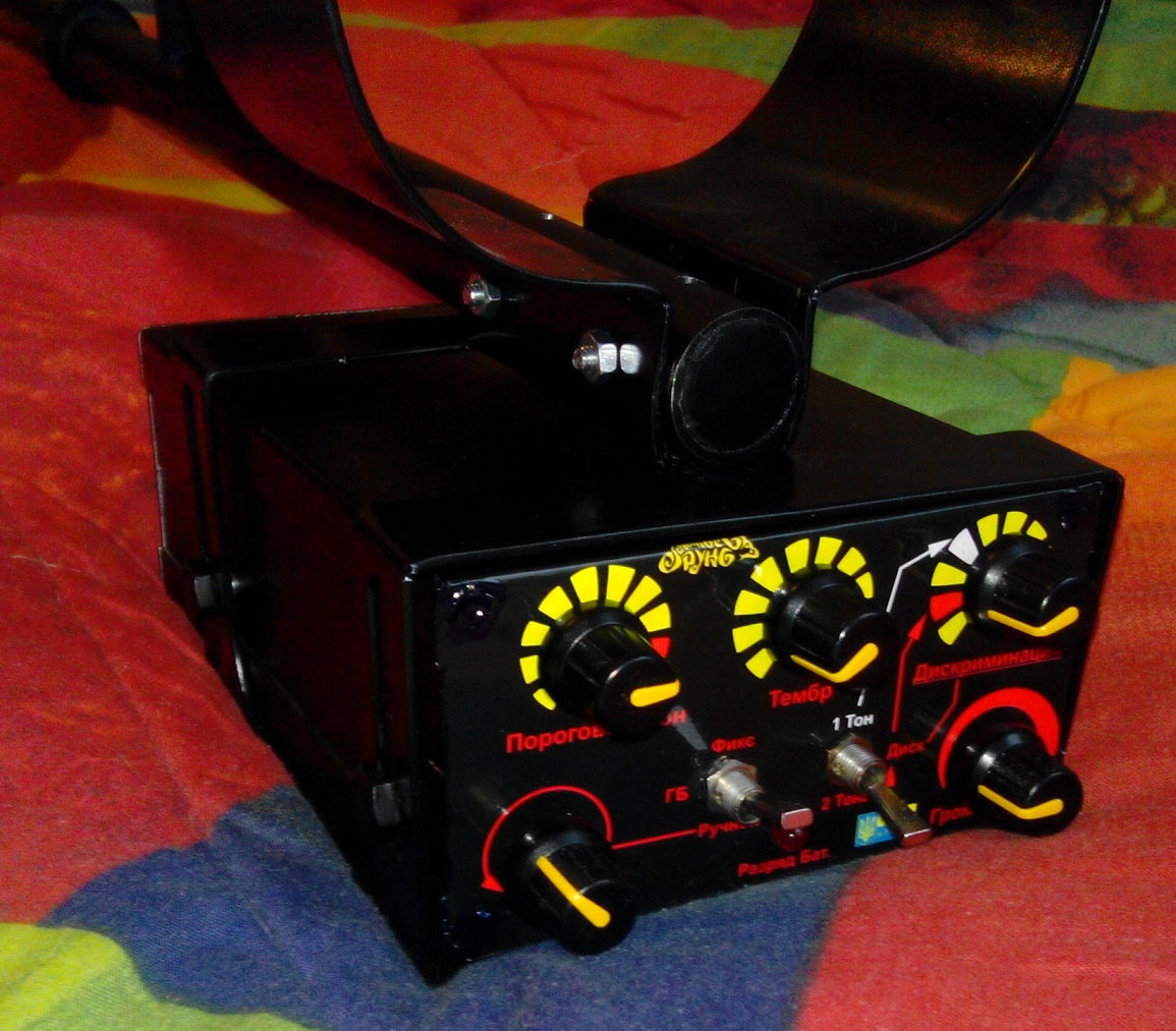

  • I made my device in 2013, so I'm not talking about plagiarism. There is a lot of information on the Internet and video on my device.
    In this form were the first options in 2013.

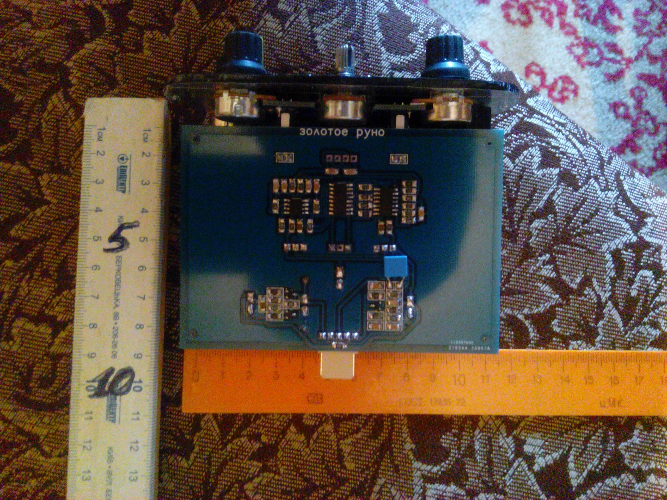

    • Sticker on the front panel, as well as other necessary files for assembly.
      https://drive.google.com/drive/folde...U0?usp=sharing
      Please note that it's stupid to not use photo 3 frequency. On the Mask and Magnum - on other contact areas

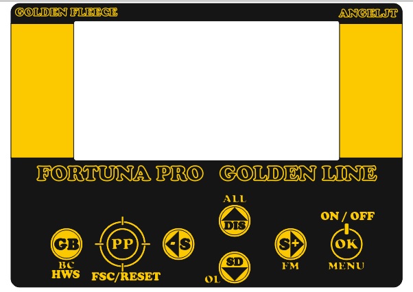

          • Who did not have enough boards - came new, who need to be in a pm.
            A week later, the fees for Fortune Pro FM in the case G1910, I think at the same time will be ready to stickers with punching under the keys.
