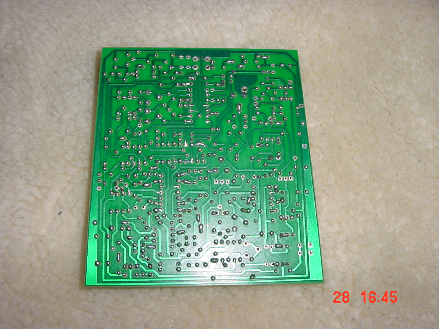

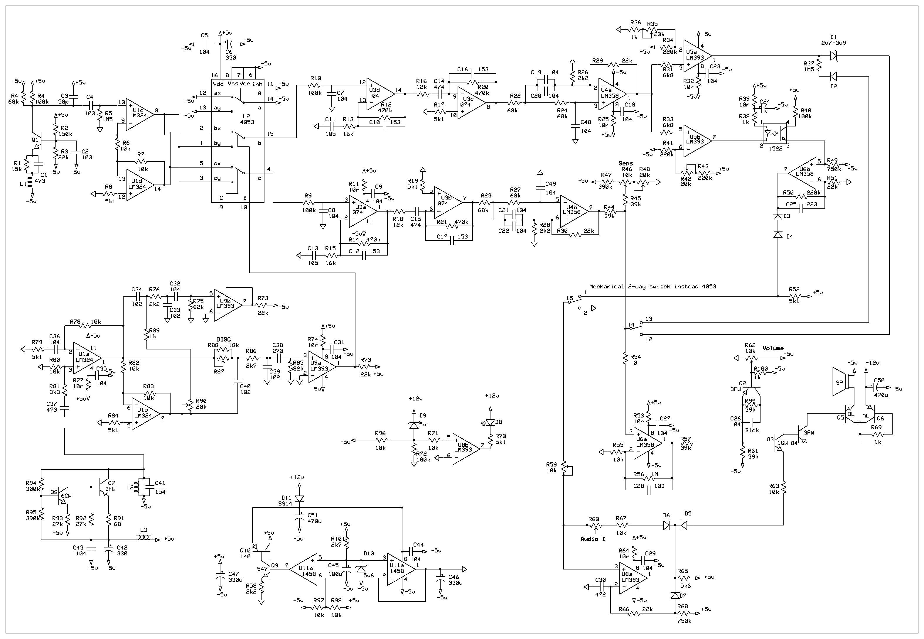

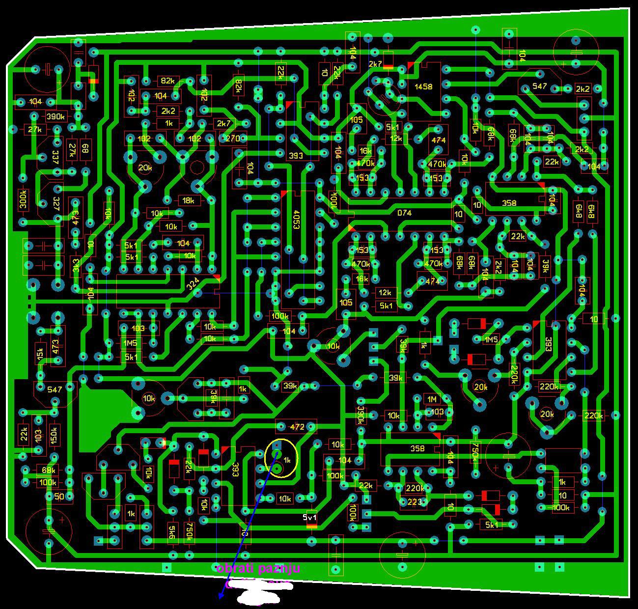

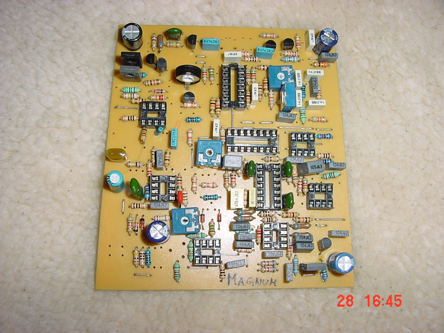

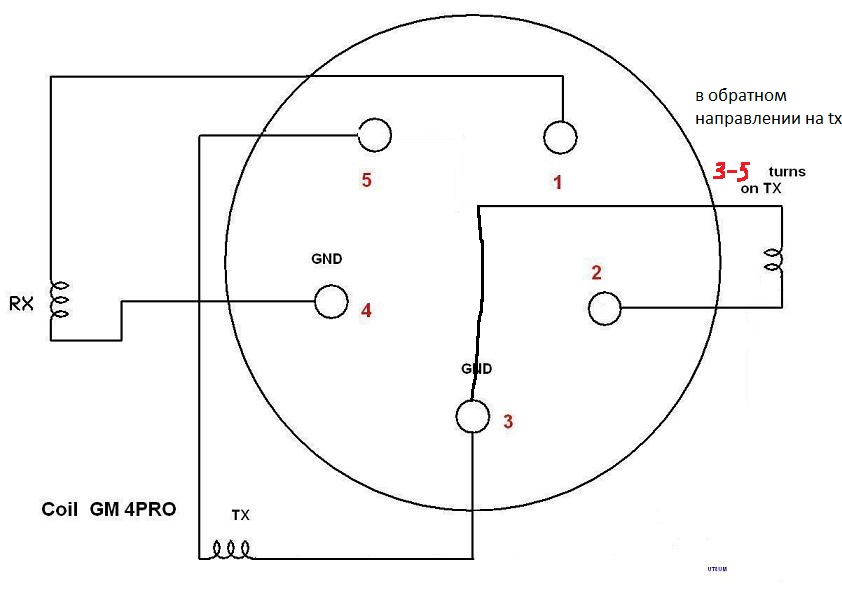

Instruments are there, collected more than one metal detector. TX +220 nf 12.3 kH, RX is nonresonant. I will experiment more ..
