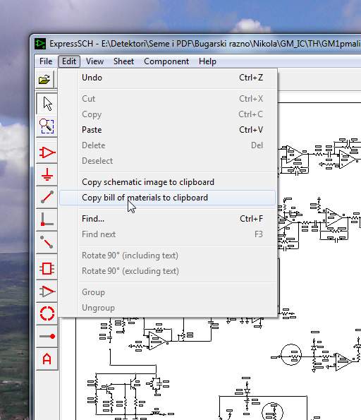

    I greet you all ... is someone can help me with TH version PCB .lay , because in SMD version it is hard to find components.
    TH version works just nice.
    I never made list of components.
    But schematic is correct source, walk through it and make BOM list.
    I think it should be option in ExpressSch... let me see...
    • Yup!
      Here is how:

      and here is list:

            Ivconic,
            Where the program saves this file?
            • Originally posted by Toros View Post
              Ivconic,
              To Clipboard, to RAM memory.
              Next thing you shall do is to Paste it to Notepad or Word or any other text editor.
              And than save it on the disk.
