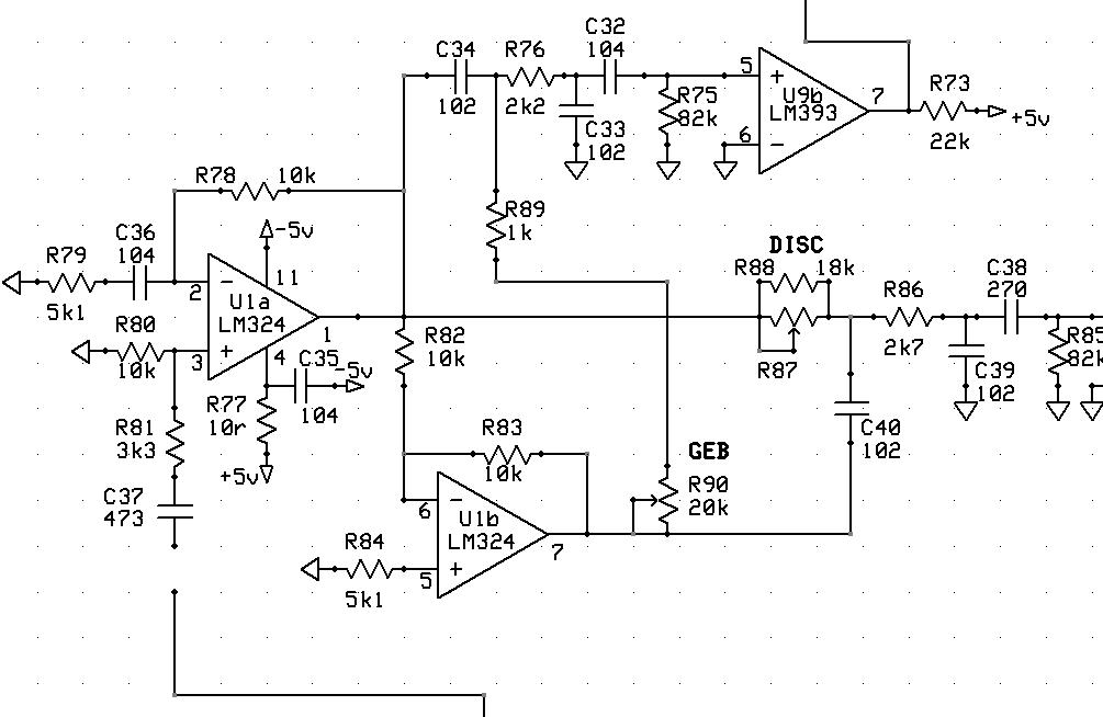

    where is potentiometer ground balance ?
    here there is no potentiometer of ground balance ?
    or I do not see him, then how is tuning out from ground?
      [ATTACH]37743[/ATTACH]
      "...R90= Audio pitch, audio frequency, also can be fixed value, according to your own preference..."
      This is typo! It should be
      "R60= Audio pitch, audio frequency, also can be fixed value, according to your own preference..."
      Here is the GEB pot.

        On some Golden Mask models there is no GEB potentiometer on front panel, on some model there is.
        Generally the schematic i posted applies to all models the same.
        GEB potentiometer can be wired directly to pcb instead R90... OR adapted with R90 and wired in series with it.
        It's up to you to decide what suits you the best.
        You can adjust R90 trimmer to reject hotrocks and minerals and leave it fixed on pcb (so called "automatic ground balance") or
        you can wire multiturn potentiometer on front panel to pcb with wires.
        You can put only one precise multiturn... or you can use trimmer and potentiometer in series too.
        Make your choice, pick any of the combinations, it is up to you and your preferences.

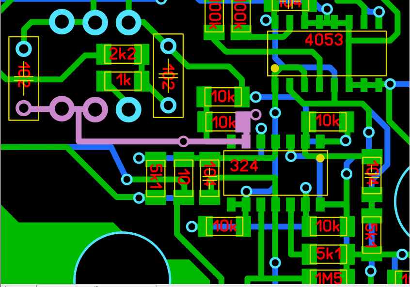

                          • Error ? Mag redu pcb.
                            BG should go to pin7
                            • What is the problem? See where it goes blue path / level C1 / and does it link with C2 level near 10k resistor. Levels C1 and C2 are connected in two places along the path of GB Pot
                              • GB pot. is connected to pin 6 Lm324. should go to pin7.
