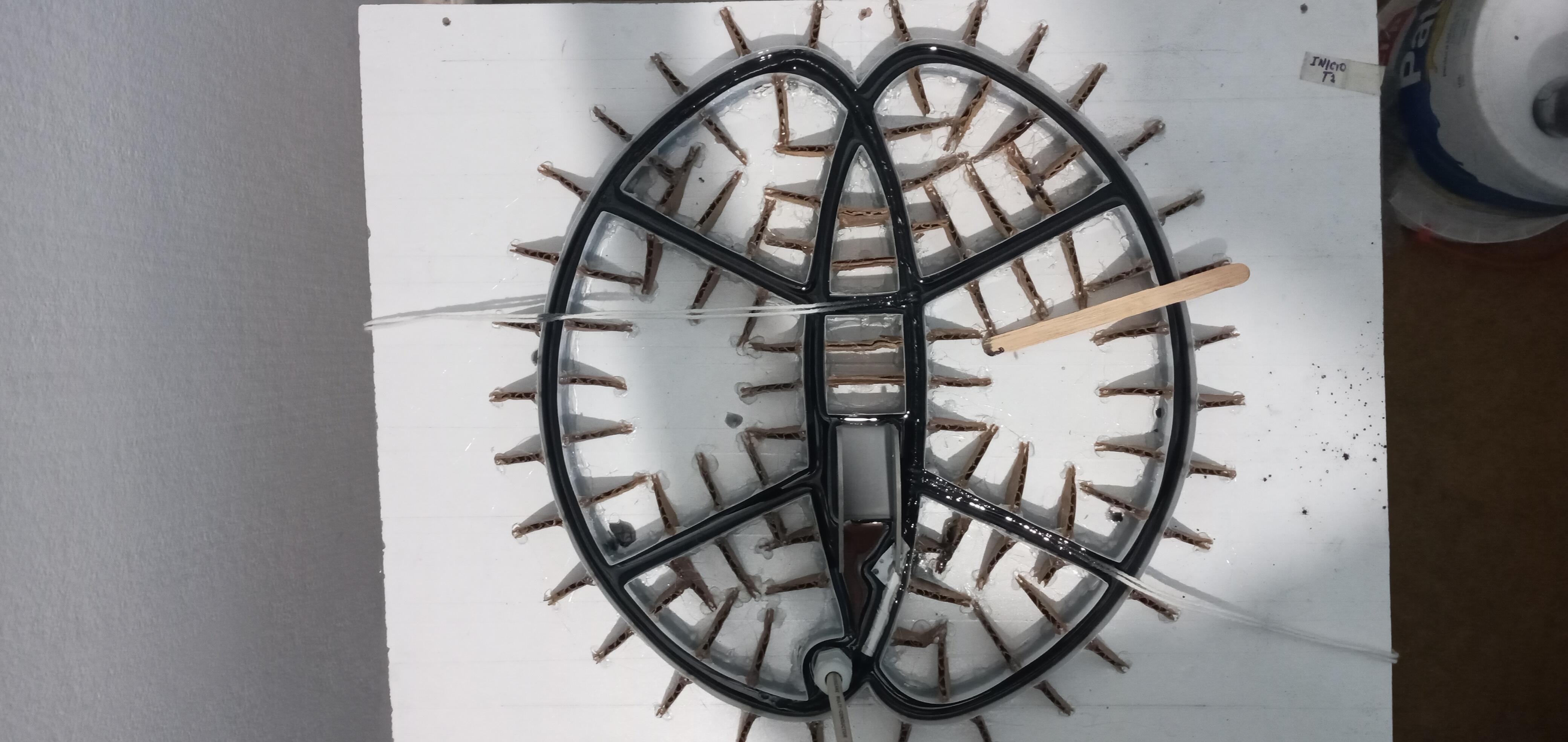

            • Hello friends!

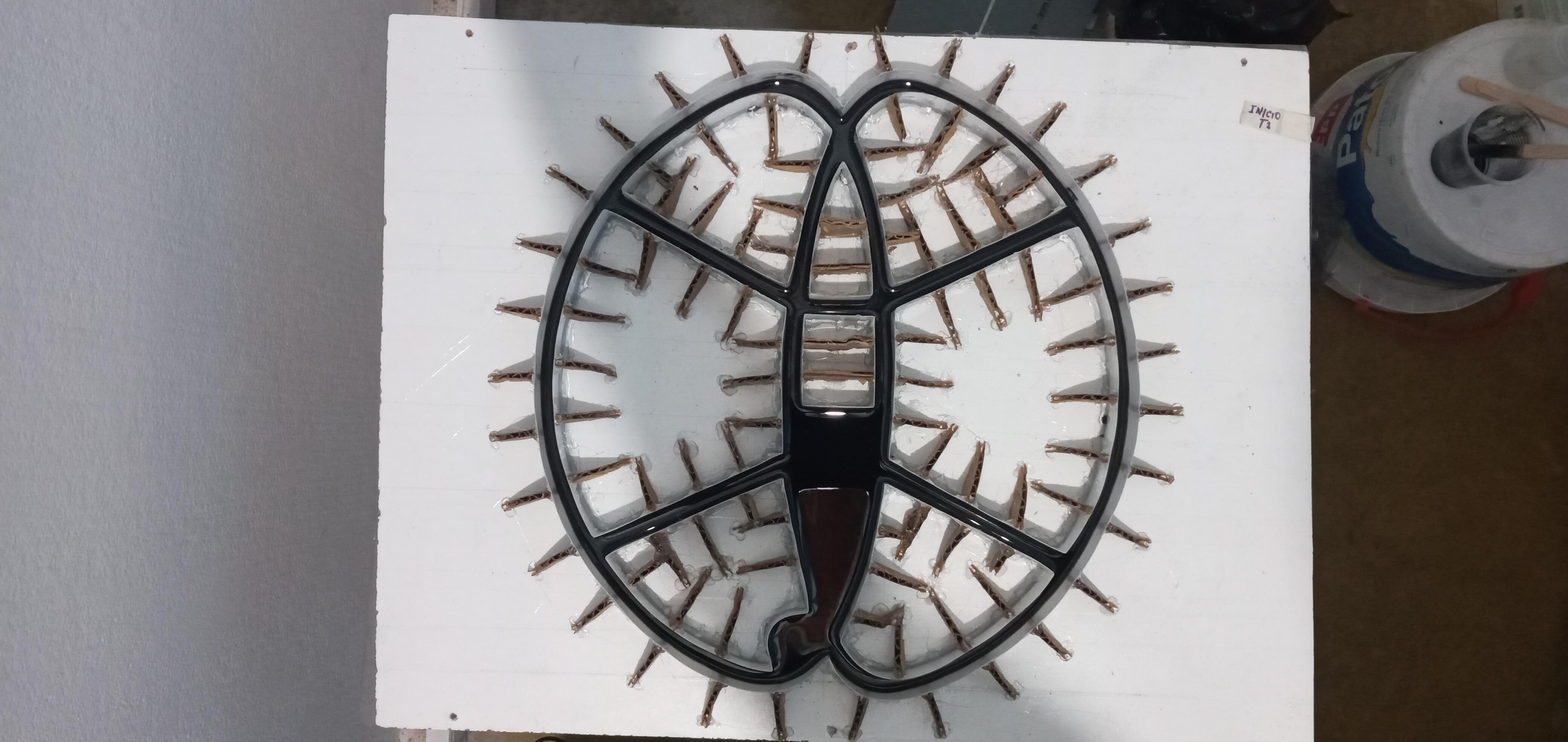

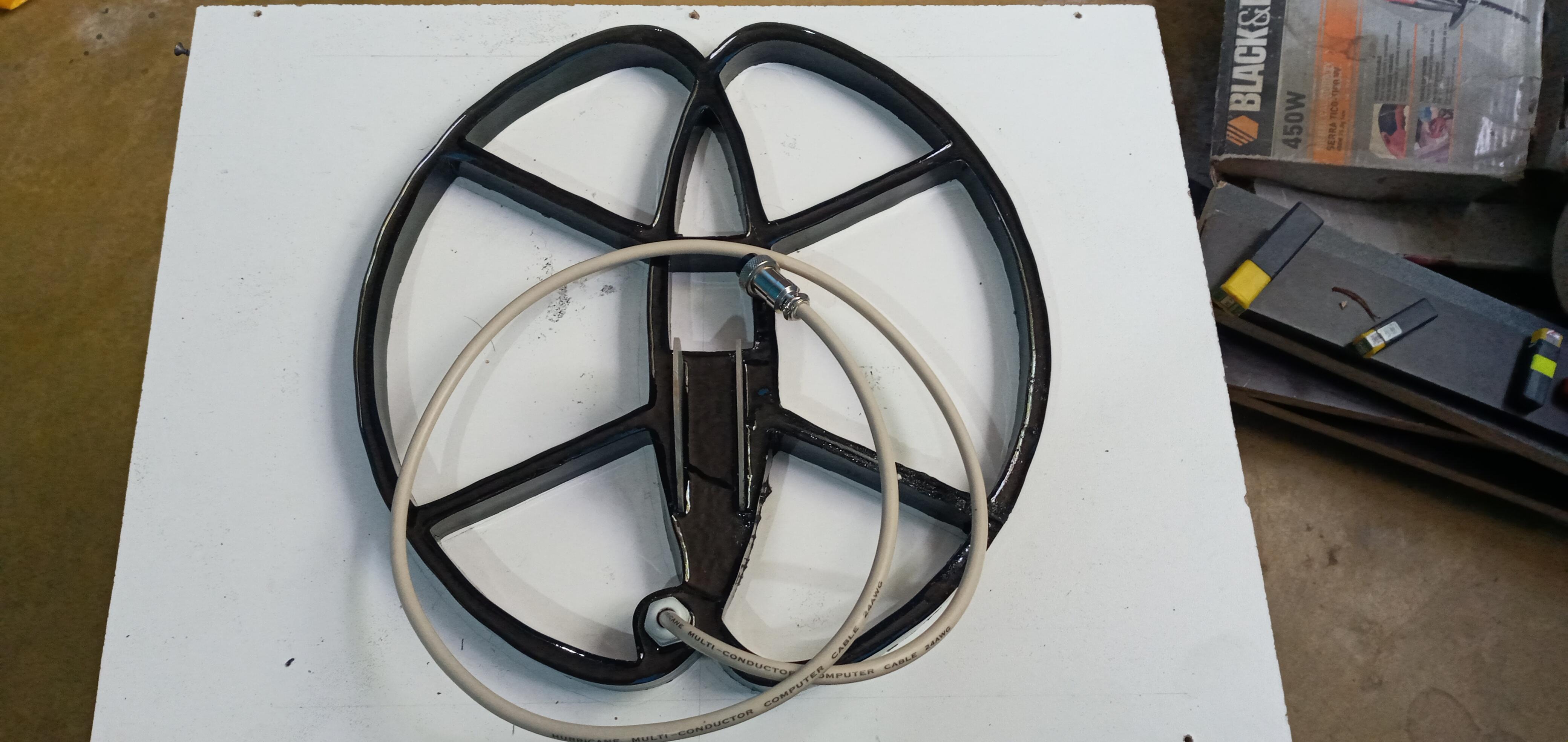

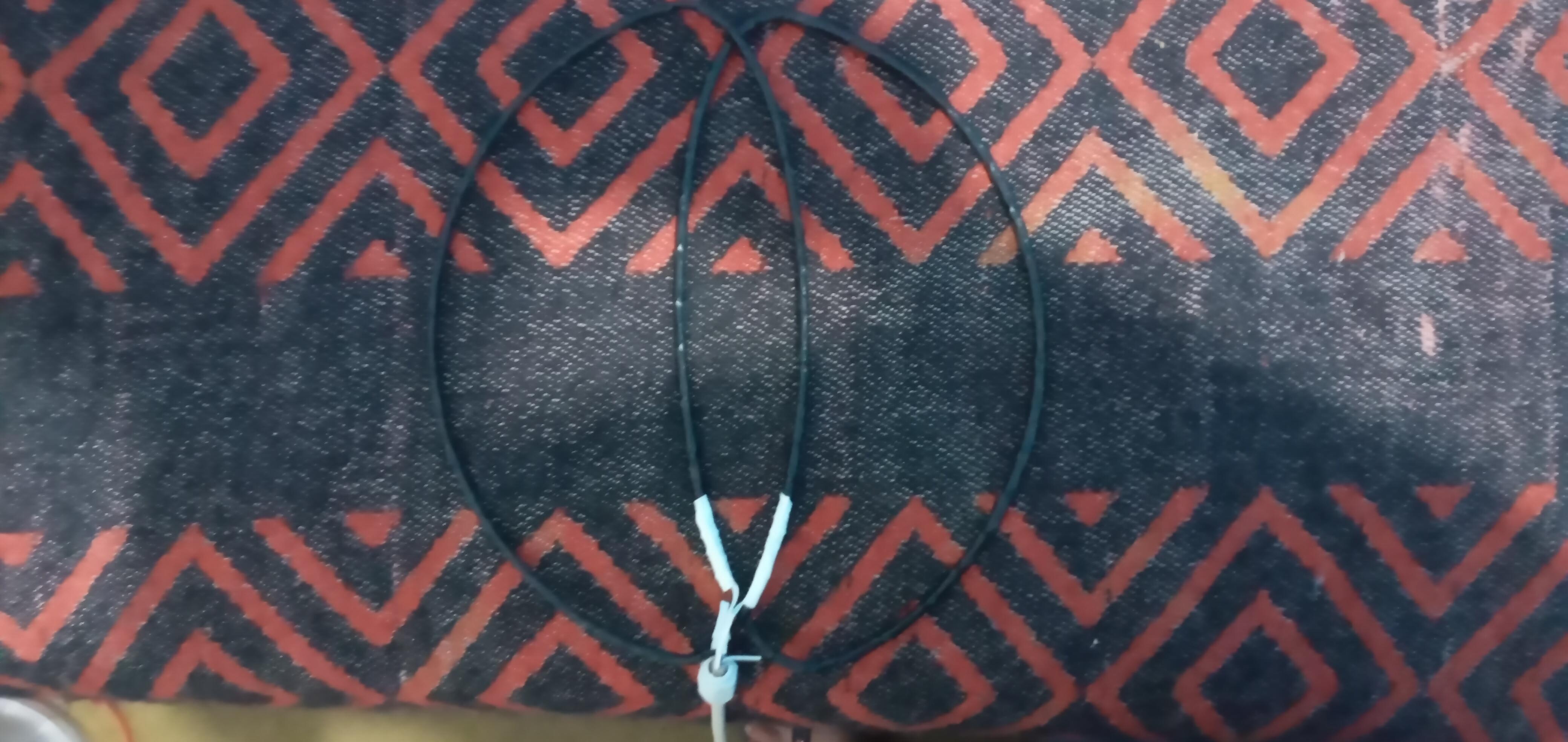

              Here I share some photos of my 12" double D coil.
              I made the entire contour of the motor rewind mica sensor and sealed it with hot silicone. I made the ears out of PVC. I used prepared resin and only had to add a few drops of catalyst to make it harden.
              I hope the photos help someone who wants to do the same.
              • The design of the coil was very beautiful thanks for sharing great photos Ruben2000.

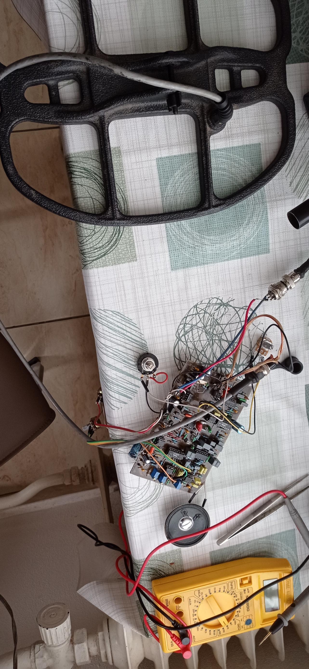

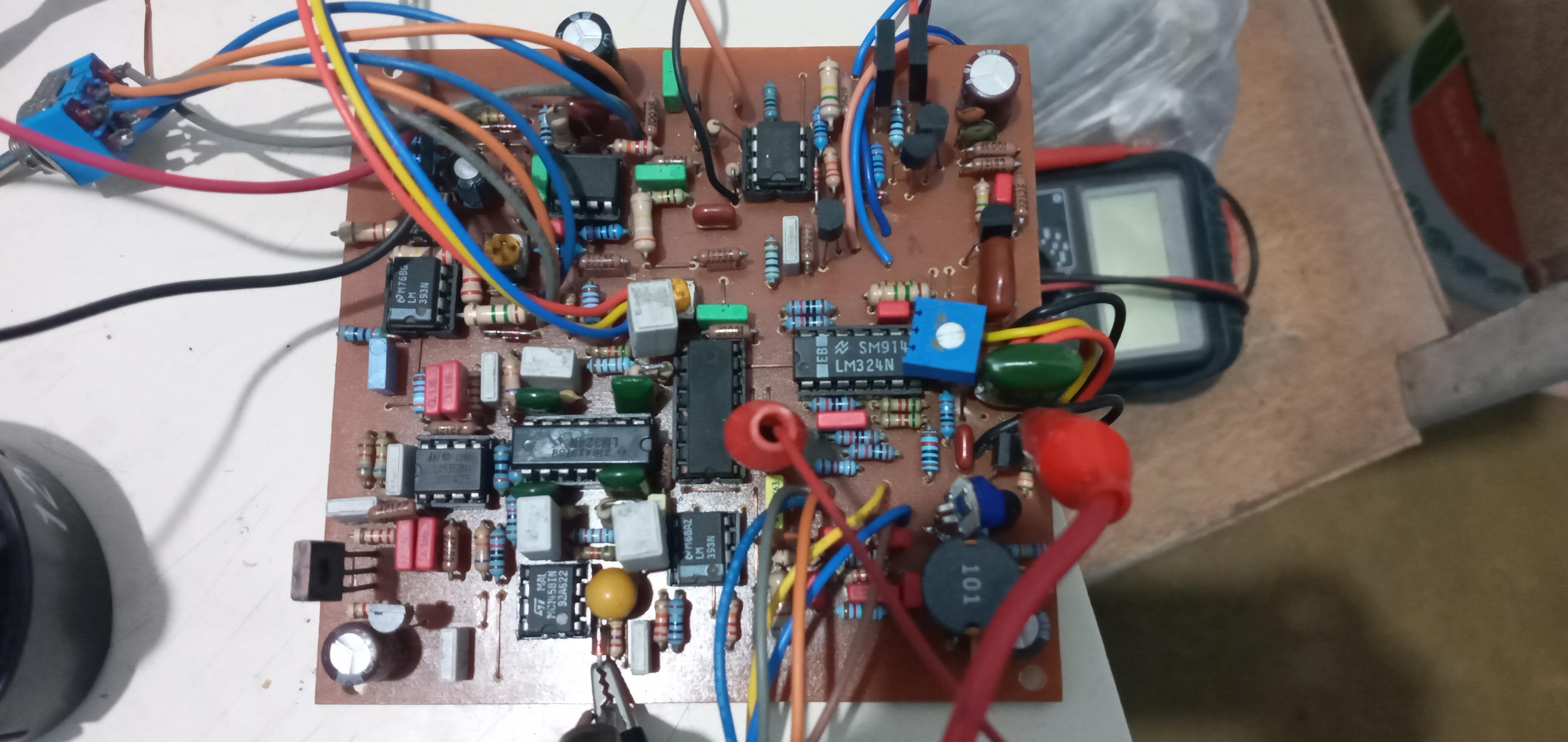

ID:	425695hello friends here again, i finished another gm4 project working at 18khz. the coil is an original factory-made golden mask. air test €1 for 32cm in multitoneClick image for larger version  Name:	IMG_20240627_081843.jpg Views:	0 Size:	436.1 KB ID:	425694

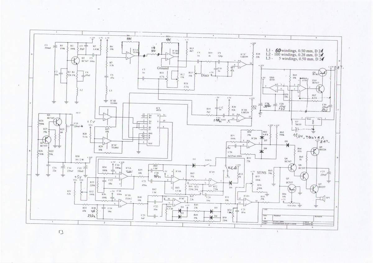

                    • This is not a project, this is a copy-paste. at least try to synthesize another VCO circuit - without an optocoupler. change something - this primitive scheme has too much ground noise. 18 khz is too high a frequency for the requirements of our region - you can go down to 13-14 khz without any problem. I have seen garage versions which in air tests are top of the tops, but on the ground they are a complete travesty . the probe is made in montana - are you from that region?
                      • Riss, sorry, it's my private project that I do for myself, not for the public, in my spare time. I got an original coil at a second hand for a ridiculous price, so I tried to create an electronic part for it according to a proven wiring diagram. currently there is a converted oscillator from tesoro cibola to 14khz
                        • Originally posted by Ruben2000 View Post
                          Hello friends!!
                          I made the 12 inch double D coils with the following measurements.
                          TX1= 36 turns of 0.45 (25AWG), 742uH, 2.9Ohm.
                          TX2= 1 turn of 0.45(25AWG).
                          RX= 92 turns of 0.25(30AWG), 5.471mH, 22.6Ohm.
                          TX1= 35 turns of 0.50
                          TX2= 5 turn of 0.50
                          RX= 100 turns of 0.28
                          - OK
                          • Comment
                            • Originally posted by pechkata View Post
                              TX2= 5 turn of 0.50
                              - OK
