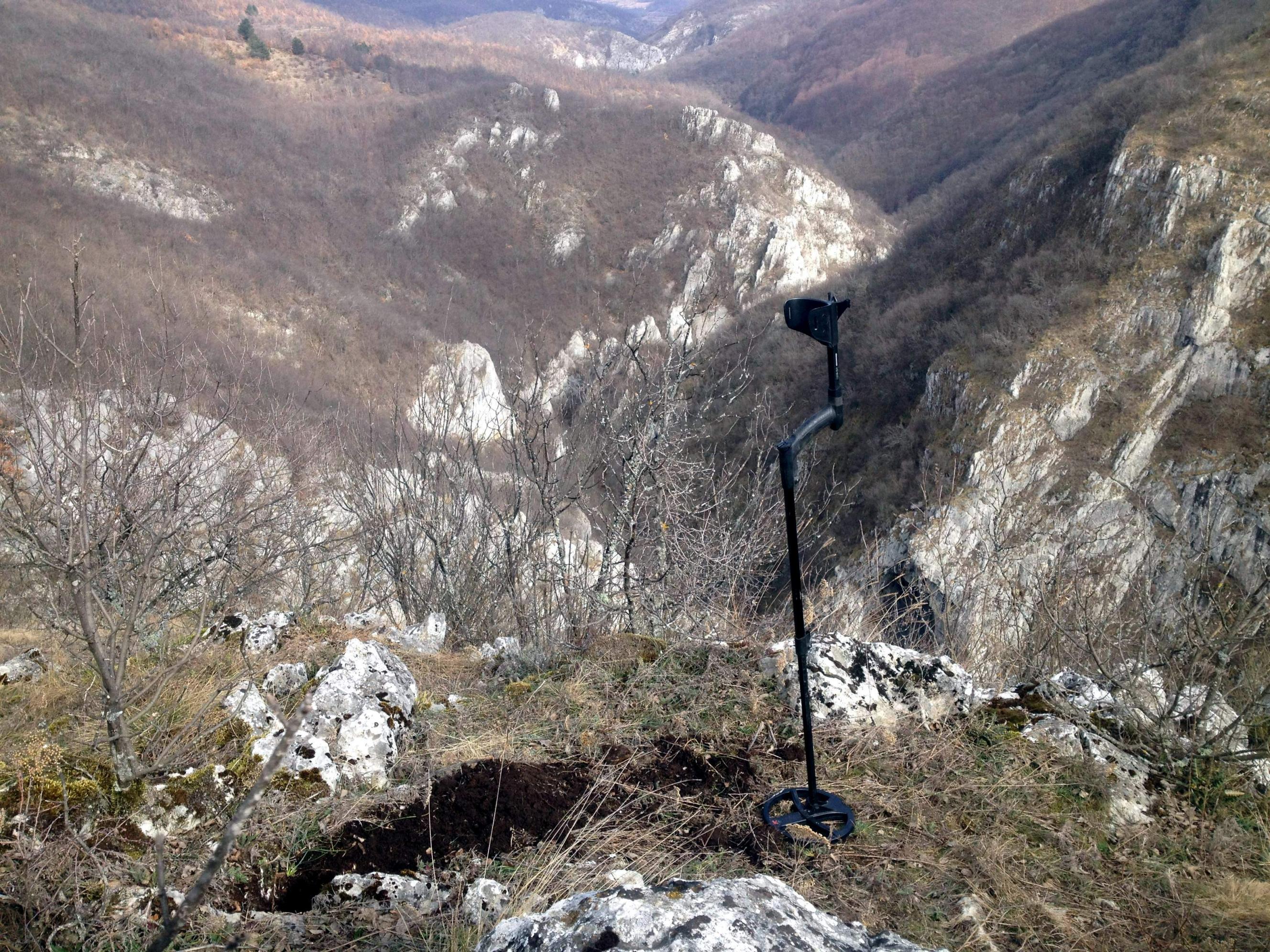

I mentioned; tough. I can't explain it other than to use Deus parameters (too long only with that detector). GB goes from 84 to 87 most of the time.Originally posted by Nexus View PostHell man. Goat riding a goat. That's really new to me
What is the soil like on those hills?
Not only that, there are lot of spots where Deus produces smooth "colored" audio without VDI, doubling the sound like "deeeh daaah", indicating strong hotrock.
So it is very tough to work in such conditions. Despite all; Deus is still most successful among several other models that i have tried there.
It is sort of hill, it was the fortress once on its peak, made of stone and ceramics. Than it probably burned down (lot of melted metal particles around).
From the peak down to 100m bellow there are iron oxide, melted chunks and particles, pieces of ceramics and occasional good targets here and there.
Piles of stone and mixed material, covered with small bushes.
It was Byzantine and later Serbian medieval fortress. Still hiding lot of precious finds. But those finds are hard to reach, tough targets!
Large coil would probably do the job referring the depths, but it can not get close on such places, so, smaller coil is only way.
Yet; with smaller coil you can't get enough depth.
I am sure that Minelab GPX series will be able to find many targets more there, but i can't imagine how would be possible to carry and handle such detector there at all.
Puzzled situation! Tough!

That's what i actually do by now. But it is tedious and slow job, the day on such site is very short.Originally posted by Nexus View PostI suppose cutting the bush and digging is the answer. What else really?
But recent nice finds that i had there are pushing me to continue.
Such site is perfect for real testing the detectors and see the real truth about md technology and related facts.
Deus is doing nice job there, but for the record and to keep being fair; it has own limits.
It is reaching down to some depths and that's all. Bellow that level Deus can't do much.
Like i said; Minelab GP&GPX will probably do more than that.
Everything else from detectors that i know; are pretty much useless there.
