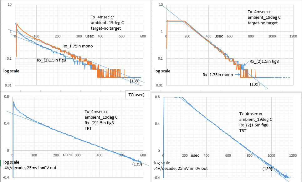

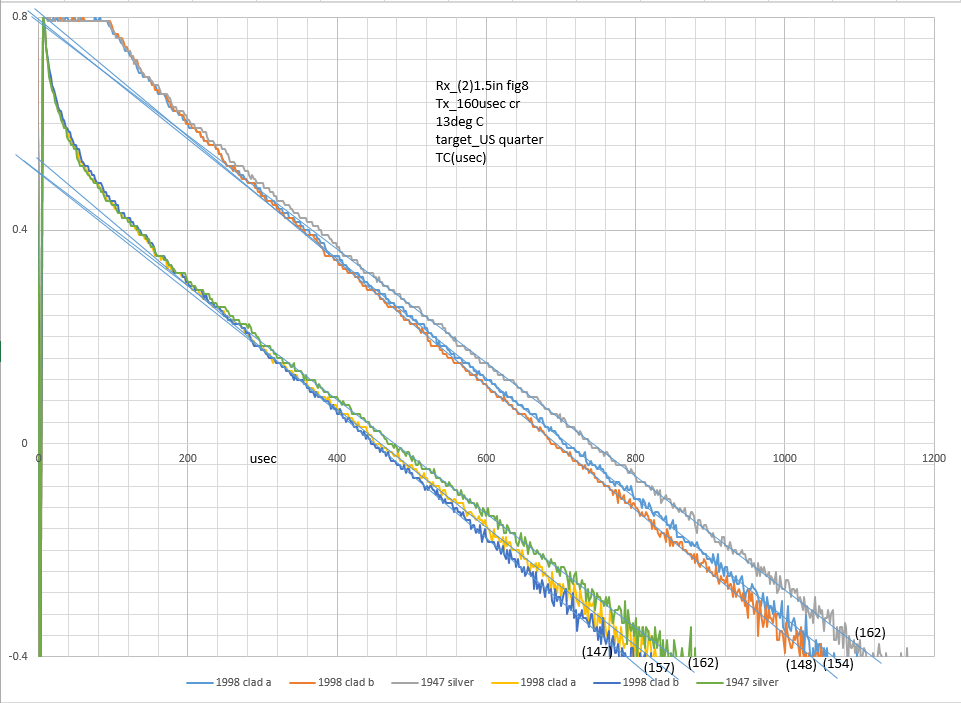

  • Some tests with TRT and target-no target charting, fig8 Rx and mono. Added a 139usec decay line to charts to compare actual decay with. Differential amplifier with fig8 Rx(Tx surrounds Rx), inverted input amplifier with mono (Rx, Tx).
      Some observations. Mono coil and fig8 coil show similar decay first 200usec, two left charts. Bottom left, straight line decay after 180usec. Bottom right doesn't show straight line decay until after 300usec after coming out of over scale(target close to coil). Wondered if it was do to test instrument, top right shows the same with both instruments. Thinking it's real target decay.

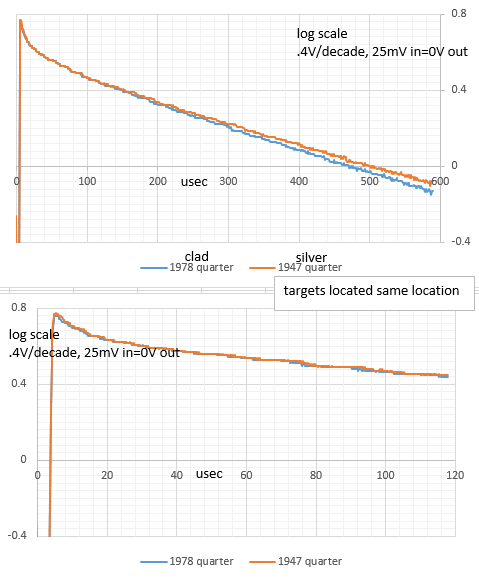

      • Shouldn't you be using a proper silver 25c coin, not a clad one? It seem that it would be a worthwhile comparison, anyway, having data for both. There's quite a pronounced difference in conductivity between the (copper) core and the (CuNi) cladding. It may show up what is a target characteristic, what is test-jig related.
        • Originally posted by Skippy View Post
          Quarters look the same up to 120usec. Silver quarter, slower decay after 150usec.
          4msec Tx cr

            Added two lines to chart posted above through 100 and 200us. Got a time constant closer to yours. Before I had my TRT I did what you did plus. Two recordings, no target and target. Subtracted no target from target recording(cancels no target offset in the beginning that I couldn't zero out with a mono coil) and charted difference linear-log with Excel. I'll try the old way with the quarter hopefully today. Didn't get straight line decay until closer to 200us delay with my TRT, included chart. Do you have a way to subtract and chart two recordings, target and no target? Wonder if a 600us Tx with your tester(first sample at 200us) wouldn't give a time constant closer to the 137us I got.
            10.4us for the nickel looks good, wonder why your other method gives a different answer.

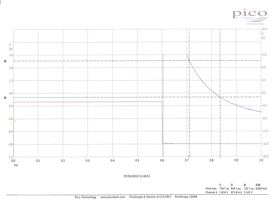

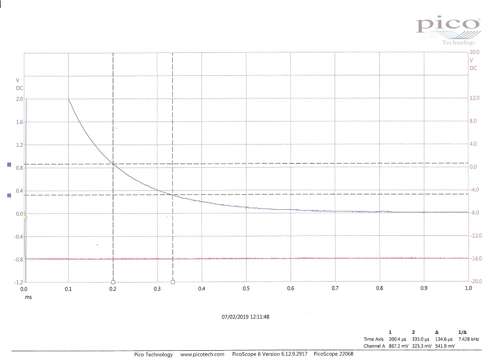

            First I plotted with a TX width of 300uS and a delay of 100uS to start of plot which gave a TC of 122uS. Increasing the TX width in 100uS steps up to 600uS gave an improvement of TC to 123uS. Increasing TX width beyond this point gave the same TC reading. For a clad quarter, 600uS TX width is the optimum. Using this width and increasing the delay to 200uS for the start point gives a TC of 134.6uS, which is close to your figure.
            The first plot is triggered from the start of the TX (red trace) to confirm the TX width. Click image for larger version

            The second plot is triggered from TX end, as have previous plots of this type. Click image for larger version

            In the first plot, even though the TX pulse was long enough to fully saturate the coin (late time at turn on), waiting until 200uS after turn off is necessary to observe the single invariant true TC. of over 134uS.
            To compensate for any variations in the zero base line, the target is removed after each measurement and a button is pressed to auto-zero the final dc amplifier stage. Obviously this does not apply to the scope'd plots I am currently doing.

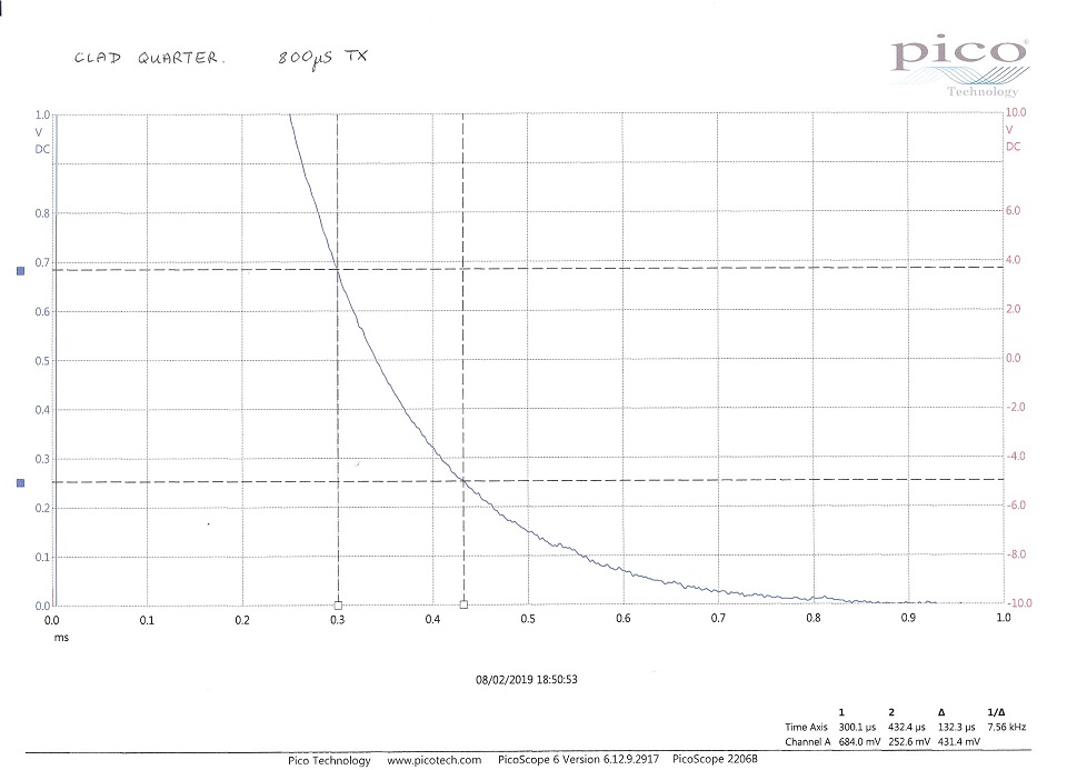

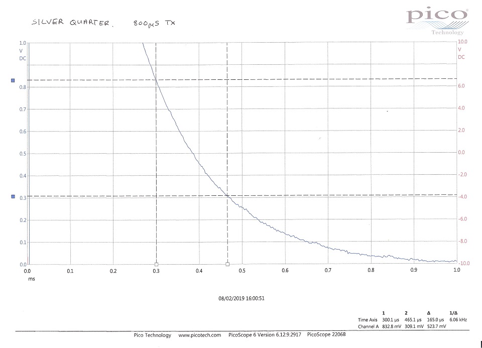

              I have a 1964 silver quarter which I am told is 90% silver and 10% copper. IACS measures 88%. It requires a TX width of 800uS to fully charge and at 200uS start point the TC is 165uS. Increasing to 400uS start point the TC is 183uS.
              Also, by the same method, I measured a 4.4gm gold nugget from the Victorian goldfields, Australia. The TC is 23.8uS.
              Eric.

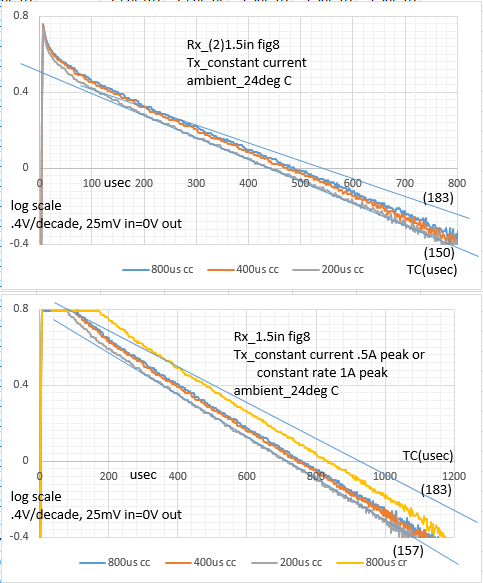

                Thanks for the testing. Something to compare against. Thought we were getting similar results. Wasn't getting near 183us with my silver quarter. Have been using constant rate instead of constant current. Some tests with a silver quarter constant current and constant rate. With amplifier not over scaling(top chart)all decays about 150us TC after 180us delay. With coin closer amplifier over scales, TC increased to 157usec all traces after 350usec delay. Constant current, constant rate and Tx time didn't seem to have much effect on time constant after a certain delay time.
                  Changed the 150us slope on top chart to 157us same as bottom chart. Looked good, drawing straight line decay after two target time constants might be best. Thinking decay the same on both charts, just don't see it out to 300us on top chart with 1/6 the amplitude? Want to check calibration again today.

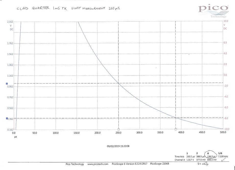

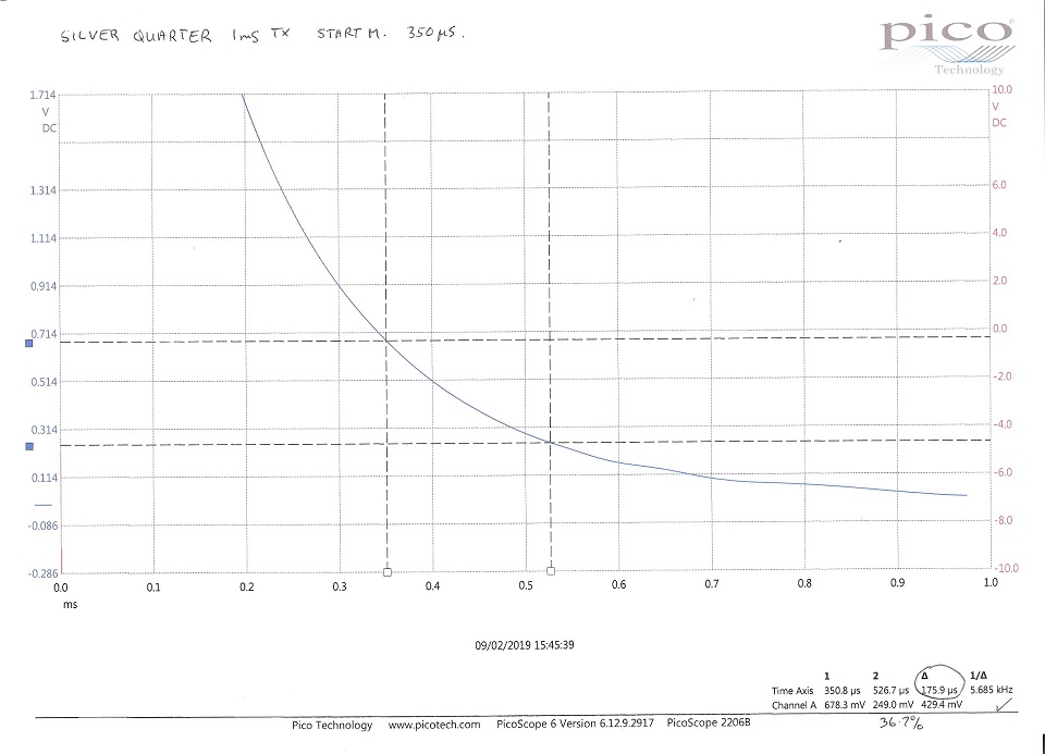

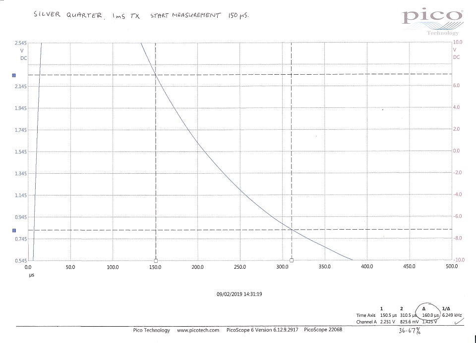

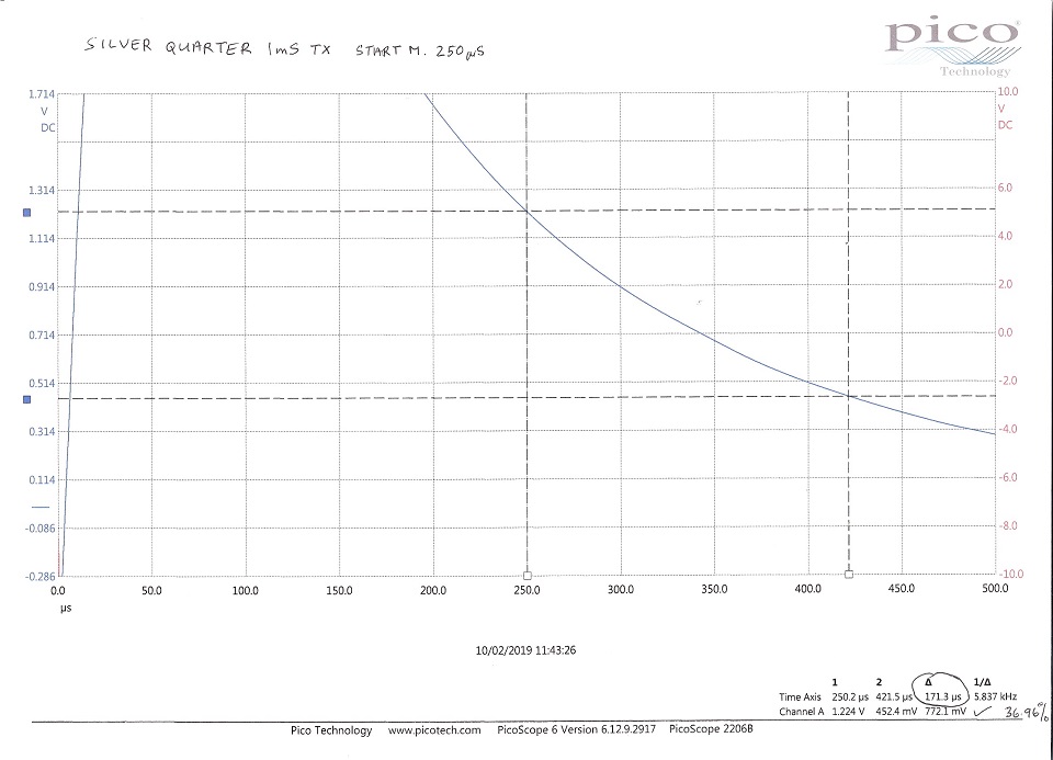

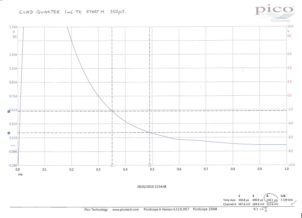

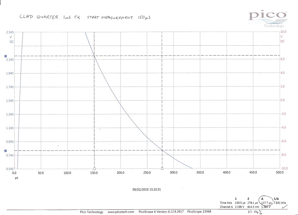

                          Hi Green, I have further optimised my measurements by expanding the portion of the waveform to be measured as far as possible, and setting the digital filtering to reduce noise as much as I can. I used a long 1mS TX time for all measurements, so that should not be an issue. My start points are 150, 250, and 350uS, These are not as you requested as I had already done them before I saw your last post. I did not go to later starts than 350uS as noise will cause errors. You can see a slight ripple in the tail after the measuring window of the 350uS plots. I tried to get as close as possible to the 37% of the start amplitude, which is considerably better than before, due to the improved scaling. I doubt there is anything more I can do to improve things on these targets.
                          The results for the clad quarter for TC are 127.7uS, 136.3uS, 140.1uS for the ascending order of start points. For the silver quarter the results are 160.0uS, 171.3uS, and 175.9uS.
                          Clad plots Click image for larger version

                          Silver plots Click image for larger version
ID:	353330 Click image for larger version
ID:	353331 Click image for larger version
                          Eric.

                            Thanks, My question on calculating tau at 50 or 100us times between samples relates to sampling integrator out instead of amplifier out. The integrator gives some filtering that should help. Was wondering if it could be a better way for measuring tau after two time constants. Was wondering what the formula was to calculate tau from two samples without trial and error.
                            Your decay looks real smooth. Is the Pico scope smoothing the decay? Read your reply again, missed the digital filtering the first time?

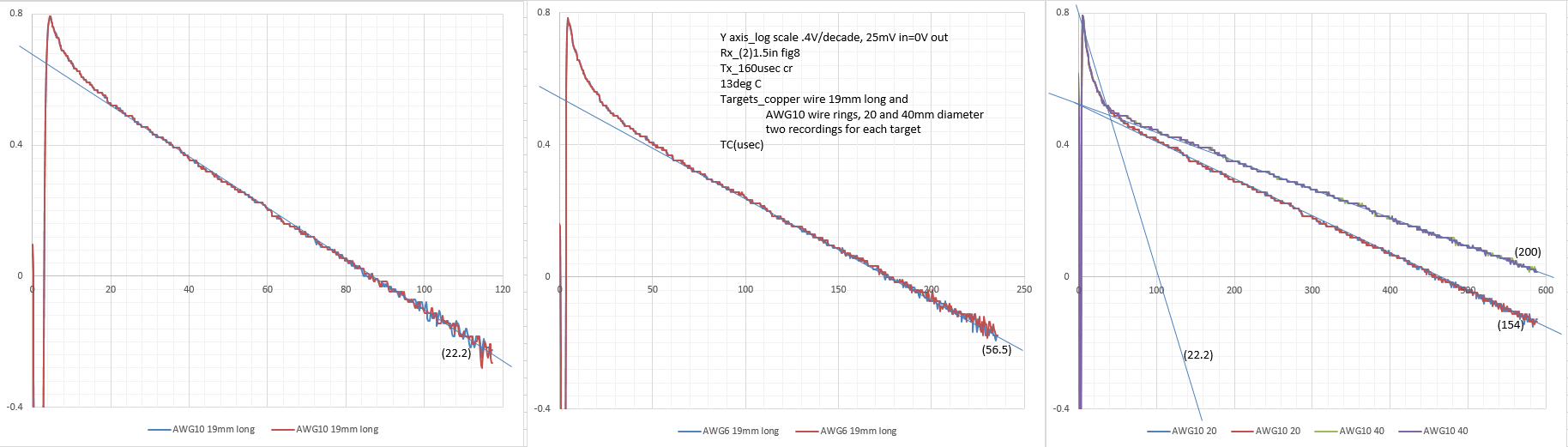

                              Your plots of the 19mm straight wire length and the loops of the same gauge wire appear to show the same initial drop, which I would expect. There doesn't seem to be any evidence of a 'pause' at 22usec rate for any time, before the dominant full loop decay starts.
