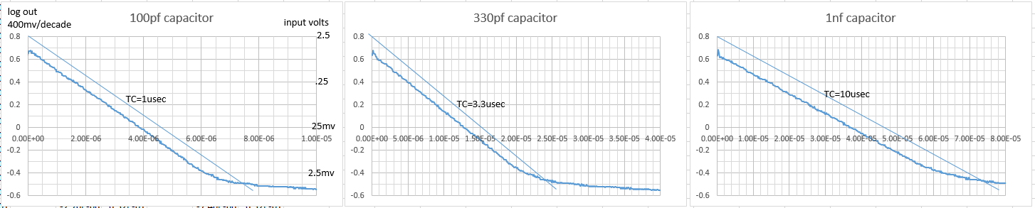

    My thought for checking decay slope. The dashed line is the calculated slope. The input on the LOG114 is 10k instead of 5k in the picture. Use 100p capacitor for 1usec TC, 330p for 3.3usec TC and 1n for 10usec TC.

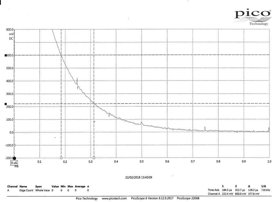

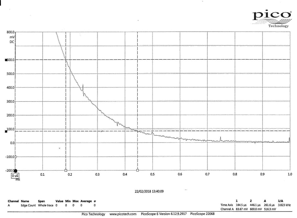

      I'm now using the Picoscope 2206B for object tests but there is still a lot to learn about it's capabilities. I haven't yet got a log function on the Y channel yet, but I am building my own to go between the test rig and the scope.
      The plot here shows the bottom end of the decay of a Silver Dollar where the signal disappears into the noise at 0.9mS. This is with a TX width of 1.0mS. I took a point where the curve reached 600mV as the starting voltage, then took 37% of that as the next point of 222mV which related to 128uS; which in turn is 1TC. The next point to measure is when the amplitude is 14% which is measured in the next graph at 83.67mV and 261uS. 261/2 = 130.5uS which is close enough to 128uS for the present purpose. Graph 1 gives the period of of 1TC and graph 2 the period of 2TC.
      The top of the graph that goes off scale extends to 3.5V, which is the saturation level of the two stage preamp which consists of a NE3354 x10 gain, then a NE5532 giving plus and minus outputs with a gain of x49.
      Interestingly, if I substitute a Nickel with a copper core, there is no measurable shift in TC from that of the silver one. When doing decay plots recently on a Bitscope it appeared that there was a difference. I will have to check that, as maybe the differences are at earlier times due to 'skin effect' of the nickel plating.
      Eric.
        Log amp circuits that I have seen have a much lower input resistor that you have. 100 - 500 ohms is common.

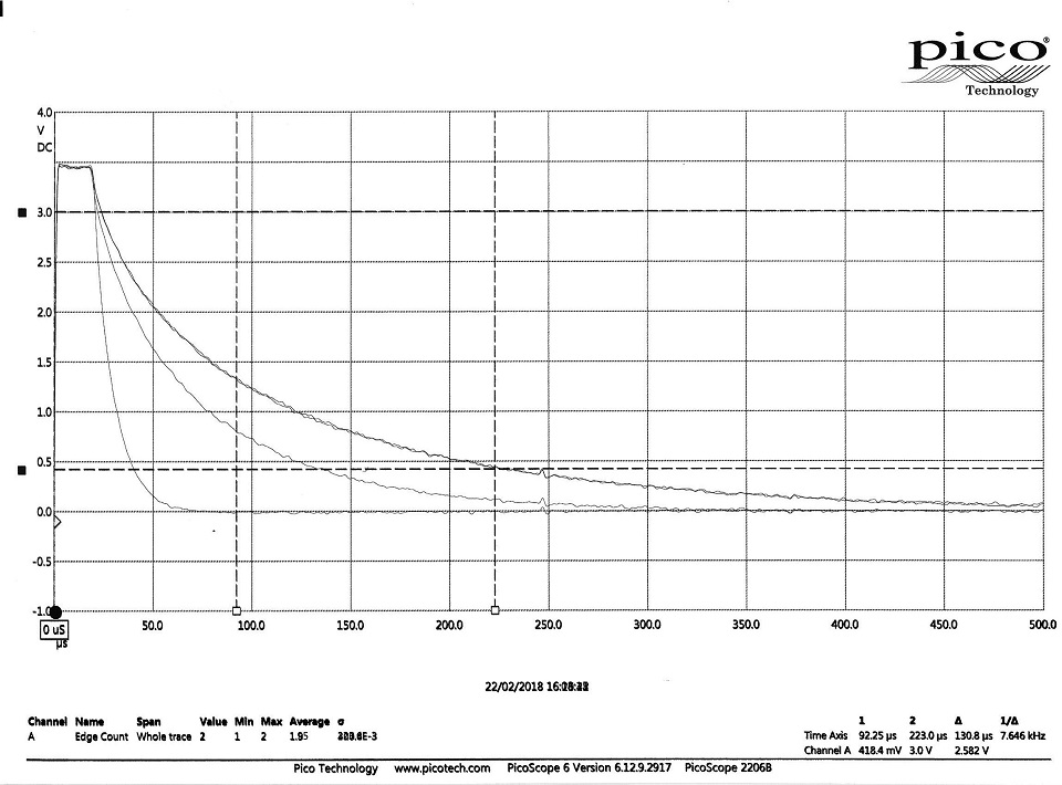

          I just thought I would run a plot for the silver quarter and clad quarter and here is the result. The top trace is for the two quarters and there is little difference. The midde trace for comparison is a US copper penny. The third trace is a US Cent.
          Ignore the rulers and figures as I did not cancel them, and the graph is 500uS full scale rather than 1000uS in the previous ones. The quarters have not yet reached zero in this plot.

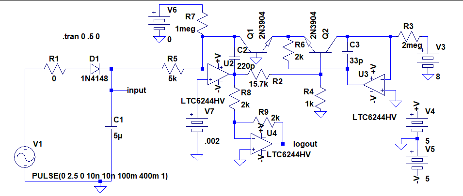

            Capacitor discharge into LOG114. Use log cal.png for reference. V1_coil driver command, swings +-2.5 volts from common. R1_10k. D1_1N4148. C1_100p, 330p or 1n. R5_10k. LOG114 replaces spice log amp. Probably would be better if R1 was a lower resistance.
            Eric.
            LOG114 is rated for 1ma input current, so I could lower the input resistor from 10k to 2.5k.
            I think it's either speed or the no target signal being not quite zero early in the decay like you suggested. Looks like speed isn't the problem.

              You should run your LOG114 at higher input currents, I'm guessing if you exceed 1 mA, you're not harming anything, you're just not getting proper performance, such as non-log behaviour, thermal issues, voltages hitting the power rail limits.
              Regarding the discrete transistor / opamp model, I presume the two bias voltages V3 and V6 are supposed to 'match' each other, in terms of the current flowing into the two virtual grounds. Is this the case? Are they set at a 2: 1 ratio, such as V3 = 2 Volt, V6 = 1 Volt ? If so, you can tweek one of the voltages to adjust the 'zero input' behaviour. Changing V3 from 2V to 2.05V or 1.95V, for example.
              Another experiment would be to change the two transistors to type BC337 (from 2N3904). These are higher-current devices with a lower rbb base resistance, and they may be closer to the ideal.

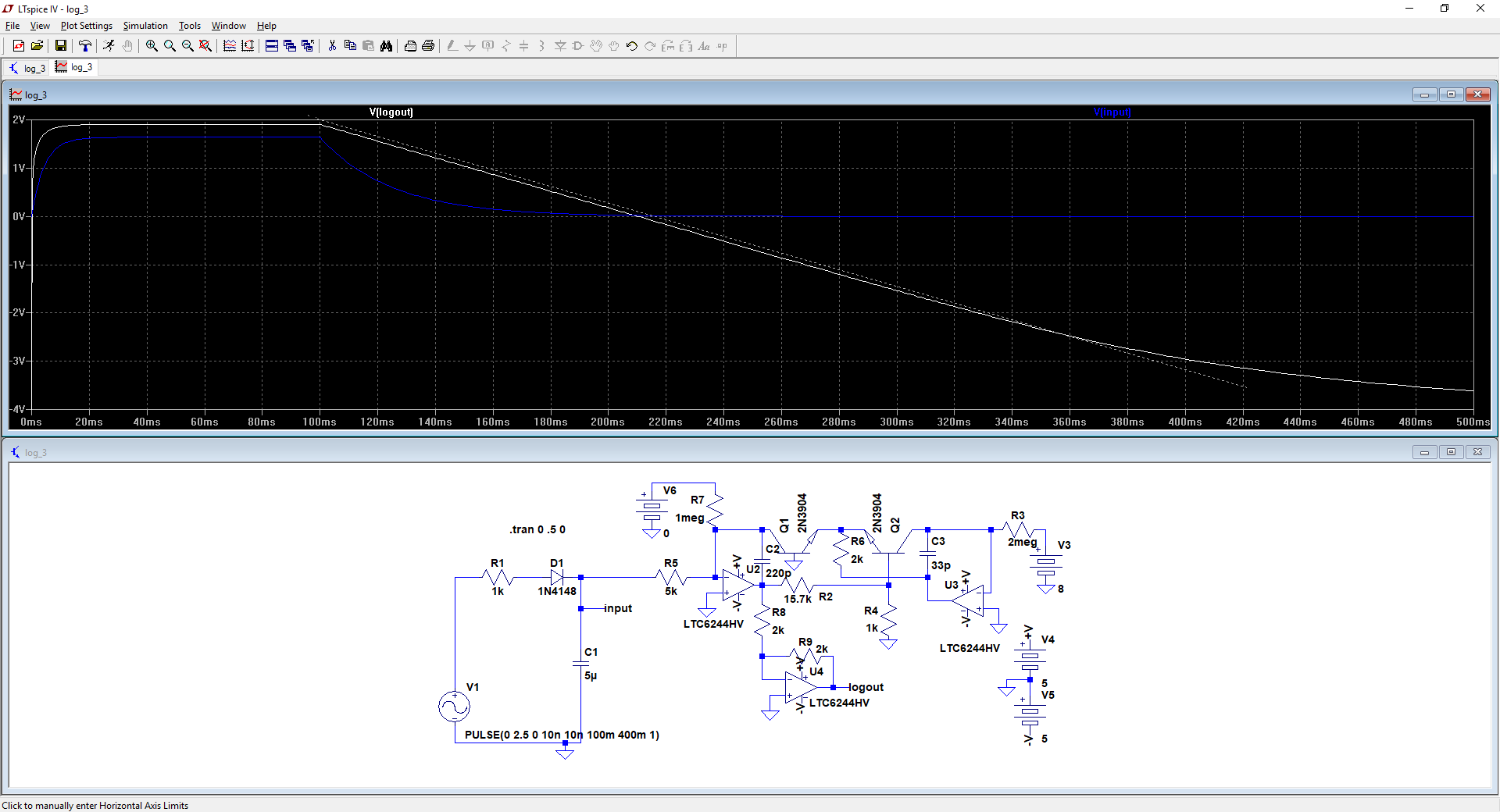

                    Yes, log-cal is what I'm referring to. I'm trying to work out a solution to the output voltage error at low input voltages (that causes the deviation from straight-line at 330msec onwards). You don't think it's a slow-response speed issue, so that leaves input offset error. I'm attempting to work out what you can adjust in the circuit to compensate for this. Fine-tuning V3 to vary the imbalance between the collector currents of the two transistors should allow the log output to be adjusted so it's a true straight-line.

                      Been playing with the problem. Added .002v offset to +input of log amplifier(log_3 and4.zip). Adjusting V6 straightens decay slope, both examples. Problem is, not the same setting for each example. Tried capacitor discharge into input resistor for checking response so I didn't have to worry about amplifier offset between capacitor and log amplifier. The input voltage is about 200uv at 330usec. Not seeing a good way to test decay response.

                          Yeah, it's a bit of a problem using the log-amp's input resistor as your capacitor discharge resistor, because it's a VIRTUAL ground, not the actual ground on the other end of the capacitor, so it's not going to fall to zero.
                          One possible alternative is to have a real discharge resistor across the cap, in addition to the resistor to the logamp input. If the discharge R was, say, 0.1 x the logamp input R, then it would dominate. Example Rdischarge = 556 Ohms, Rinput = 5K, gives an equivalent discharge R = 500 Ohms, just make the C value 10 times larger to compensate.

                            Tried it with log_3.zip. Disconnect signal input to R5 and connect R5 to common. Set V7 to .002volts. Setting V6 to .402volts adjusted offset when I tried. Remove common and connect R5 input back to signal. Looks like it doesn't cancel offset with capacitor discharge, changed 5u to 50u and added 500 ohms across capacitor.

                                Do you have LT spice? When I double click the asc. file it opens the schematic, then run opens scope screen.
