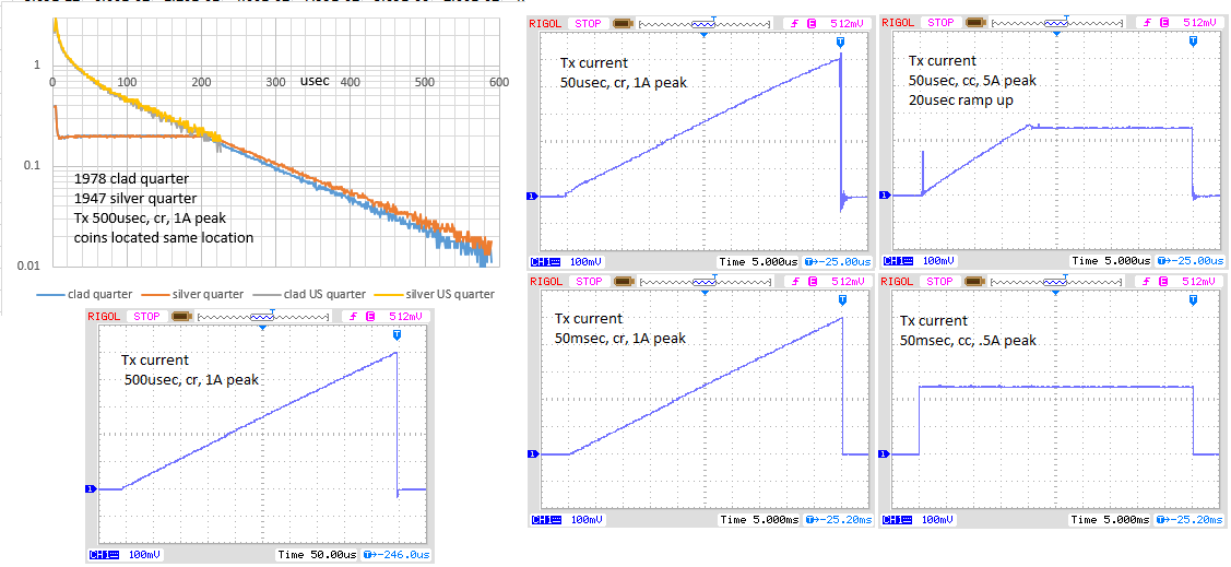

Target response tester
    Thinking about updating my target response tester to include a log amplifier and other modifications to compare with the decay curves I've been doing. Tx rate (1pps), Tx shape(constant current .5A peak or constant rate 1A peak), Tx width(adjustable 50usec to 50msec). Preamp(gain 450),post amp(gain 9). log amplifier(after preamp).
    Discussion: constant current peak 1/2 of constant rate peak for same average Tx current, the lower the constant current peak the shorter the ramp time to peak, preamp and post amplifier the same as I've been using, need to modify constant rate circuit to allow adjusting Tx width while keeping 1A peak, Tx rate 1pps for low average Tx current,
    Questions: any reason to make Tx rate adjustable? any changes or additions?
    Comments or thoughts appreciated, would be easier to include changes now than modify latter.
    Working on the bench tester. Zapped the one I've been using so the next charts or scope pictures will come from the new one. Ordered a LOG114 amp. Any changes or additions?
      Target Response Tester wired except for log amp. Did some testing to see if it works before trying to hard wire the log amp. Finally got a silver quarter. Eric's traces of clad and silver quarters looked real close. Mine does also, closer than expected. Now to see how the log amp works if I can wire it.

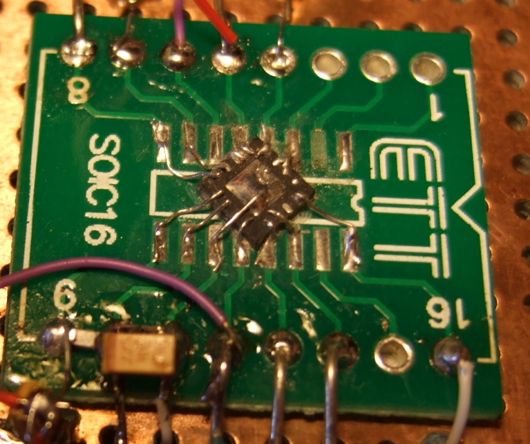

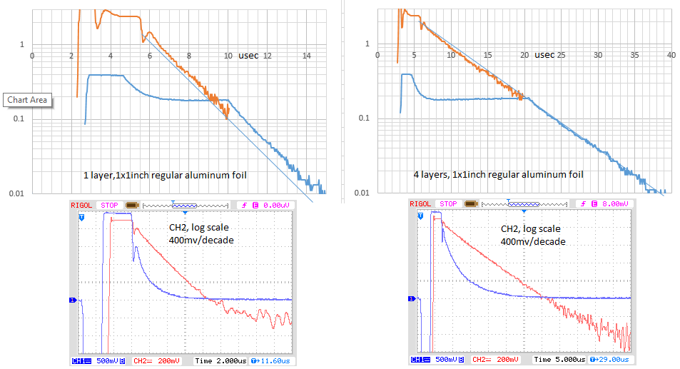

              Added the log amplifier. Glad I had only 1 chip that size to hard wire. Want to thank those that made suggestions when I was trying to learn something about log amps. I decided on the LOG114 because of speed and it would work with the +-2.5v power supply that I use for the other analog circuits. Did a comparison test with the log amp vs the way I normally do it. The two traces the way I normally do it didn't line up but the slope was the same. The 1 layer decays about 1 decade every 4usec both methods. TC=(time/decade)/2.3, =1.7usec. The 4 layer decays about 1 decade every 14usec both methods. TC=(time/decade)/2.3, =6.1usec.
              Log amp looking at pre amplifier out, gain about 450 vs (target sample recording-no target recording) (CH1)pre amplifier out, gain about 450 (CH2)amplifier out, gain 9 total gain about 4000. Both methods similar results. Both methods about 2 decades limited by amplifier noise. Log amp, real time the other takes a lot longer. Log amp needs a good no target zero, other method charts difference so it cancels any offset.

                  I was going to ask about your intended LOG114 circuit, and wondered if you were going to simulate it in Spice first, as you have the skills. I haven't read the datasheet for the IC, (though I did download it) but I was wondering how best to get round the 0.5V offset for the intended photodiode bias.
                  How did you wire up the IC ? I've just recently wired up an IC accelerometer in a tiny leadless package, some patience is needed.

                      Including a picture of how I wired the LOG114. Pin numbers are reversed, pin16 adaptor is pin1 of LOG114. Go clock wise, pin2 LOG114 not connected. Messed up pin 2 adaptor but it didn't matter because I don't use that op amp.

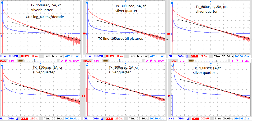

                        Some scope traces with a silver quarter at 3 different Tx width's, 1/2A peak constant current and 1A peak constant rate. Probably easier to see difference if they were on the same chart.

                          How did you wire yours? I wired an IC accelerometer in a tiny leadless package at work a few years back without the adapter. Was thinking might have to make modifications to the wiring this time so I used the adapter so I didn't have to rewire to the log amp.

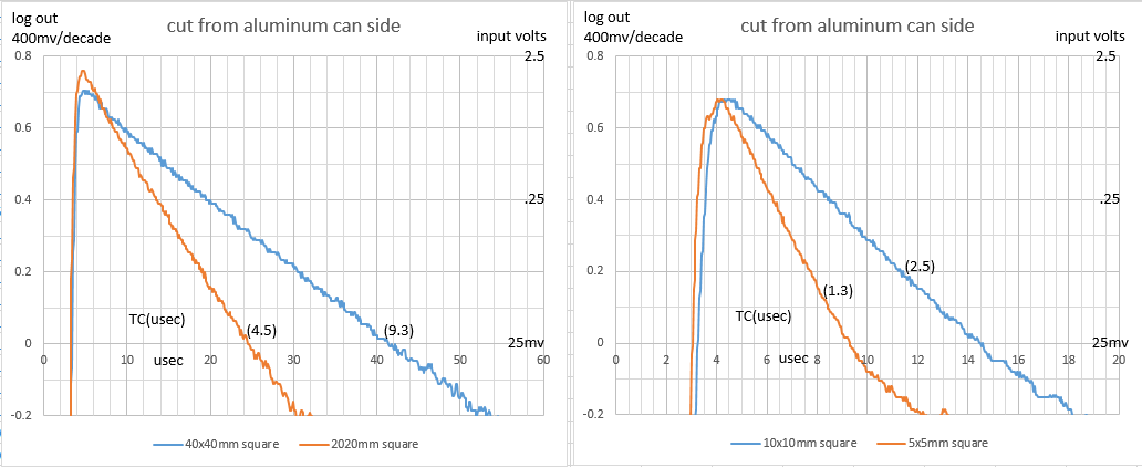

                            Some targets cut from an aluminum can side, LOG114 output. Looks alright above 25mv input. Not sure the slopes are correct, need to check decay response with known input. Maybe something similar to spice model, discharge a capacitor into the input.

                              Do you have any thoughts on why the errors occur when the input is low, ie. below 25mV ?
                              I was thinking it's simply a DC offset, that becomes more obvious as the actual DC signal level falls off.
                              But I did wonder if it was due to a slower log-amp response at lower input currents.
                              I guess ideally you want to drive the log-amp hard, so that these errors become less significant.
                              And regarding my accelerometer build, it looked surprisingly similar to your logamp, I stuck it on some copper-clad board, knife-cut with a simple pad layout. I'll try and find the pics I took of it.
                              I would assume the 40mm square can target would give the most accurate TC value (it's dimensions will be more precise, the longer TC is easier to measure accurately), and the other smaller samples should be in direct proportion. The fact that they're slightly high is curious. A more thorough experiment would be to test many (8, 10?) different size samples, and plot them on a 'straight-line' graph.

                                I think it's either speed or the no target signal being not quite zero early in the decay like you suggested. Going to try to discharge a capacitor into the input with discharge TC of 1, 3.3 and 10usec time constant.

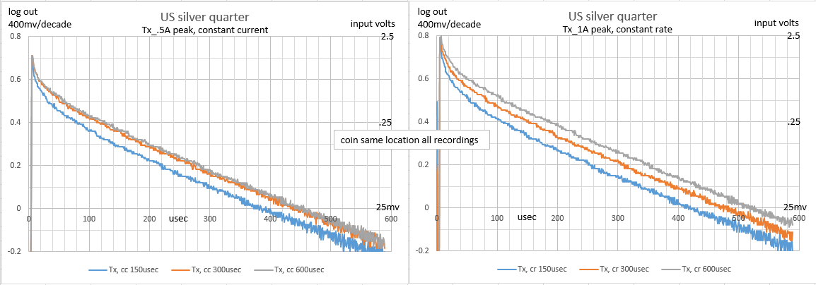

                                Charted the silver quarter again. The 300 and 600usec Tx width's with constant rate looked different than constant current with the scope traces I posted awhile back. Wanted to retest and chart to see if the same thing happened. The silver quarter has a TC around 150 to 160usec. Any thought why the 300 and 600usec Tx width is about the same constant current but different constant rate?
