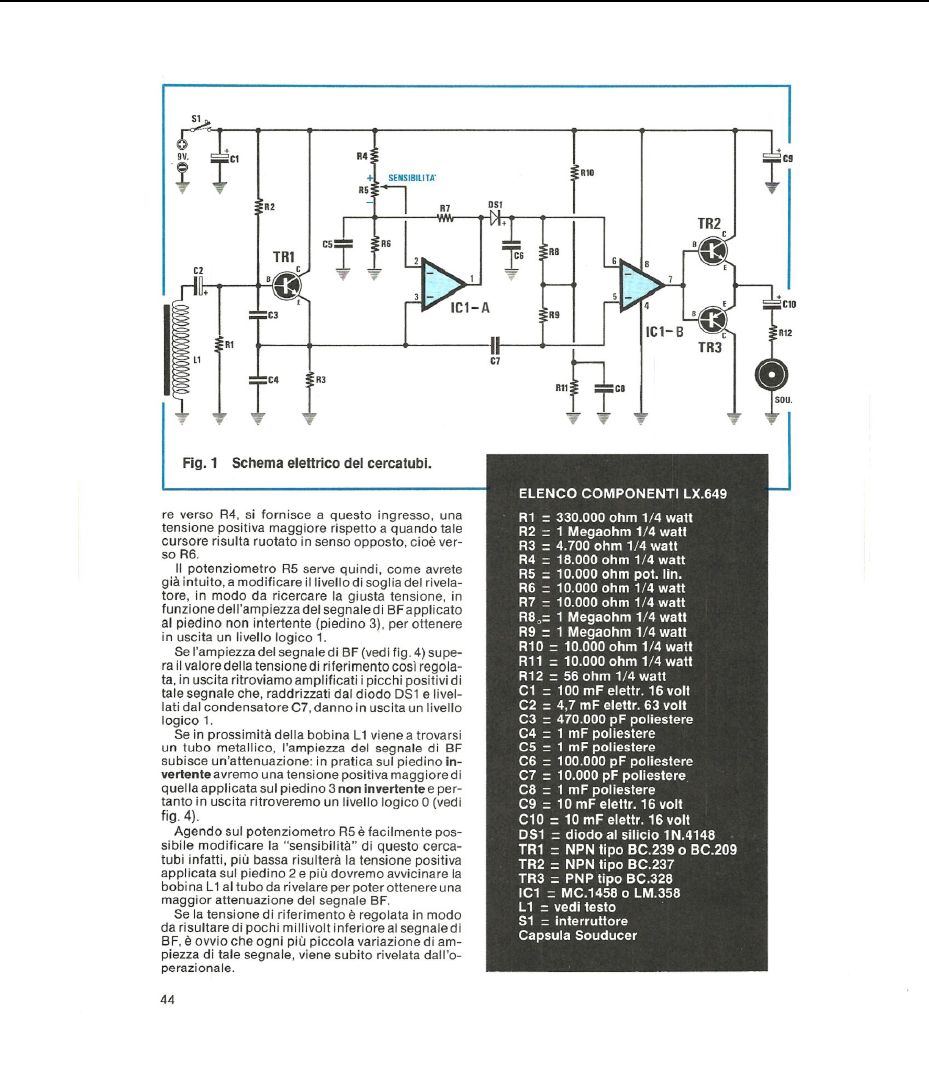

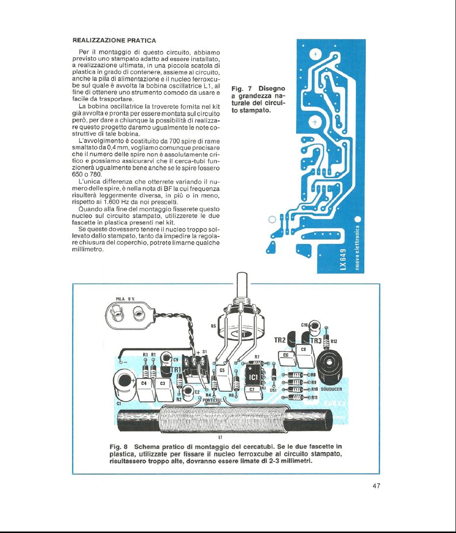

    Hiya All,,,,I came across this Pinpointer a while back and was going to have a go at making it. I just wondered if anyone had seen this design before or had ever attempted to build it? Also, I made a smaller version of it in Sprint layout 6 and was wondering if anyone could check my drawing to see if it's correct please? I've posted a copy of my layout,,the original board and schematic and I made a PDF file of the 7 pages with the information about it ,,,,it's not in English,,It may be italian but not sure for certain. Thanks,,,Marty
    Yes it is Italian.
    If you post a Link to the Original Article, It should be easy to translate.
    (I just typed in a Tiny Bit for a Test)
    Se inprossimita delta bobina L1 viene a trovarsi
    un tubo metallico. I'ampiezza del segnale di BF
    subisci un'attenauazione:
    (English
    If the Inproximates Delta coil L1 is found
    A metal tube. The amplitude of the BF signal
    Suffer a wait:
      Marty

        @Chemelec,,,,The original article came from a Nuovo Elettronica Magazine that I downloaded from the Internet but it's a 57mb PDF file.
        @KT315,,,,The Malysh is on my ''To build'' list,,,and yes, Eddy is good at layouts etc,,and I agree that the Project I posted isn't very advanced and just posted it out of interest. Thanks. Marty

            Does it need to be a circle coil or can it be made with a ferrite core rod like most pp are ?
              The coil with ferrite rod is very sensitive to the magnetic earth field, so it is recommended to use only a coil without ferrite core. I had made it as a pinpointer-digging tool, that shape of coil is working as well.
                This early version of Maljish FM w3as built with small ferrite core coil (value 1.4mH).

                          What is the Inductance of the Coil?
                          There are this data on ferrite coil construction:
                          220 turns on ferrite rod (dia 8mm lenght 50mm; antenna ferrite) using wire dia 0.15-0.18mm.
                          Air core coil:
                          There are different data on air core coil inductance around (from 1500uH to 2290uH).
                          Mine 7cm dia coil is 1300uH.
                          Example of air coil winding: 90 turns of 0.3mm wire on 150mm diameter round body.
                          Builder should follow coil oscillator resonance which should be 18-22kHz (by manipulating C2).
