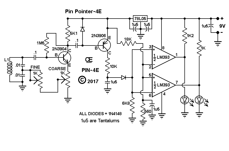

                      No Longer Updating my Website.
                      And Possibly Shut it Down in the near future.
                        Thanks Gary.

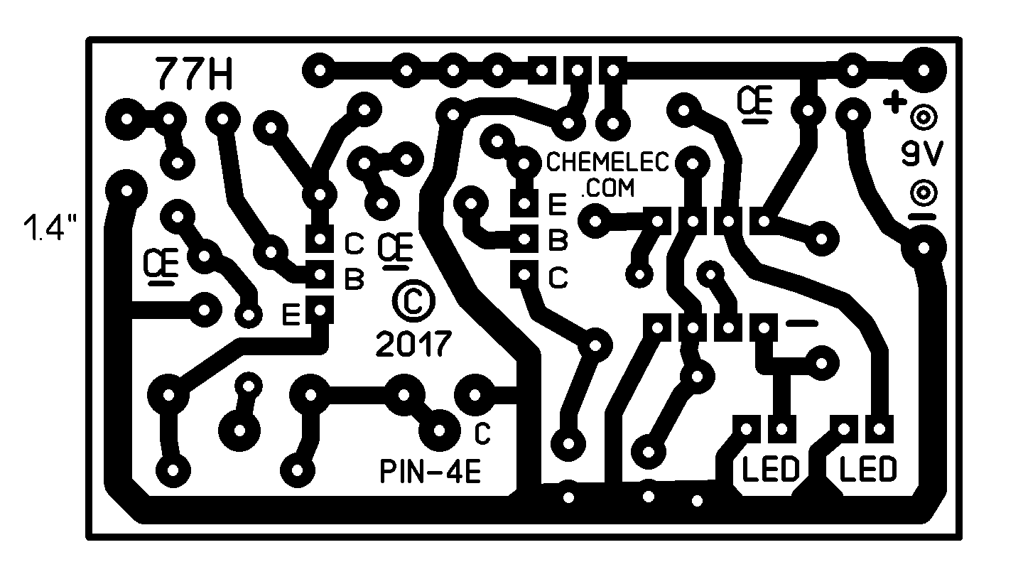

                          Hiya Chemelec....Would you have a copy of the pcb for the Pin pointer 4-E please. Thanks. Marty
                            I Tried to Upload this Layout, But it says it is Too Big of a File.
                            Even tried Re-Sizing it Much Smaller.
                            It was Created in Sprint 6.0.
ID:	352784Marty, Hope This Works
                                @Chemelec,,,,Thanks for the pcb image,,you're a star. I'll trace over it in Sprint and give it a try,,,I'll have to order some tantalums though cos' I don't think I have any 1u5,,,,Sorry to ask, but do you have an image of the silk screen? Much appreciated. Regards. Marty
