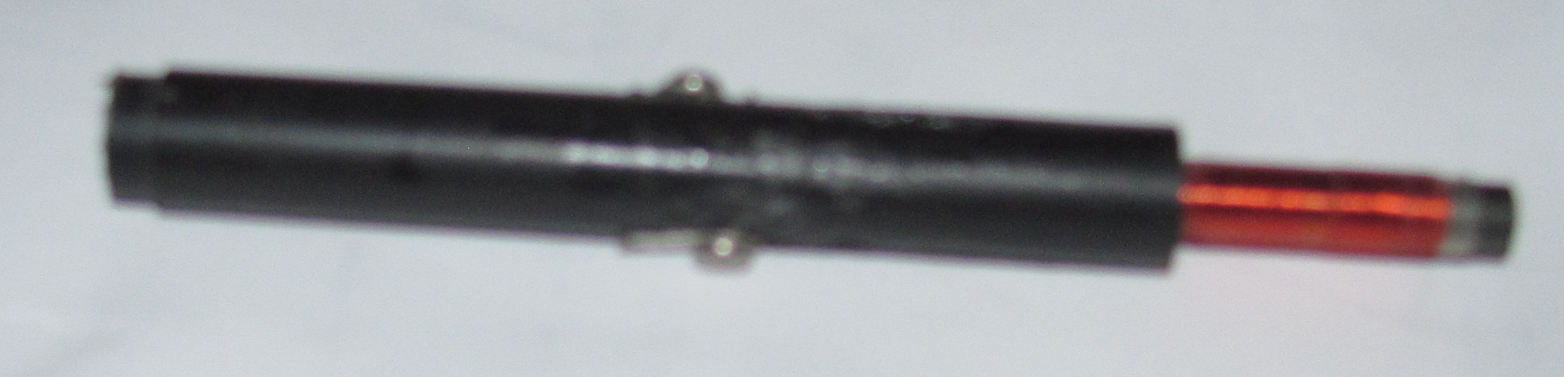

PinPointer- Has anyone seen or built this?
    I use the 1u5 Because I got a Deal on ordering a 1000 lot of them.
    You can use 1u tantalum.
    I like Tantalums, but even a 0.1 Polyester or Disc Cap will work.
    I Buy Most of my Parts in 100, !000, Some even in 10,000 Lots.
    However, Soon to Throw them All in the Garbage.
      Hi chemelec - do you have specs on the coil in your schematic? Inductance, ferrite used, wire diameter, turns?
      Beav
        Beav
        1/4 X 1 1/2 Inch Ferrite Rod.
        I Wound a 2 Layer Coil on it Using 30 AWG wire, with a measured Inductance of 1.2 mH.
        (Not Sure of exact number of Turns, But Close Wound covering 1 Inch of the Rod.)

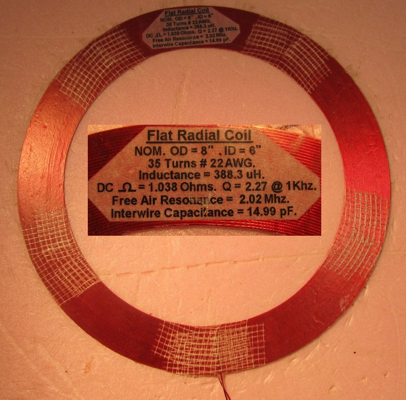

                                I prefer just PI Detectors. No Discrimination, just detects All metals.
                                Discrimination usually causes some loss in detection distance
                                Just because something is Not Gold, does Not mean it isn't Valuable.
                                And I Prefer a flat wound coil like these ones I make.
Name:	Flat Wound-2.jpg

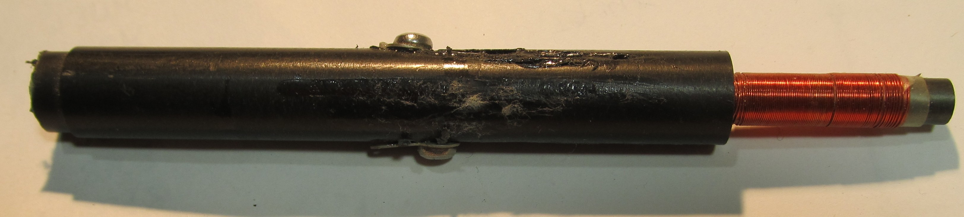

                                And I can also use a Pin Pointer like this on it.
