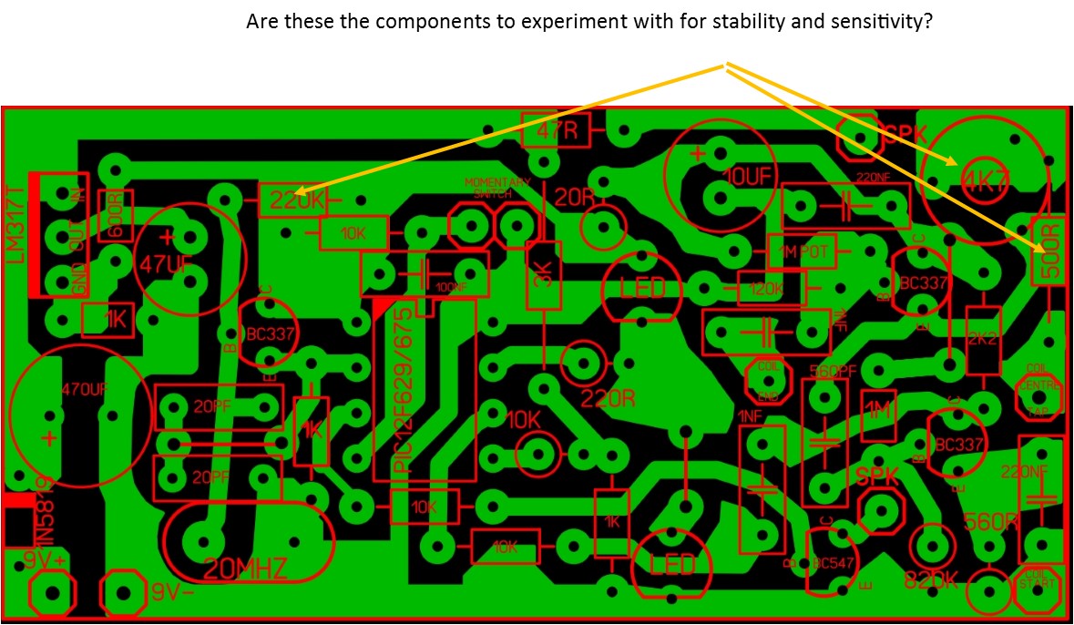

I hope everything goes well .. you have to adjust at your point using the 2 trimer .. I made the second now the optimal setting turned out to be 130 k and 620 oh - in the previous one the adjustment was 220 k and 500 oh .. you have to play with those 2 values until you find stability and sensitivity

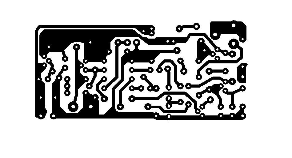

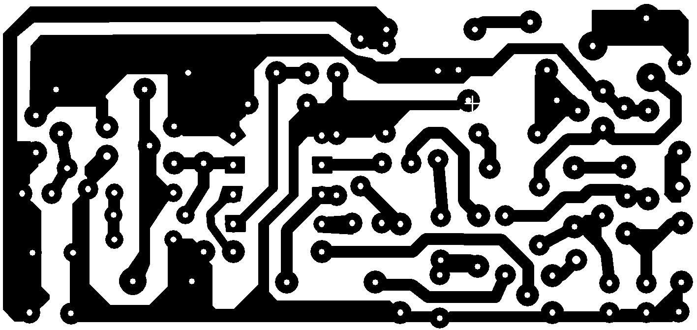

God bless. Will update you once completed. Just bought second hand laminator and looking for small project to test the abilities of the method. It is around 30 years since i last etched PCB(that time by hand with lacquer or permanent marker but the technologies are moving further). Than ORCAD in the university and...change of the field followed.
