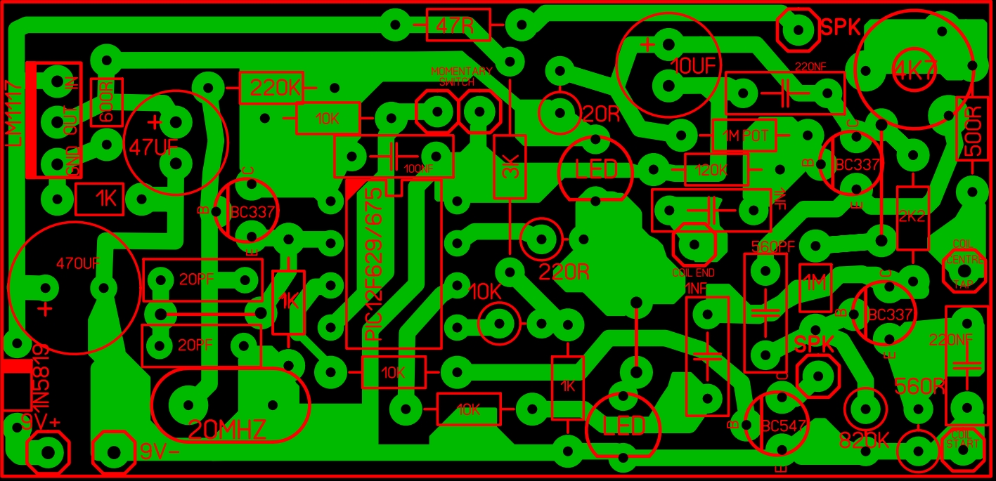

      • doing other tests and some more changes of components .. the pinpointer very stable from the beginning no longer need to readjust ... very stable more than the previous one I did
        • Hi Ricalbertvig,,,,,That's great!,,We are looking forward to your tests and modifications,,,Could you please post the sprint layout once you've completed tests so we are able to try it too. Much appreciated. Thanks,,,,Marty
          • FM2 MD,.rar hello there is my work .. condesador 560 pf of polipropeno ,,, those of 1 nf of tantalio, those of 20 pf of multilayer ceramics .. those of more of polyester, .. it seems that the good quality of the capacitors influences a lot in stability ...

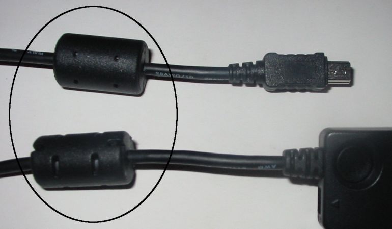

              • Hi ricalbertving
                could you please give the dimensions of the ferrite rod?
                length and diameter?
ID:	353620 hello any ferrite of the photo serves ... you have to shield and connect to ground ...
                  • Hi Ricalbertvig,,,,,Thanks for posting the layout,,,it looks really good what you have done,,,much appreciated,,Regards,,Marty

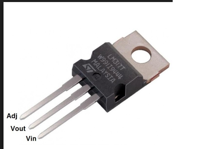

                    • Hiya Ricalbertvig,,,Do I still need to mount the 560R and 1k resistors if I use an LM1117 voltage regulator? Or can I leave them in? Thanks,,,Marty.

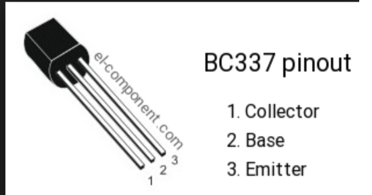

                          • hello marty in the regulator is what I used is the lm317t, since I do not have lm1117.
ID:	353623Click image for larger version
                              • Hiya Ricalbertvig,,,,thanks for your posts. I have LM1117, which is a 3.3v regulator, and I have LM317T also. I will try the LM317T as you have done, but I was wanting to know, if I use an LM1117, do I still have to place the 600R and 1K resistor or do I have to remove them? I checked the BC337 pinout on my drawing and have placed them correctly. Thanks again,,,Marty
