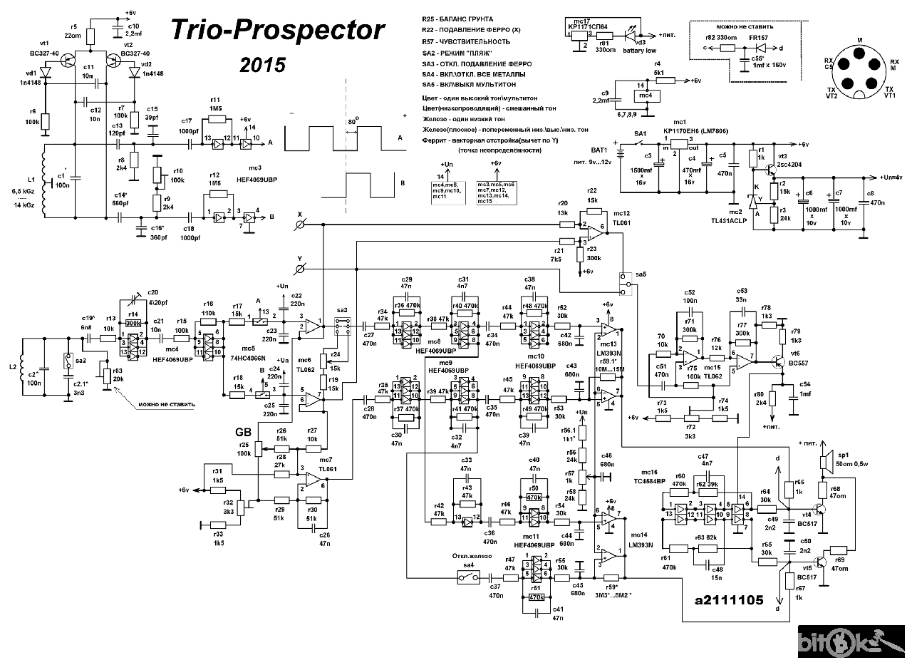

    Hi Dom,,,Just viewed the Terminator Prospector video,,,quite impressive isn't it? I don't have anything on that particular unit in my folder but I'll have a look round to see if I can find any info on it and let you know. Cheers. Marty

      I found these Dom,,,,Still looking,,lol. Marty

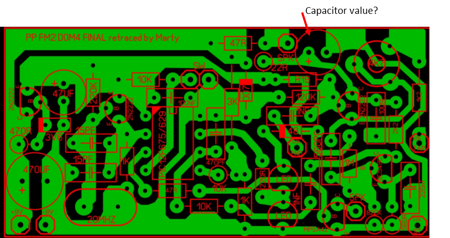

              Hiya Dom,,,Hope your search was successful,,,I'm still looking. Could you tell me what value this capacitor is please? Hope you didn't mind me re-tracing your layout, I just filled out the solder areas a bit, it uses more laserjet ink but saves on Ferric solution when I'm etching. Thanks. Marty
              • #67
                10uf is fine Marty here is a small clip of it working before you ask its a cheap ebay 1.5v to 5v converter board wanted to see how well it worked on one cell works fine draw from battery 50ma goes to 100ma when beeping not a lot of gain with coin distance but looks more sensitive to small metal objects, still an intermittent problem with stability goes into random beeping now and then but works most of the time.

                        Hiya Dom,,,I've had a good look at my PCB and can't find any faults on it,,,I cleaned all the flux of the board before I powered it up. I checked all the component values before I placed them(Cos' I always measure them with DVM,write them down and tick them off), the transistors are all oriented correctly,,,Which 2N222 dd you use? I used the plastic ones,,,I checked my capacitor ratings and orientation,,,,,and I checked my wiring etc and there's no solder bridges,,I can only assume there's a faulty part somewhere,,,I etched 2 x PCB's so for now, I'll just make another one cos' it'll be quicker for me to do than take parts off the first one to check them. Thanks,,,Marty
                        • #72
                          most important thing make sure you have about 3.3v or so emitter of T3 without that nothing going to work if you do the other pos problem is the crystal oscillator i think eddy has the 220k resistor marked as may need adjusting in value if that doesn't work again nothing will happen the coil oscillator stage works on its own but again wont work without power from T3 the PCB is correct if you have a component tester check transistors lead orientation as i have had some brands with different connections I have wasted much time on some circuits only to find the connections are not standard as marked on data sheet. now as standard practice i use a component tester to check the parts before i solder in saves a lot of time.

                              Hiya Dom,,,Did you decide which Terminator your going to build? I was looking at the Terminator Trio but there's that many different layouts I don't know which one to try,,lol. I've not found anymore yet on the Terminator Prospector yet but I'll keep looking. Regards,,,Marty.
                              • #75
                                yes have started it board almost populated need to make the coil , started testing audio stage works and power stage, it works fine needed to tweak a resistor value in the power supply but so far so good i am building the prospector version.
