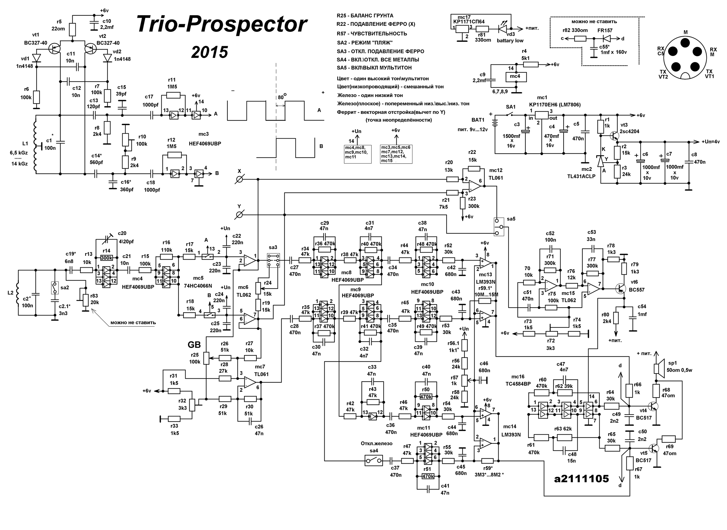

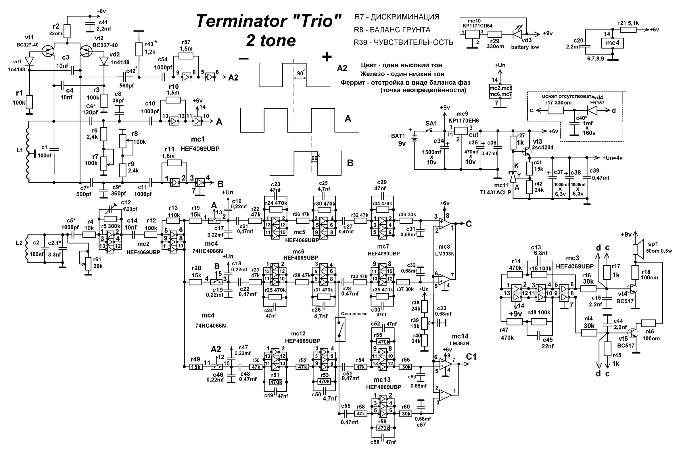

      Hi Marty if you want to build the Terminator detector where do you intend to use it if your going for coins better with the trio 2 tone has ground balance and discriminate it is also a good detector. i intend to use it in Australian mineralized ground thats why i am building the prospector has ground and iron exclusion controls no discriminate control but has tone discrimination and you can hook up a VDI display I will give you both. make sure you get unbuffered 4069 chips or wont work have to be marked 4069UB.

      I will post the PCB tomorrow have to check have the right ones.

            Hi again Dom,,,,I watched the videos you posted,,,it looks like a really good detector,,brilliant and seeing ferrous targets over iron,,,,,I'll have to build the Terminator trio 2 Tone because the Prospector layout is SMD and I've nnot got round to having a go at that yet. I've got all the eqipment to do it (apart from SMD Components) but never tried so I'll order a SMD Practise board to start learnng. The biggest copper clad boards I have are 100mmx70mm so Ill order some bigger boards while I'm at it. Do you have any coil data for it? and do both the Prospector nd Triio use the same coil? Hope I'm not bugging you,,lol. Thanks again Dom for the projects and the little lessons you keep teaching me. Regards,,,Marty

              I could not find any data on the coil so I used 30T center tap for the transmit coil and 100T for the receive coil I set mine to resonate at 10khz and the receive coil at 9.8khz got that from one of the forum posts, I was having trouble getting it to work at first could not find the problem then I remembered something, I have two lots of 4069's the first lot are marked CD4069UB they did not work so I substituted them for CD4069UBE and all of a sudden it went quite and started working you need the right chip i suggest you order the HEF4069UBP as marked on the schematic ebay has them but you have to make sure they do not substitute a different one.
              All i need to do now is set it up properly and do the final nulling of the coil and box it it looks good so far.

                  So far the detector works just as you see on the vids high tone for non-ferrous and low tone for ferrous I am still working out the switches, One pot translated as sensitivity but acts more like threshold adjustment goes from quite to mixed tone with a sharp cut in the one marked r39 in the two tone.
                  yes i used 15T+15T if you have the data should not be hard to work out the turns i used about .3mm for the transmit coil and some finer wire for the receive coil what ever i could find here prob about .15mm or so.
