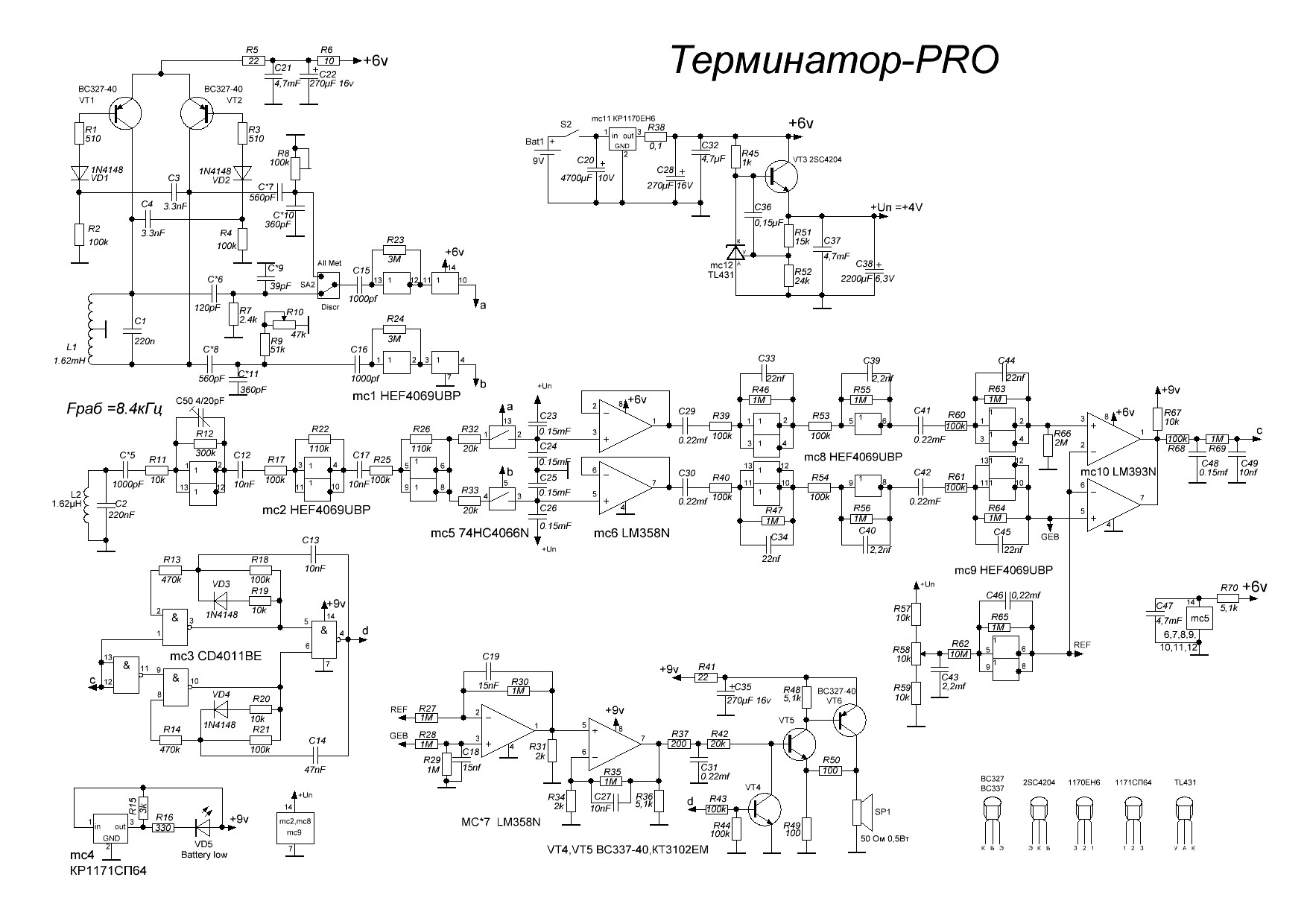

Hi Dom,,,,I've seen some vids somewhere,,,I remember watching them and thinking how sensisitve it was (10cm on coins - 20cm+ larger objects) and that's why I collected some info on it. I'll have a look and see if I can find them,,,,How goes the new Terminator Pro PCB? Hope you're seeing pleasant progress Dom,,,Regards,,Marty.

Hi Marty yes i did the layout and built it, still playing with the setup to get it to discriminate properly the two tone works, its a bit Fiddly a detector to set up had to try a few op amps and adjust resistances to get it to run right there is a LM358 comparator circuit MC7 that needs exact value resistor or you get low tone bleed through. but has the signs of a very good detector i built a concentric coil for this one first time I have built one it works well, I made it a small coil as i want to use it for nugget hunting.

Hi Dom,,,Glad to hear your Terminator project is coming along smoothly. The self designed gold pinpointer pen sounds a great idea,,,I wish I had a bit more electronics knowledge to able to design stuff like you do,,,a lot of people go gold 'sniping' here in England and it'd be great to design or build a verified pinpointer with a long narrow coil to be able to poke around in the crevices between bedrock etc,,,,Keep us posted on your project please Dom,,,I've not ordered anything yet for that Terminator Trio 2 tone PCB but it's still a definite project for me,,,,still trying to get my FM2 O2 to work but I think I'm going to build another cos' I can't suss out what's wrong,,the coil for it works fine on my 1st FM2 so I know it's not that. Good luck with your project Dom. Regards,,,Marty
no problem Marty will get to the pin pointer soon i am trying to get a few detectors working right going to do some detecting soon I want to do some field trials to see how they perform in our ground, I have just finished of tesoro gold demon moded to 45khz works great the ground balance is a bit sharp to set have to change a few things but sensitive detector , can pick up a 1gram nugget at 50mm in air and a ring at 400mm while exuding a large piece of ferrite and that is only a 200mm coil. next is the second version gold demon my design working 32khz crystal locked oscillator showing the same sensitivity but having some small VCO issues have to sort out. then will get to the terminators.
