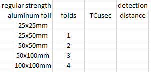

          I would suggest using a standard set of targets. Maybe using regular strength aluminum foil. Suggested targets would have a time constant range of about 1.5us to 25us. Could make a set and fill in the blanks if interested. Maybe rings would have a TC range similar to the test targets?
