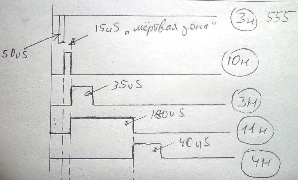

              Icl7660 V- is -4.75V.
              Seems should be -5.0, yes? V+ good.
                One sample PW 39uS, other 43. Starts 195uS apart.

                      That dual field coil might be bad, or improperly damped. Dig up the timings regime and compare it to what you've got. I can't remember. If all is well with the circuit, then it's probably the coil.
                        Yours should resemble this.
                          measured with your scope what is the voltage on pin 6 of the 5534 ?
                          trimpot was set correctly for zero baseline offset
                            I think you have bad coil, inner coil alone is working, outer coil maybe not. Put object on edge of outer coil and check for response.
