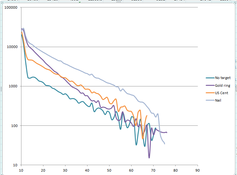

    Interesting but the values at the right end of my plots are about 4 uV at the coil or 4mV at the ADC input. Targets are 3 inch above coil center. I can get stronger signals if targets are closer to coil.
    I ran this again. Captured and averaged 4 curves of no target and a nail sitting on the coil. put 1 curve of gold ring and US cent .
    I think I see this 'knee' on the nail's curve.
    Note: X axis is point number so multiple by 2usec for time.

      log amplitude-linear time or log amplitude-log time?
      log amplitude-linear time. Log-log is linear for viscous responses.
      I'm afraid you don't. There is a bending of a nail response past 120us, yet most probably it is just noise that plays with your expectations. If the same bending persists after averaging 16 or more curves you'll be able to say it is truly there.
      In this sample period it is apparent that the slope is not nearly as steep as non-Fe target. Perhaps it is OK to go with a shorter period, and decide the nature of a target according to the slope alone, just as the manufacturer-whose-name-must-not-be-said has.
      Perhaps it will be possible to see the bend at much earlier samples in a response of a ferrite ring core, but there is no practical meaning in knowing its response - there are no ring cores laying about in nature.
      Also please note how the gold ring and US cent response cross each other at about 55us. So say I want to have a PI with high repetition rate, and Tx pulse duration = total sample period. It only means I can't expect EF to do its role in presence of Fe, and I should go for bipolar pulsing.

          Ok, that is fine this is not what you are looking for.
          The nail is actually average of 8 * 4 = 32 sampling periods.
          I am in the "lets see what info" is in the decay curve and can we extract this info.
          I am seriously thinking of a bi-polar tx pulse. This would simplify trying to do EFE.
          I also plan to explore TX on sampling and analysis but haven't got there yet.
          Thanks for questions and discussion.

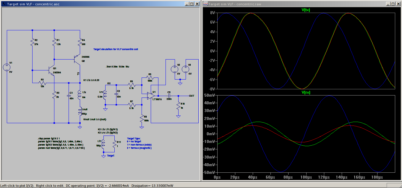

                  Despite saying "That's All Folks!", I may have solved the problem after all ... at least to some extent, and possibly good enough for our purposes.
                  The attached simulation is for a VLF detector with a concentric (Tesoro) coil. With this setup, all targets give a phase-shift left, non-ferrous targets increase in amplitude, and ferrous give a decrease. There are three simulation runs comprising "no target", a "100us TC non-ferrous (eddy) target", and a "100us TC ferrous (magnetic) target". In order for the ferrous target to give the correct results, the coupling between the target and the RX loop is decreased by 25%, and the coupling coefficient between the nulling and RX loop is increased from 0.71 to 0.7135. As you can readily see, it only takes a small adjustment to account for the distortion of the magnetic field (due to absorption) and produce the necessary amplitude decrease below that of the no target response.
                  Having tested various targets with a 9" diameter concentric coil connected to a Raptor circuit, I can see that the simulation results are a reasonably close match with reality. I would have expected that the phase-shift in the RX loop would increase with higher TC targets, but this is not the case. In fact, the phase-shift seems to be unrelated to the TC, and is more affected by the distance of the target from the coil. Also, it is important not to confuse the RX phase-shift with the phase angle calculated by sampling the in-phase and quadrature components of the RX signal. In this case, the phase angle is defined by:
                  You also have to remember that the double-differentiating architecture of Tesoro-like analog detectors are processing the rate-of-change of the rate-of-change of the RX signal. When a VDI circuit is attached to the outputs of the GEB and DISC channels, the GEB channel will always go positive when any metal target passes over the coil. On the other hand the DISC channel goes positive for non-ferrous and negative for ferrous. In this latter case the value of R is negated, which shifts the calculated value of by 90 degrees. By measuring the R and X values in the simulation, I was able to calculate that the VDI value for the 100us non-ferrous target is 173, and the value for the 100us non-ferrous target is 23. These results align well with the expected values.
                  If you want to run the same simulation for a DD coil, it is necessary to adjust the TX-RX coupling coefficient to account for absorption with the ferrous target, instead of the nulling coil, which (of course) is no longer there. The target to RX loop coupling coefficient will also need to be adjusted accordingly.
                  In the attached simulation:
                  Green = no target
                  Blue = 100us TC non-ferrous (eddy) target
                  Red = 100us TC ferrous (magnetic) target
                  Even without running a similar simulation for a PI detector with a mono coil, it should be fairly obvious that the PI will be unable to distinguish between the ferrous and non-ferrous targets, as only changes in amplitude are available. Without a balanced loop system, there is no way to detect the effects of absorption produced by the ferrous target. All you see is an increase is RX signal for all targets.
                  Anyway, more food for thought...

                    George, I see you finally resorted to fiddling like I did. In the end it's all about a change in mu and its effects on the inductances and the coupling
                    • Originally posted by Teleno View Post
                      I purposely avoided playing around with the loop inductances, as the effect we're trying to simulate is due to a distortion in the magnetic field which upsets the coil balance. That's why I only adjust the coupling coefficients to account for absorption by the ferrous target. If you adjust the inductance, this would be similar to how a BFO operates, which is not the case in this particular instance. As you can see, the coupling coefficients associated with the targets are quite small, and the adjustment for ferrous is only 0.0035.
                      However, your method did lead me to this solution. In particular, the use of the table construct in LTspice.

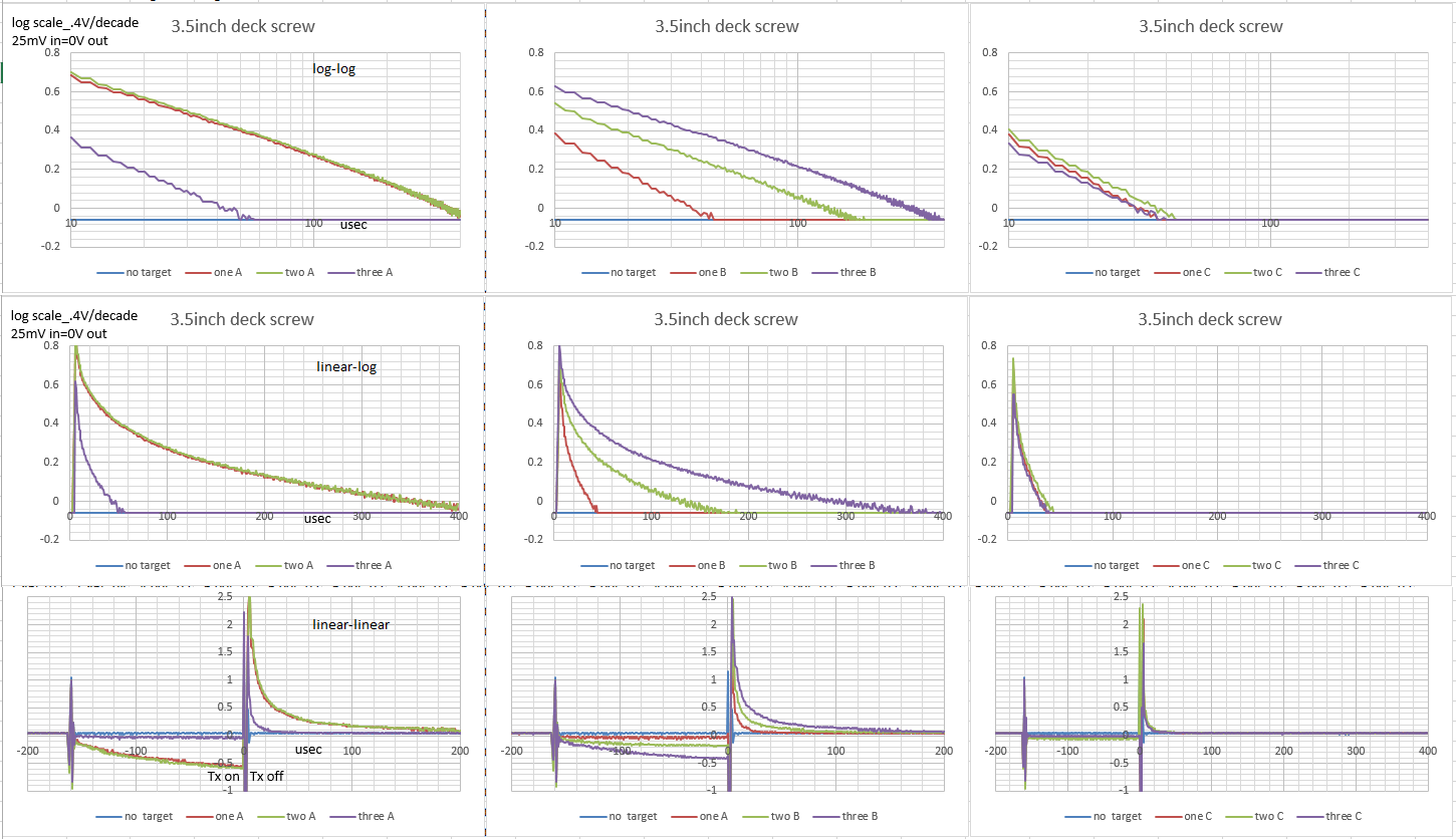

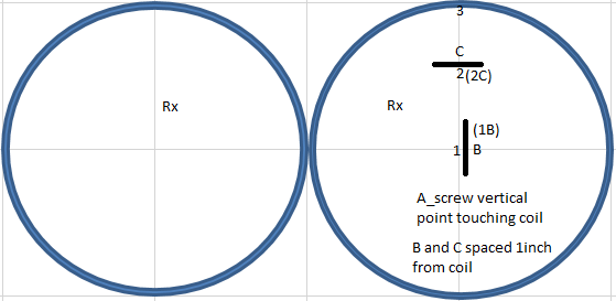

                            Charted a deck screw linear-linear, linear-log and log-log at 9 different positions. I like the log-log, fairly straight line decay same as ground. Interested in how you read the linear-log charts. Rx(two 200mm round coils connected figure eight)Tx surrounds Rx. IB allows looking at signal during Tx linear-linear(signal opposite polarity during Tx so no log amplitude)

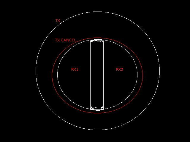

                            • I am having idea of two separate RX coil and preamp for a pulse machine. Balanced with each other, and also both within a tx cancelled field. Each RX would be made to act complimenrary to each other when field is disturbed by target. The complimentary angles would vary according to type of target.
                              Each RX would be fed through filters then unto ADC then micro, where angles can be reconstructed and interpreted.
                              Maybe it's not good idea. But I strongly feel that for more to be done with pulse, special attention have to be put on coil array.
                              • Something like this
