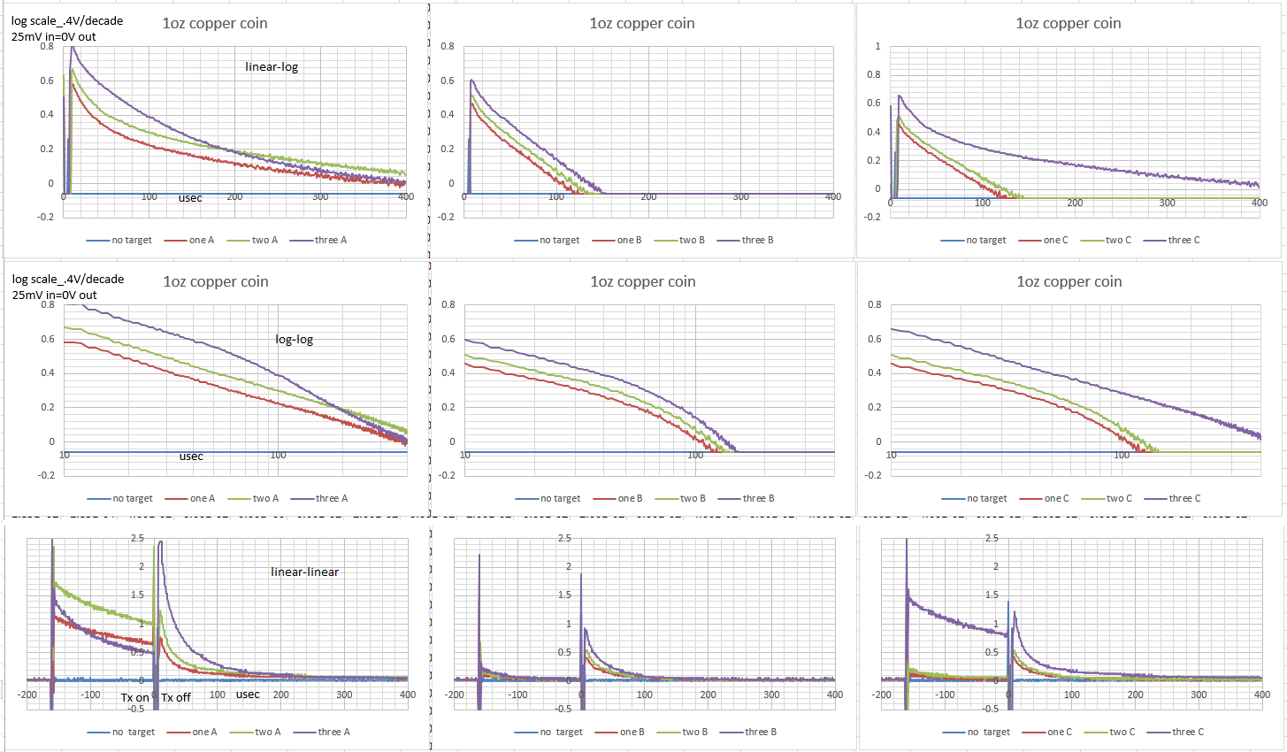

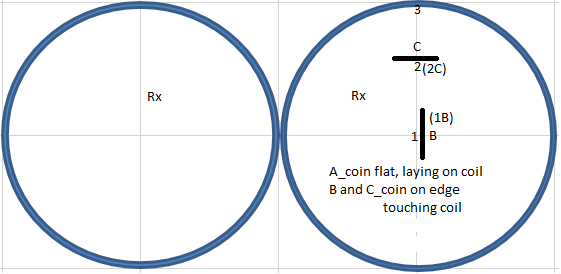

        Charted a deck screw linear-linear, linear-log and log-log at 9 different positions. I like the log-log, fairly straight line decay same as ground. Interested in how you read the linear-log charts. Rx(two 200mm round coils connected figure eight)Tx surrounds Rx. IB allows looking at signal during Tx linear-linear(signal opposite polarity during Tx so no log amplitude)
        Charted a 1oz 99.9% copper coin at the same 9 locations. Ferrous target reply#103 charted close to straight line decay at all target locations. The coin charted close to straight line decay log-log or some locations were straight line decay log-log in the beginning, then decayed straight line linear-log.

              • @green, there are always some influences of a measurement set on the obtained results. I'll have to contemplate a bit on what you got.
                What is your measurement set? How do you excite the coil, and did you play with the damping resistor? The copper coin results look to me as if there is a bit of an overdamping messing with your results.

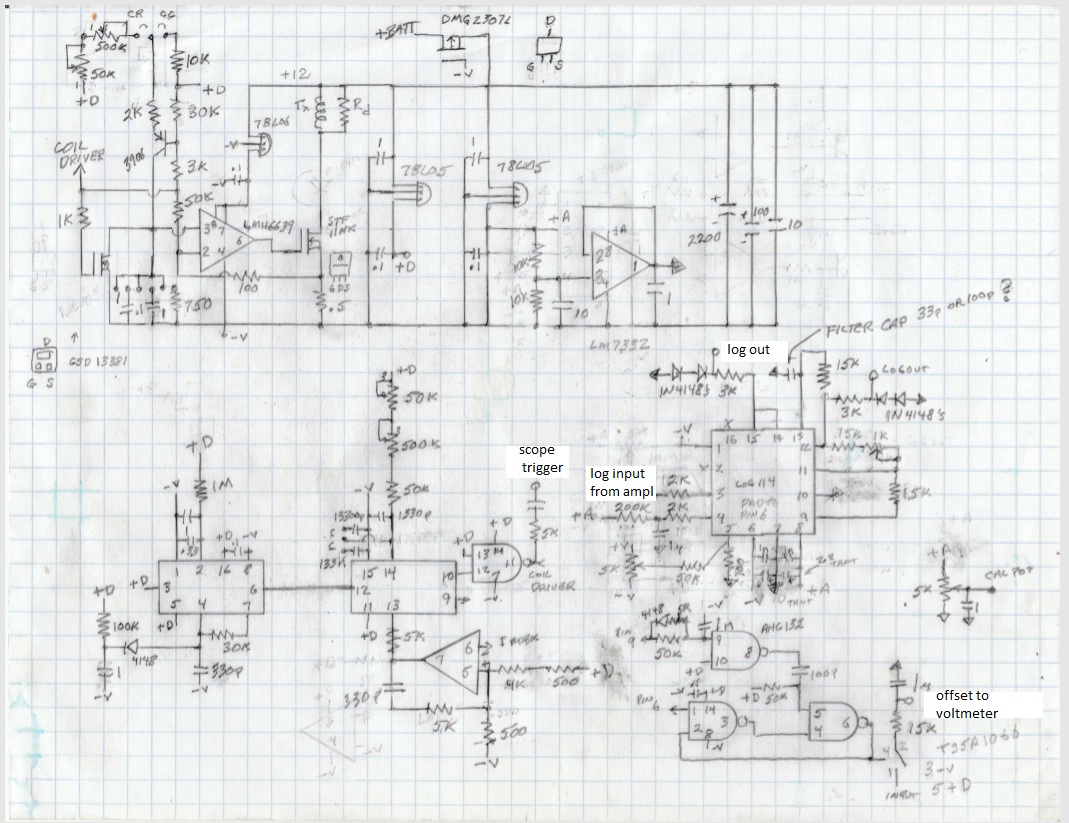

                  https://www.geotech1.com/forums/show...255#post239255 defines the tester I'm using. Quite long so if there is a question just ask. Coil: Rx(two 20cm round coil side by side connected figure eight) Tx surrounds Rx. Tx 160us on time, constant rate 1A peak. The coins TC is about 500usec so a longer Tx time would effect decay off and it would lower the Rx signal when Tx is on Damping was adjusted. Schematic is correct except I'm using the other log out off pin 12.

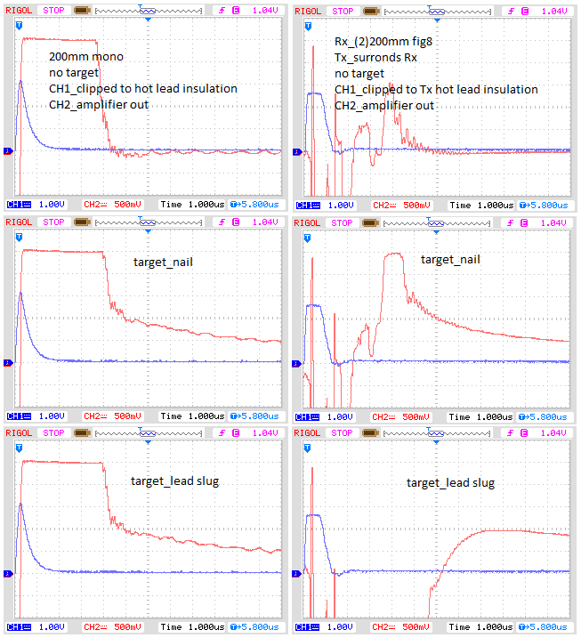

                  • Actually you need a Tx on time at least as long as the observed Rx period. Otherwise there is a steeper decay observed at Rx past the Tx on time (delay).
                    Perhaps you should also add a fast recovery diode (MUR...) to "hide" the MOSFET capacitance from Rx, and a series resistor of a few ohms to limit the current.
                    Unfortunately I did not follow the target response tester topic, but from what I can see, the schematic is nice Log amp and all.

                      Schematic is correct except I'm using the other log out off pin 12 Wrong. The schematic shows a MUR460 diode in series with Tx(erased). Tried both ways. Used without for awhile but has been included for a long time. The current is in a control loop, constant rate 1A peak or constant current .5A peak. Tx on time adjustable. To get a Rx signal during Tx, Tx current needs to be changing. Best if changing at a constant rate.

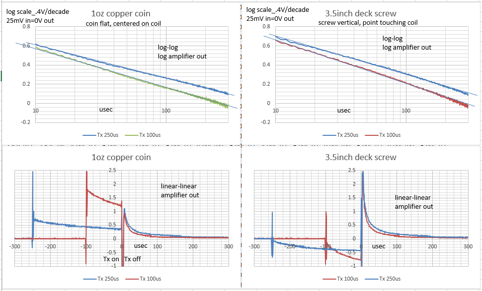

                          One of the reasons I built the target response tester was to try and understand what effects and why. Recorded the coin and screw at 100 and 250us Tx time to see what effect Tx time has. Both targets have near straight line decay log-log Tx off. Shorter Tx time decayed faster. The two targets chart close to the same. Need to try with the smaller coil, higher signal to decay past 500us.
                          Tried the mono coil again since the ferrous and non ferrous decay looked the same(ferrous_non ferrous_3), wondered if I recorded the same target twice. No difference, think I've seen a thread with scope pictures showing a difference. Anyone know which thread or what I might try?
                          • Green, where can I find the scheme for your test circuit?

                                no. don't know if bipolar Tx would improve charting target decay curve
                                I guess I don't know. Think if Rx doesn't change when increasing Tx on time it could be fully stimulated?
                                Tx: constant rate 1A peak or constant current .5A peak, on time adjustable from 50us to 50ms, about 1 pulse/sec
