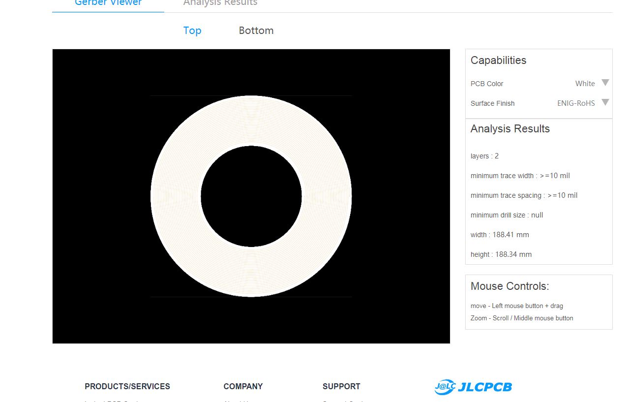

                  That's interesting, I have placed an order for 188mm x 2 layer, Click image for larger version
ID:	354734 I'll let you know how we go with that.
                    Originally posted by Mdtoday View Post
                    That's interesting, I have placed an order for 188mm x 2 layer, [ATTACH]47215[/ATTACH] I'll let you know how we go with that.
                    Yep, went through fine Carl, tried over at PCBway also and it passed audit there too

                        i alos tested to place an offer for 296mm dia spiral coil pcb, witg 1,5mm line width and 0,5mm gab, double side
                        production test without troubles, but to expensive at monent 70? plus shipping, plus oversize (end price around 100? for 10 big pcb)
                        will be my next order
