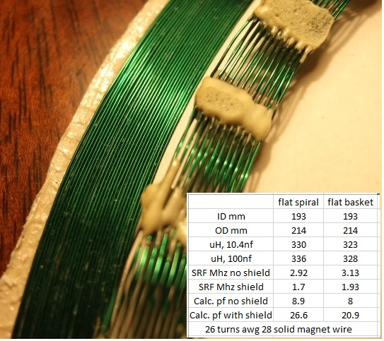

A picture of two coils I posted awhile back. How much less than 9pf do you expect the PCB coil to be? Was expecting more of a difference in capacitance since the flat basket has more spacing. Almost no spacing with the flat spiral. Interested in how the PCB coil compares, inductance, capacitance and SRF.Originally posted by Carl-NC View PostAdvantages of PCB coil:- lower interwinding capacitance

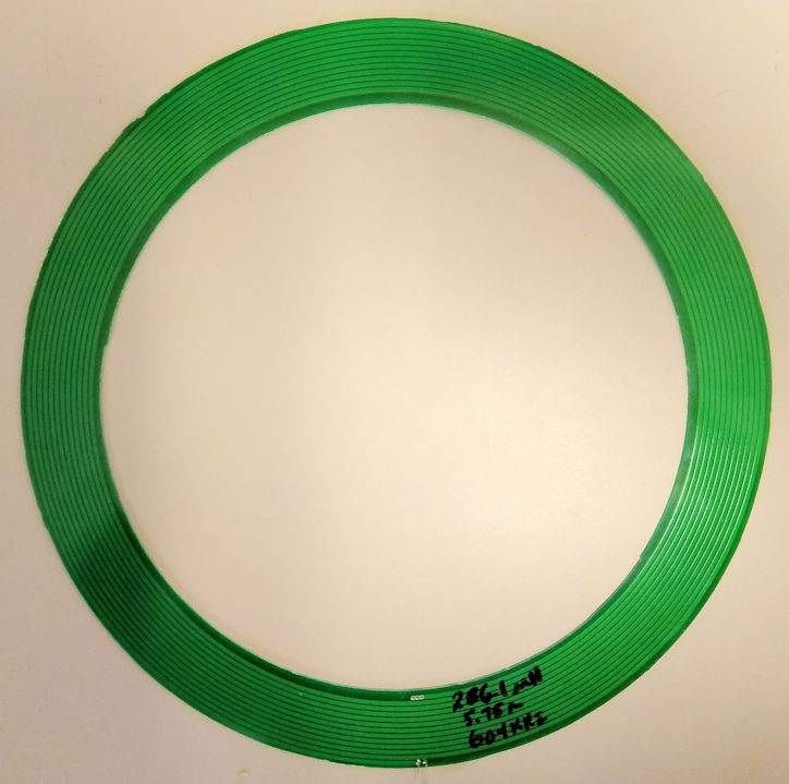

Eh, not for now. I got my JLC-made PCBs a week ago or so, but been too busy to mess with them. Finally got them routed and tested. Results suck. SRF for the 10" coil is 604kHz, which is WORSE than a scramble-wound coil using magnet wire. My PVC-insulated winding is over twice the SRF, at 1220kHz.Originally posted by Carl-NC View PostAdvantages of PCB coil:- lower interwinding capacitance
I'm very certain the problem is the fact I used double-sided windings, and the ground terminal windings are directly under the peak signal windings. Either I need to stick with single-sided, or do a very complex layout to minimize top-bottom capacitance. For now, I will do nothing.

I think that won't help much. What I'd like to do is one turn on top, then via to the bottom and do 2 turns, via back to top and 2 more turns, etc. The the high voltage is at the outside edge, and ground is on the inside edge. High V is never near ground.Originally posted by Altra View PostThat's too bad. At least you were able to determine that approach is not the best. I wonder if you could stagger the top and bottom traces? So that the traces on one side are centered over the etched area of the opposite side? Thanks for posting
EasyPC does spirals very easily, but arcs & semi-circles are difficult. Another day...
