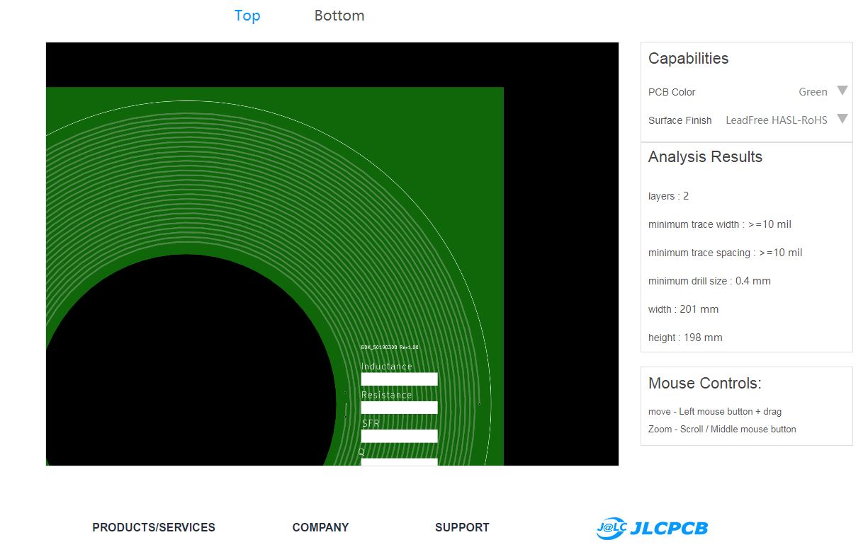

          Further to the JLPCB PCB coil order.
          I removed circular vslots around circumference and added a silkscreen and increased board thickness from 1.2mm to 1.6mm ... Click image for larger version
ID:	354753 they were happy to manufacture this, in fact they are completed and on the way.
          Original design with complete circular cut-outs was accepted over at PCBway with roughly a 30% cost increase.

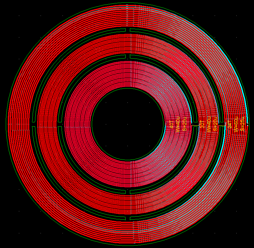

                Here is what I submitted:
                I suppose I could put a small hole in the center and then use my Dremel with a circle-cutting jig to route out all the coils.

                        So it's not the circular traces, but the circular routing that's the problem? Even with a language barrier they could have explained that to me.
                        [ATTACH]47276[/ATTACH]

                            It is possible that it is the 'square' inside ends of the curved slots that flagged Carl's coil board as not doable.
                            Wonder if it will be accepted if those slot ends have a radius.
                              I've generally found that square inside corners are not a problem, it's understood they will get rounded.
                              I removed the slots, made the overall PCB square, and added 1/8" drill holes for setting up my Dremel circle cutter. JLC accepted it and, in fact, made the boards in 1 day and they shipped today. Unfortunately, when I placed the order I forgot to specify 2oz copper so my series R will be high. Oh well, I can still do some comparison tests.

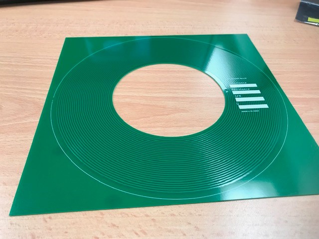

                                Received the test pcb coils this morning, they look ok.
                                I can put them on the CNC and cut the outer, not a problem but I'd prefer to have them done.
                                I'll take some measurements later but they are as ordered.
