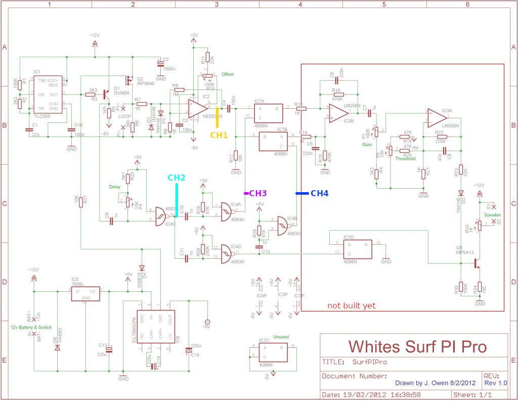

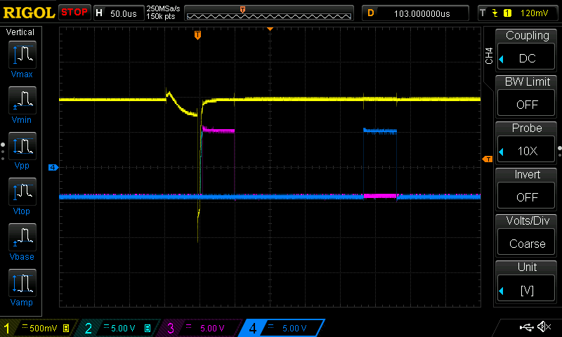

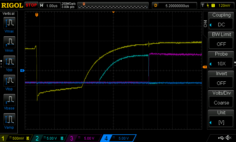

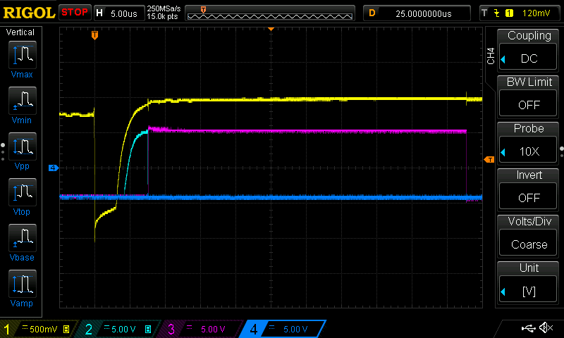

        I finally found time to build up half of the Whites SurfPI Pro design.
        I'm not sure if I got the pulse generation stuff right though. Anyone wanna take a quick look?
        Trace captured at different timebases: Click image for larger version

        Probes are attached like this: Click image for larger version
                        Trace captured at different timebases: [ATTACH]53686[/ATTACH] [ATTACH]53687[/ATTACH] [ATTACH]53688[/ATTACH]
                        Probes are attached like this: [ATTACH]53689[/ATTACH]

                            As my previous post says I'm still at building the Surf PI Pro design.
                            I built it about halfway including the pulse generation. The integrator part is not yet done.
                            However I'm not quite sure if the coil collapse impulse and sample pulses look correct.
                            Did I miss a detailed building guide like they exist for other similar PI designs like Baracuda?

                              PI's are typical and you can use any building guide, bara too, for surf pi.
                              • #45
