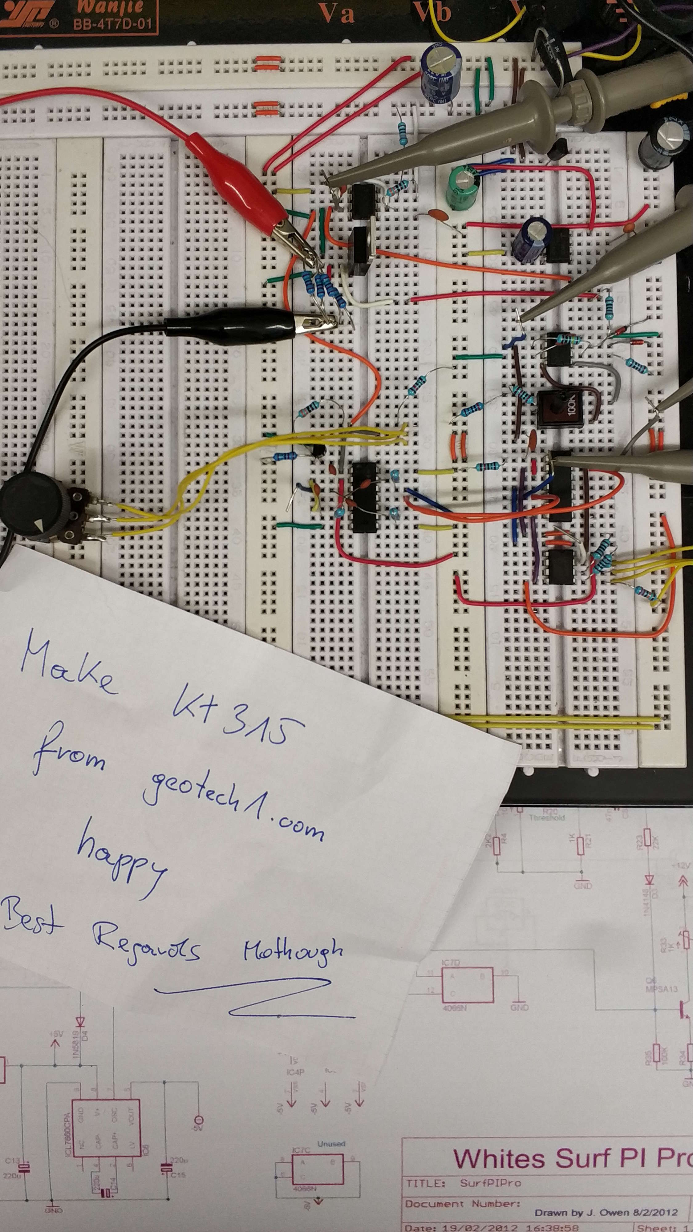

Figured out the pulse generation. I did misinterpret the different pulses. I thought the first 4093 (IC4C) output is already the sampling pulse but it is not.
Furthermore there may be a value error in the schematic mentioned above. The delay pot P4 is only 10k, with the additional 5k1 from R25 I cannot get the delay pulse long enough. In a non-pro version of the schematic it is a 100k pot. With that combination I can easily achive 20?s of delay pulse mentioned in the Baracuda build guide.
Just to recap the different functions of the schmitt triggers in the pulse generation stage:
*) IC4C just creates the delay pulse used to offset the first sample pulse.
*) IC4A creates the first sample pulse with a width of about 40?s.
*) IC4D creates a second delay pulse to offset the second sample pulse.
*) IC4B creates the second sample pulse with a width of about 40?s.
Now lets check once again the RX preamp stage and then continue with building the sampling integrator.
Anyone know by chance how much gain the preamp stage should have? Like voltage swing of the signal. It seems I'm only getting about 2Vpp which seems quite low?
