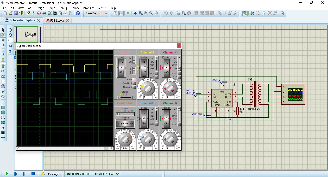

    Does anyone have any idea what driver could be used to drive the TX coil since it is a square signal ?.
    • #47
      Probably an H-bridge circuit. I've used discrete designs with PMOS/NMOS devices, and also used an integrated H-bridge (DRV8872).

          I did a simulation in Proteus and it looks like it might work Click image for larger version

          • #50
            Thanks for your answer, I thought it would be something like that. I found this document in which there is some information about it.
            https://patentimages.storage.googlea...80372904A1.pdf
            Yes, Fig 1 is the basic H-bridge.

                  I just wanted to show how easy it is to generate a basic signal like in Deus 2 and nothing else. Since no one yet knows what the parameters of the RX and TX coils are, what their inductance is and what the power supply of the H-bridge driver is, so far we can only speculate on how exactly it works.

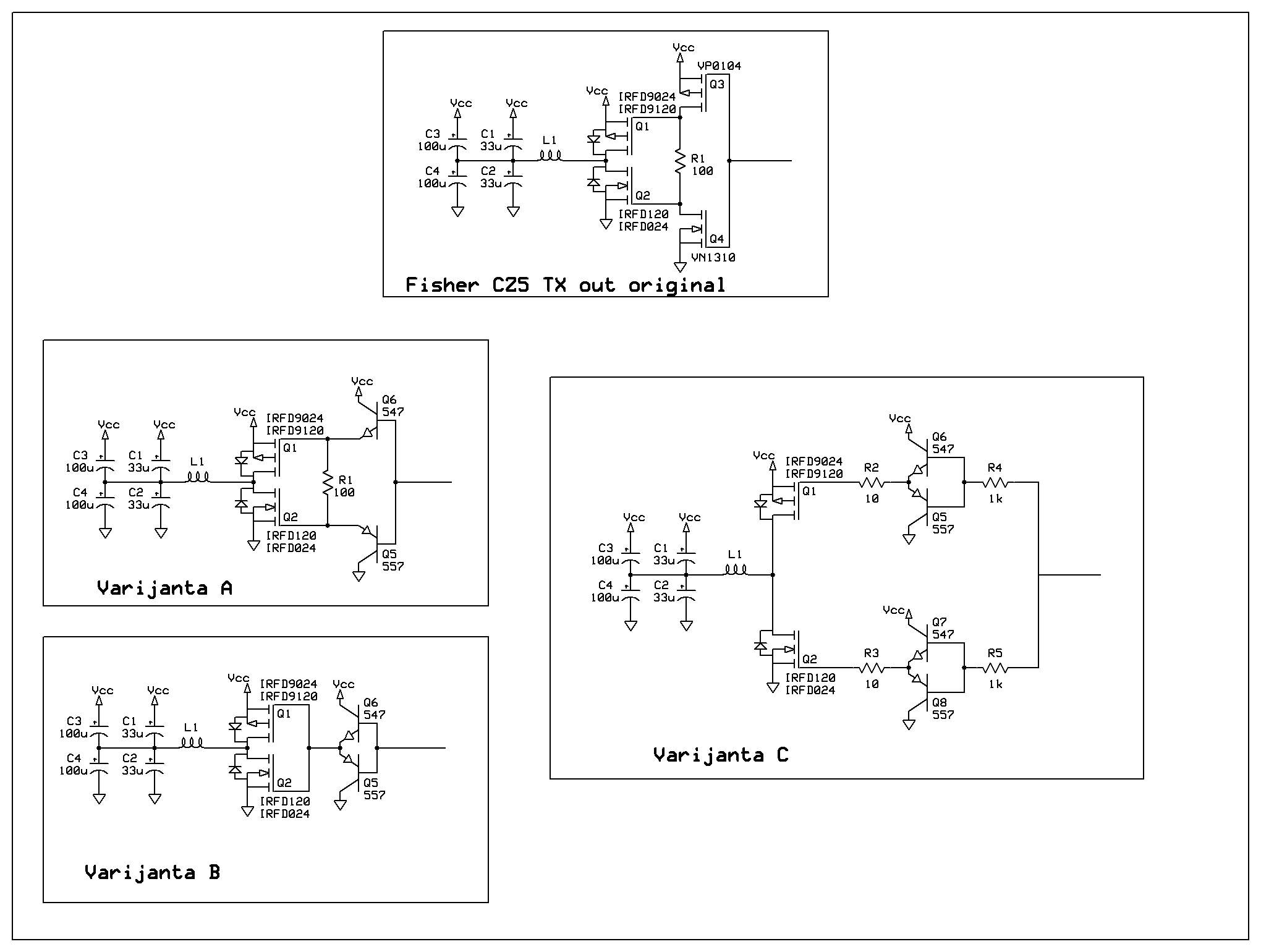

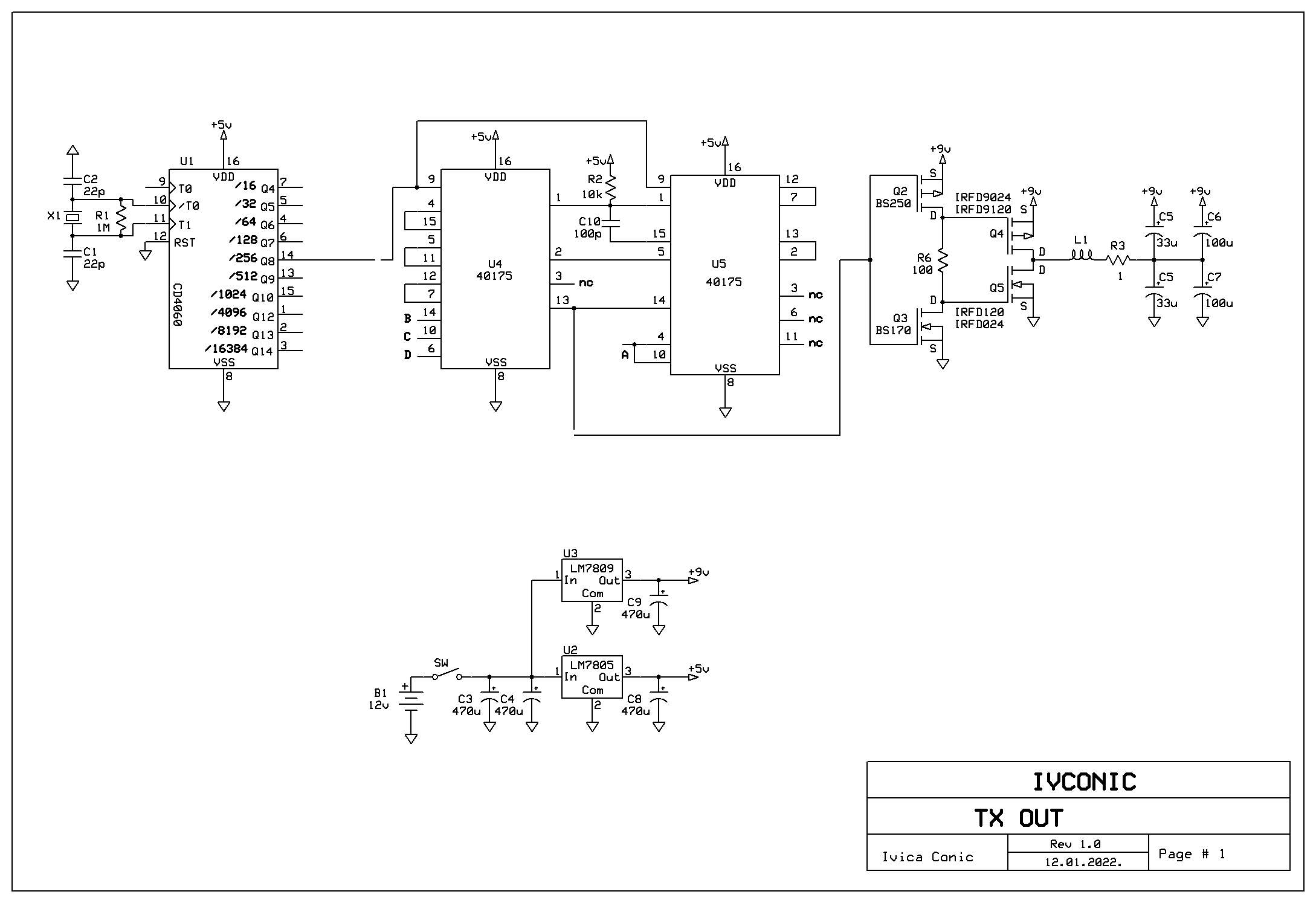

                    For those who would like to experiment:
                    P.S.
                    Flipflops can be omitted, join fOut and fIn points then.
                    Or omit all 3 ic's, fed outer signal to TX driver, from some waveform generator ... or Arduino...
                        These are half-bridge drivers which will also work but produce half the p-p current of an H-bridge.

                        • #57
                          These are half-bridge drivers which will also work but produce half the p-p current of an H-bridge...
                          Sure it is. I ordered a pcb for that particular case, intend to build it and make some experiments.
                          This is coincidental, as I did draw this several months ago, slowly planing to make it eventualy.
                          I didn't know that we gonna talk here about such and simillar things, this is pure coincident.
                          Reason I picked half-bridge is because I didn't need to reinvent the wheel all over again, I saw it in action so many times with my CZ detectors.
                          So it is proven and seen in action already. I only adapted it for my experiments.
                          I can use it as standalone, with or without phase extraction... or I can use only TX out , then driven by Atmega later.
                          So I can experiment and check it either ways.
                          For full h-bridge it will double the components in TX out and will demand engagement of two pins from Atmega... which I don't like.
                          I always try to spare pins in advance, no matter what I start to do. Sort of paranoia.
                          Or... I can feed the gates with same signal with addition of single inverter for the second gate. Now... this will need good choice among the solutions...
                          As someone once said; there are many ways to skin a cat...
                          First and simplest would be another small fet, probably n-channel, main signal on gate, 0 degrees from source and 180 degress from drain, and feed two sides with the same signal like that.
                          Don't have prepared schematic for this, speaking directly from immagination...
                          But aside that.
                          I don't see any special advantage of using full h-bridge over using half-bridge in this case... except in increasing a current.

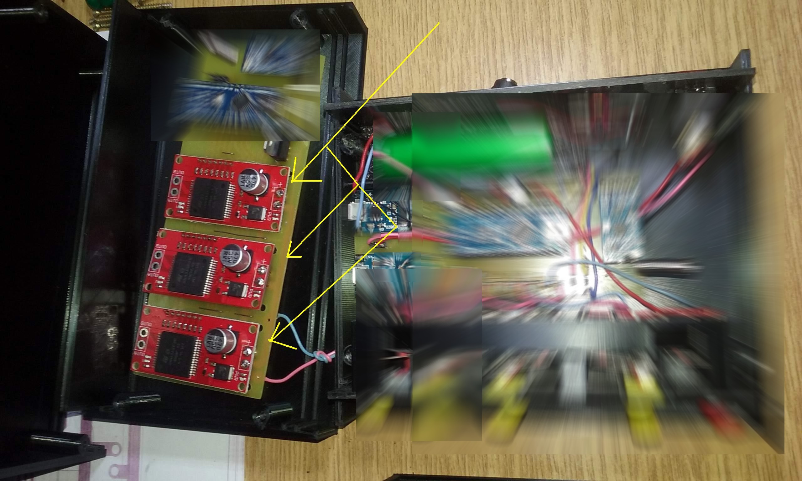

                          P.S.
                          Carl... do you really want to shoot the amperes ?
                          I have for several years VNH2SP30 module in my practice:
                          It never came to my mind to try to drive a TX coil with it!
                          I may try that one of these days...
