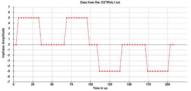

      I have successfully recreated the three-level waveform, and fed it into a spectrum analysis package.
      It was a sort of success, but the spec analysis program caused some hair loss, it wouldn't give repeatable data, seeming to remember old settings and crap like that.
      Anyhow, it spat out some useful stuff, that matched my earlier attempts at modelling it. I tried it on a plain square wave first ( like a CZ ), te ensure it matched what is easily calculated with normal maths. Then tried it on the D2 waveform.
      For the 'CZ' square wave, +5V / -5V levels:
      Fundamental sine amplitude = 6.365 V
      Third harmonic amplitude = 2.122 V , exactly 33.3% of the fundamental, as maths shows.
      For the Deus2, 4.7k/14.2k signal, +5V / 0V / -5V levels:
      Fundamental sine amplitude = 3.25 V
      Third harmonic amplitude = 3.888 V; this is 120% of the fundamental.
      ( I'm not 100% sure on these actual amplitudes, but the 120% figure is correct, even if the individual voltage are not )
      So ... third harmonic level is more than 3 times greater with that fancy 3-level waveform, compared to the Fisher-CZ type of wave. That's got to help the noise performance.

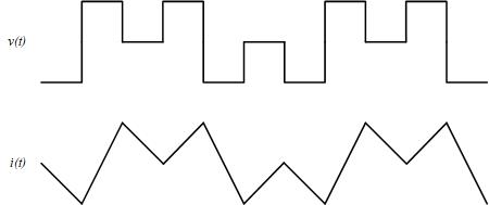

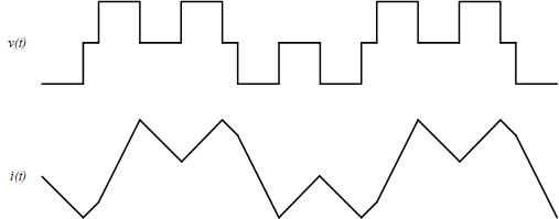

        • #64

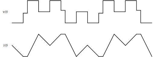

          I find the exact waveform for the D2 to be a little curious. A simpler voltage waveform results in the following current waveform:
          But the D2 waveform has those extra "pauses" which produce an odd glitch in the current slew:
          I'm not sure what they are for as they produce asymmetrical slews in the current. The induced EMF in the target has the same (but negated) waveform as the TX coil voltage so the eddy current response will also have a "hitch" in the response at those short pauses. Right now I'm not getting it.
          As far as how to create these waveforms, you (Skippy) are right, an H-bridge will need a couple of extra ground switches. Which also makes me wonder about current recycling. In a normal H-bridge TX circuit a big cap is placed across the H-bridge supply and the coil current is recycled in a manner that has almost the same efficiency as an LC sinusoidal oscillator. In the D2 scenario I'm not sure how that plays out, but I assume it does because power efficiency is a key element of the D2 design.

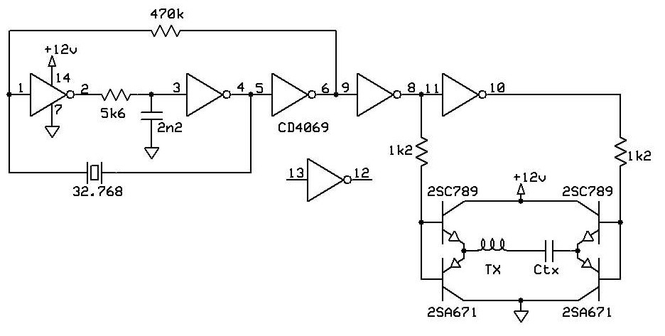

              Back in a days i had Cscope 33XD.
              I wanted to boost its capabilities by adding strong standalone TX, parted 15-30 meters away from the searching area.
              So I made this circuit and it gave ~200vpp at the output, basic clock frequency.
              Results were good, 33XD worked much better with such booster on.
              Now... with the drivers you mentioned here guys; i see the rough picture of how it can be done.
              Actually the current can be fine controlled by the pwm coming from mcu. (I'm definitely losing the bet now!)

              Let's ask somebody who already got Deus 2, to place the ear on coil surface and listen carefully for the "clicks"!

                If the PWM coming from mcu is sinus; it doesn't really matter the question: half or full h bridge.
                In half-bridge arrangement you don't need extra ground switches.

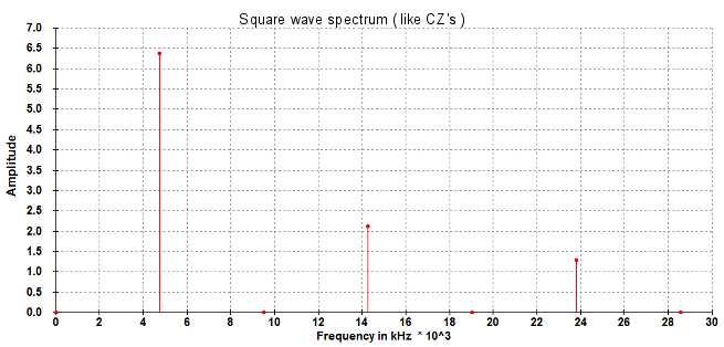

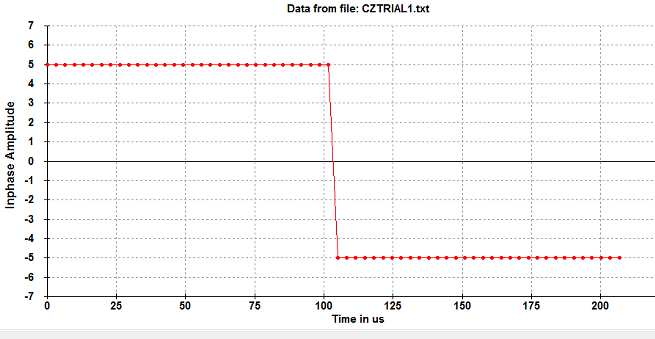

                  • #69

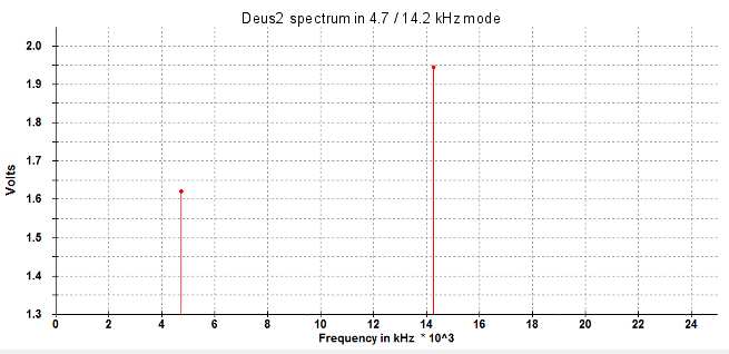

                    Attached are: The plain square-wave that I used to evaluate the spectrum, eg. Fisher CZ tx drive.
                    And the two spectrum outputs, 'CZ' and Deus2'. The square wave has the familiar diminishing amplitude of the third and 5th harmonics ( 0.333 and 0.200 of the fundamental ).
                    The Deus2 has the third harmonic 20% stronger than the fundamental. The 5th, 7th harmonics were quite low, the higher orders had more strength.
                    The amplitudes shown on the spectrum are half what they actually are... problems with the 'ScopeDSP' software.

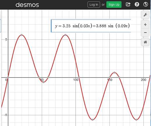

                    And a Desmos plot of y = 3.25 sin (wt) + 3.888 sin (3wt) ,
                    showing what the Deus waveform behaves like, considering just the useful parts of the 'square' signal.

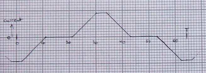

                    • #70
                      My 'notebook' sketch of coil current for the 3-level waveform, attached.
                      It looks right when considering the fundamental freq. It's 90 degrees away from the voltage, like current through an L is, doing a:
                      I = - cos (wt) waveshape.

                        • #72
                          Forget the last one. Skippy, your waveform in #70 is probably right. Still requires some DC offsets at the held peaks. Also, this ceases to be MF, maybe it's one of the SF modes.
