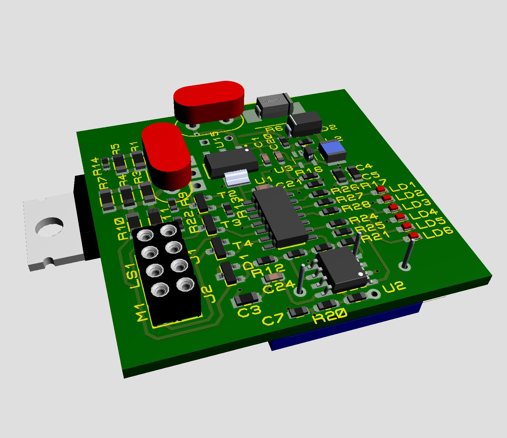

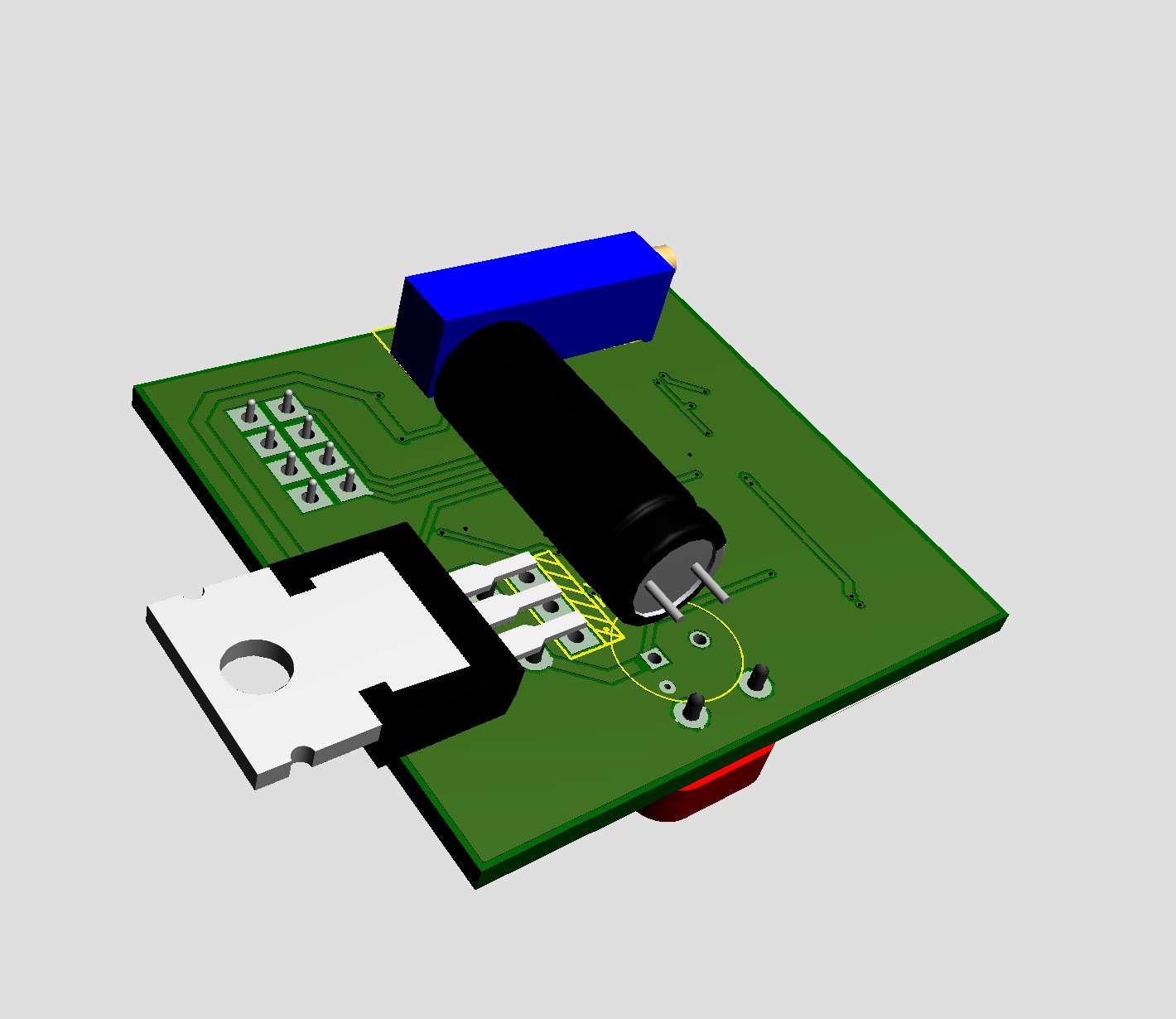

    no clue why I have taken a liking to it, but I am just starting to draw the PCB
    David
    why you draw the pcb? there is a a layout you can use already, Eddy71 on forum
      Drawing a pcb for me is easy, his PCB has a documented error, so I do not need that and I do not want the motor vibrator function either.
      I have code so a new pcb seems best

        no clue how to make them appear in post but there is my pcb, being made as we read this by jlspcb, in a week or so I will let you know what arrives

ID:	407954​I like things drawn a little different, so I redrew Eddies drawing, its almost Identical your thoughts ?
