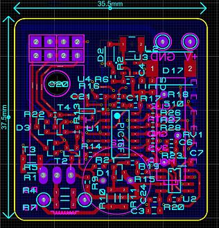

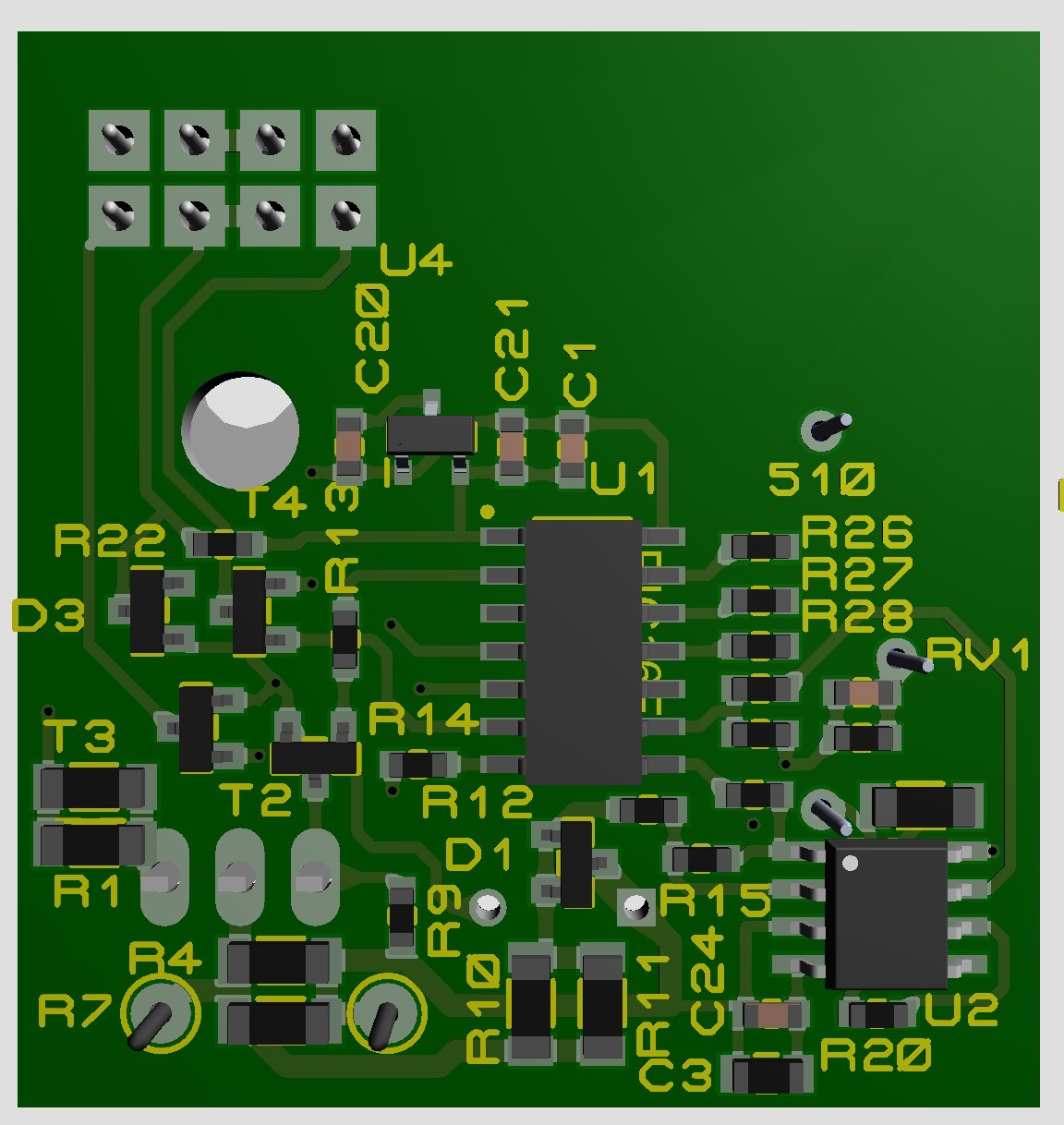

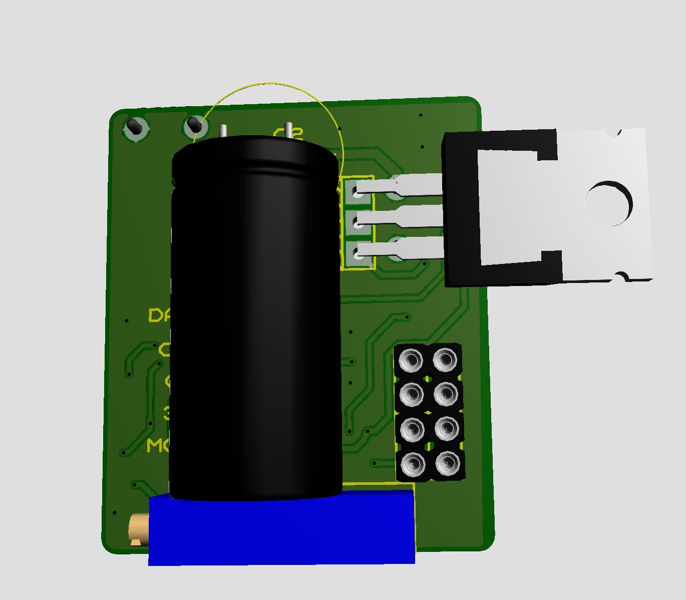

    So this is the same schematic as the other pcb only small 30x36mm also has pads added to program on the pcb. I will not make this until I have tested the other PCB the good news is its now in the UK should be delivered very soon

                    Drawing is something I like to do, I had a second pcb to make, but decided my traces / tracks would be better if I rerouted them, in the end the whole pcb is now new ... LOL
                    but not finished yet

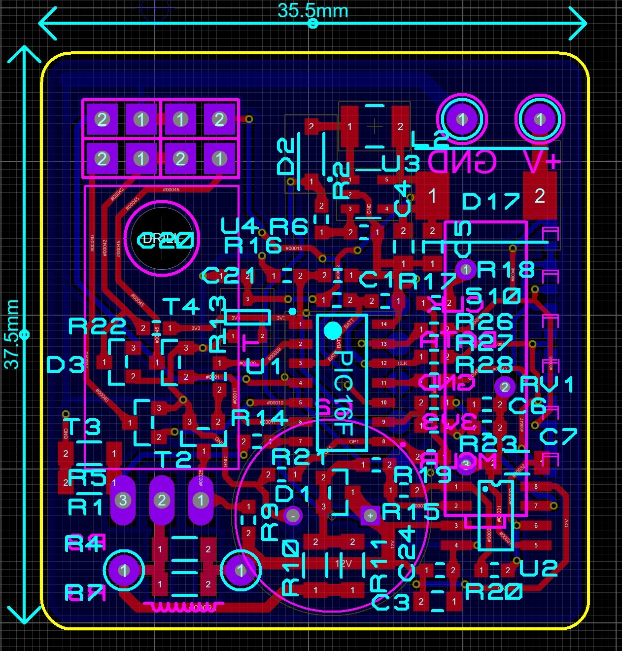

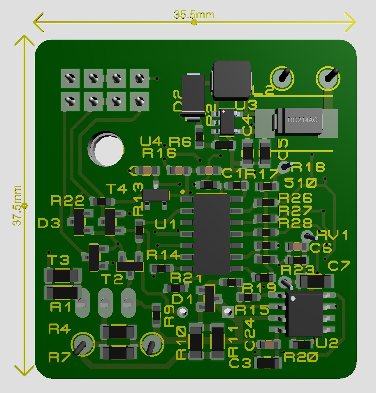

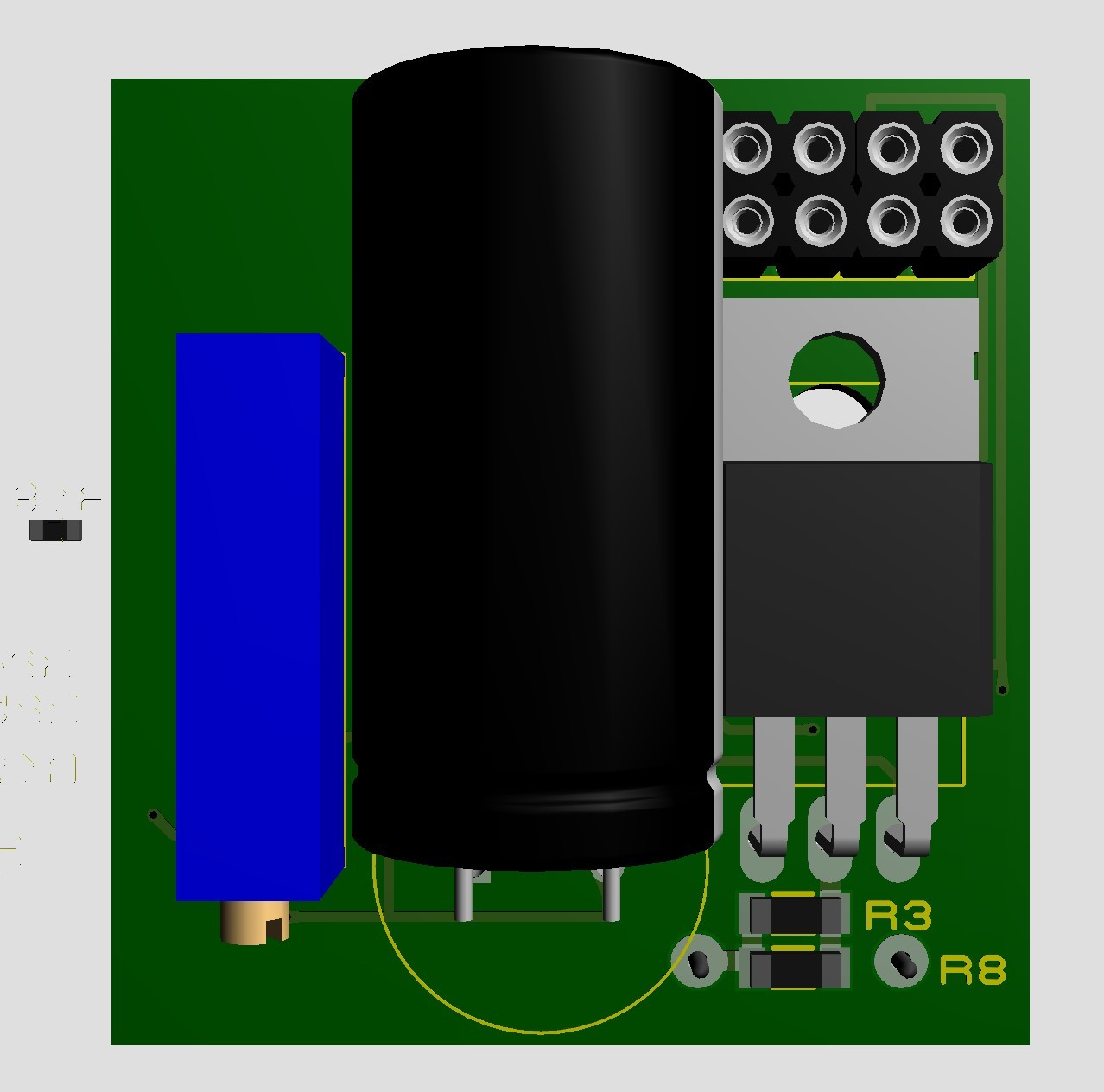

                        Hi David,
                        here some improvement ideas for your PCB.
                        1) Some mounting holes would be nice to have. Or do you fix the PCB with "Siemens air hooks" to the enclosure?
                        2) What about a heatsink for the MOS-Fett?
                        3) The PCB size and orientation of components. What enclosure are you intent to use? Actually before I make a new PCB I think first about which enclosure I want to use and where are my controlls located. Specially potis which needs adustments. The poti you choosed is okay but is it also accessable if the PCB is mounted with in the enclosure?
                        GeoMax
                          Here soome more ideas to improve the circuit board design...
                          4) A text legend of what detector it is and about the PCB version is always nice to have.
                          5) Mounting holes should fit the components. In your PCB design the mounting hole of the Mos-Fet looks a bit off center.
                          6) Tracks and other components are a bit to close to the mounting hole of the Mos-Fet.
                          7) Tracks should not run under the Mos-Fet. At least not on the site where the Mos-Fet is mounted.

                            Thanks for the sound advice, normally I would never draw a pcb without first having an enclosure, but I really don't know where this is going to end up... maybe the bin LOL
                            will the mosfet get that hot ? I have never made a metal detector just been around electronics all my life.
                            my main goal was to understand the code, that has been reversed Eddy knows this I have sent him most of what I have done. I am not trying to steal his work or pretended its mine.
                            I admire people willing to share their designs online, I see this whole thread as a way to understand how it works and maybe improve it

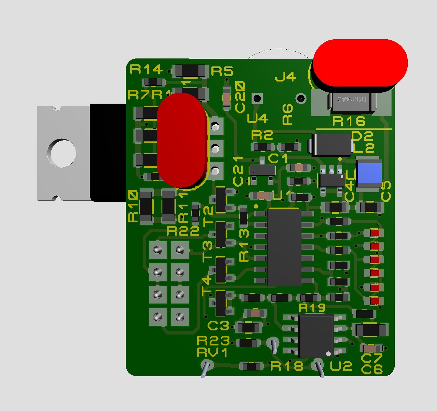

ID:	408420 Click image for larger version
ID:	408421 Click image for larger version
                              so its still work in progress, but I ordered them so lets wait and see
