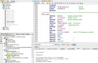

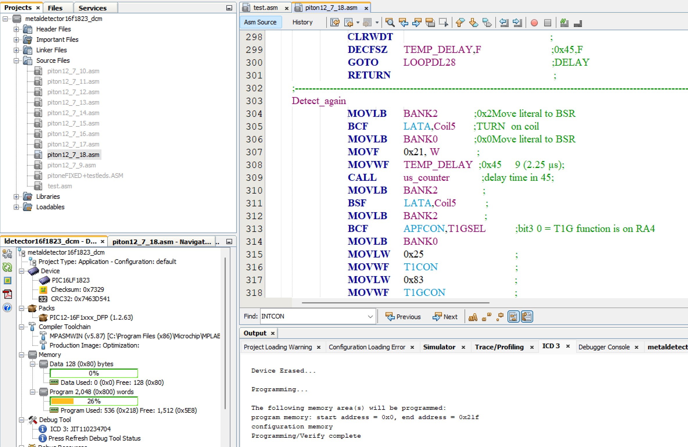

      so this file is a very cutdown version of Eddys code, I still need to fix a few things, but it works and has a serial output where the motor is connected.
      if anyone could test it that would be great
      • #93
        So I dont think I can get this any smaller ​

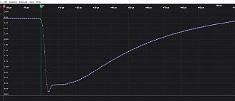

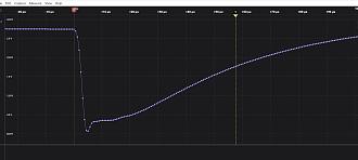

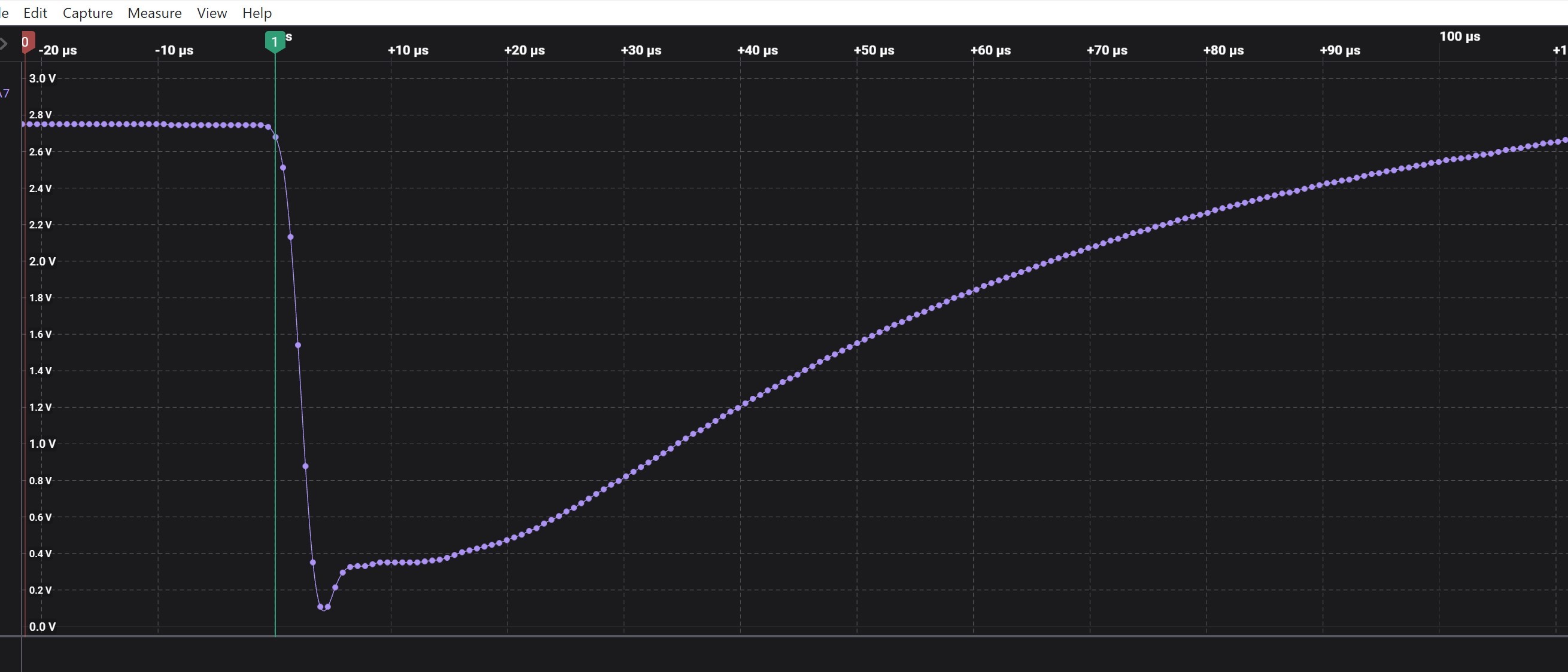

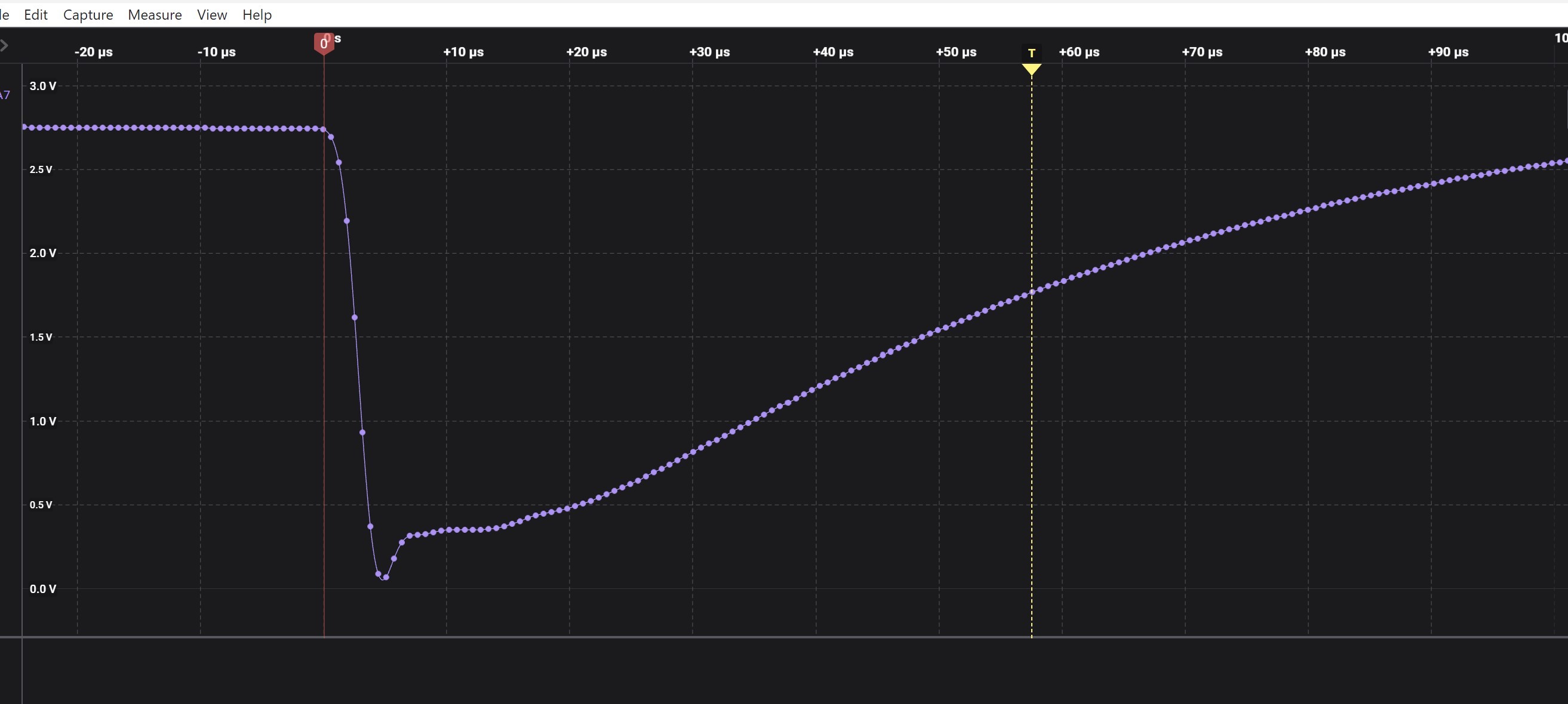

                  Following Surf Detectors video
                  https://www.youtube.com/watch?v=CrJ5tFFmWyo
                  I can now mess with the damping resistor... getting out of my comfort zone here lol
