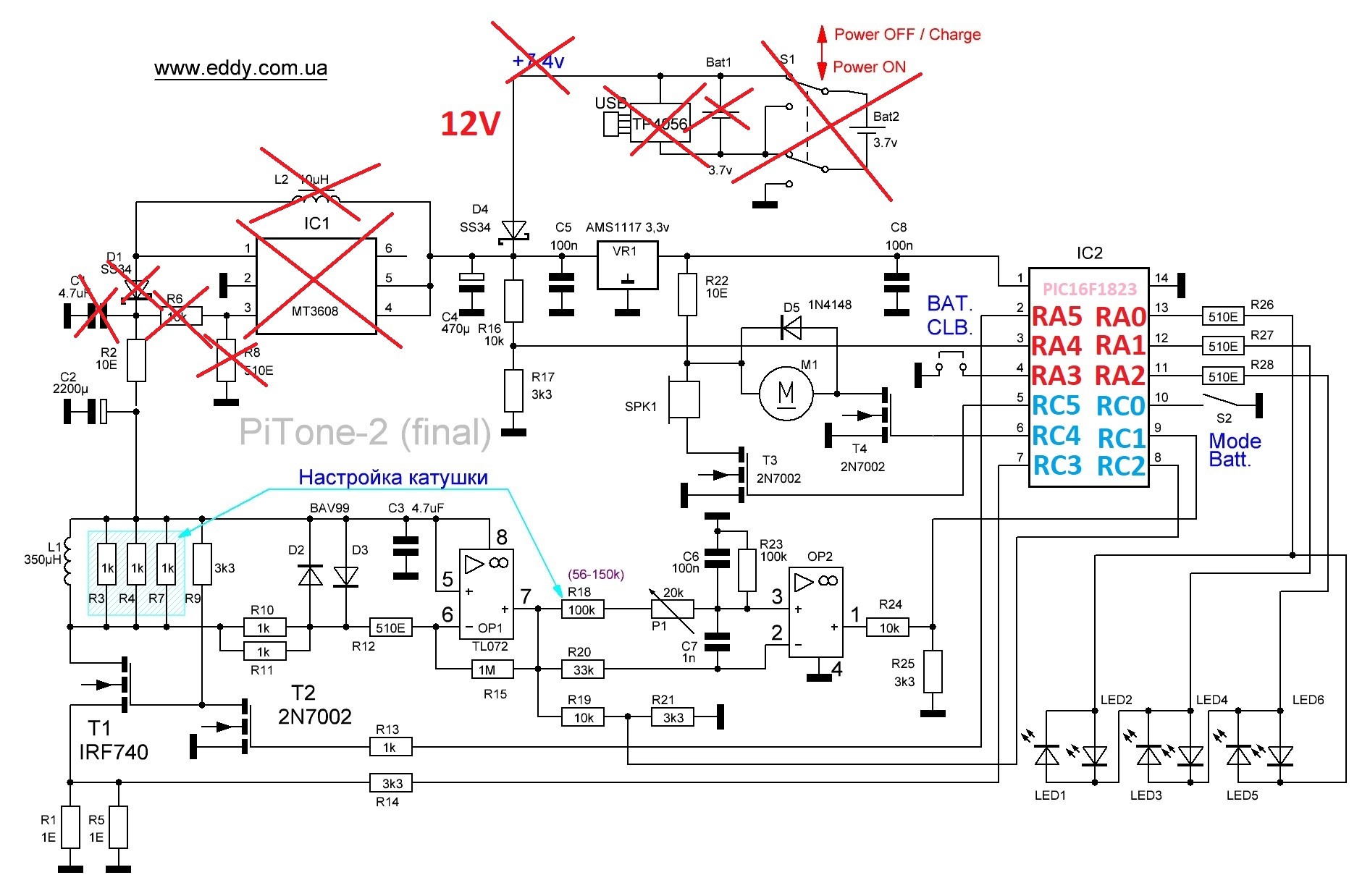

PiTone-v2-by-Eddy71 Has anyone on here built this ?
  • #76
    Originally posted by David_1 View Post
    But are you saying it's a mistake because it will work better on a battery ?
    Interference through the transformer from the mains causes noise at the amplifier output and therefore the sensitivity of the instrument has to be reduced very much. Normal sensitivity is achieved with battery power
    • #77
      Originally posted by sbalio1 View Post
      bat the same problem one led blinking and sound. is there enney answer for that​
      My circuit does not include the MC34063 because it is very noisy in operation - this reduces the sensitivity of the device by many times raising the trash threshold.
      But the first pass of the flame only checks the current through the coil.
      You have to check +12v power supply, resistors R1,R5,R9,R13,R14, transistors T1 and T2​
      • #78
        Hi eddy the s2nd led who blink in may dip pcb not first and the sound . Bat i ask about MC34063 if i can use it . Ihavent get all smd component. I just work with dip pcb . Can you make new pcb DIP .
        • #79
          The MC34063 is very noisy. I think this is going to be a problem. Unfortunately, I don't have the opportunity to do the hobby and draw a new board at the moment.
          • #80
            Ok friend . Is there enny cercuit i can use instead MC34063
            • #81
              An MT3608 or similar can be used.
              • #82
                Friend eddy i have DIP PCB WITH LARGE MC34063 AND TL072 AND PIC16F1824 . NOT SMD . I HAVE less component smd .
                • #83
                  Using DIP parts will severely limit your choices. Have you tried the MC34063? Did it produce the correct output voltage?

                    I am testing a pcb out on the bench with a 12volt power supply and a 3,3v regulator on the pcb, it works just fine, but taking outside might present some problems
                        hi carl where have you been . are you well friend . yes friend i test all part coil has 12 volt out mc34063 7.2 v i think all component work well . lets asking david 1 about new modification pcb. help david.
                        have you tried powering your pcb with 12volts ?
                        • #87
                          hi david friend i have 12v power the out of lm1117 3.3 v . i see you cut mc3608 .and you pcb work . can you help or explain. thanks
                          • #88
                            you claim you get a flashing led, it could be a voltage problem or an interference problem, removing the switcher IC... can limit the possible problems.
                            if the detector works on a good clean 12volt source we can the focus on how to fix your detector. All we know at the moment is it does not work and you're not sharing any pictures. So there is little we can do to solve the problem ?
                            • #89
                              sorry friend i well Leaving this machine i tray many ways to tun it correctly bat without enny result. i removed mc34063 and turn on with clean 12v . but no worked. i have not component SMD completed just large tl072 and pic16f1824. good wishes all my friends.
