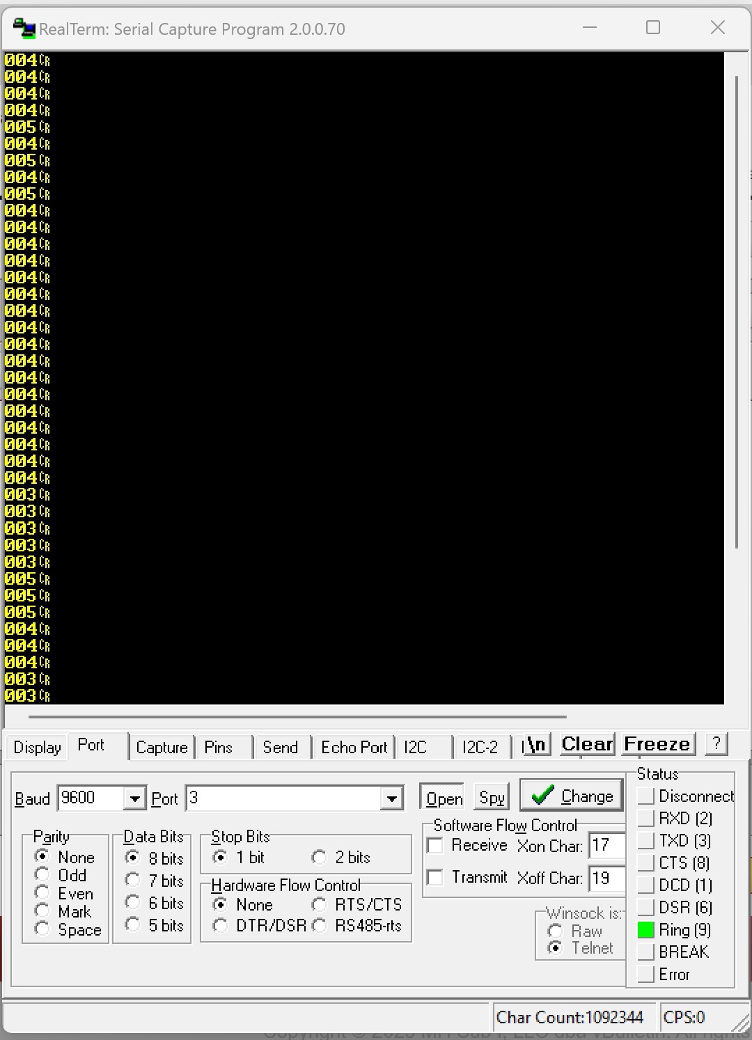

                seems to work on the bench just fine, it may not give the range, I dont know what is good from this, but it detects metal and shows one led fron a distance and as you move it closer it goes up to six leds
                better than that mine now outputs serial data showing 1 to 6 on the screen matching the led output.
                But are you saying it's a mistake because it will work better on a battery ?
                    This match's leds on my pcb, powered from a decent 12v power supply.
