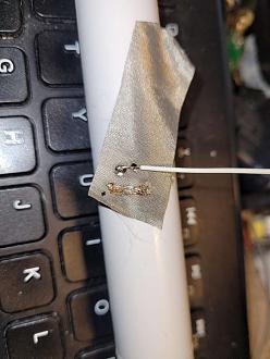

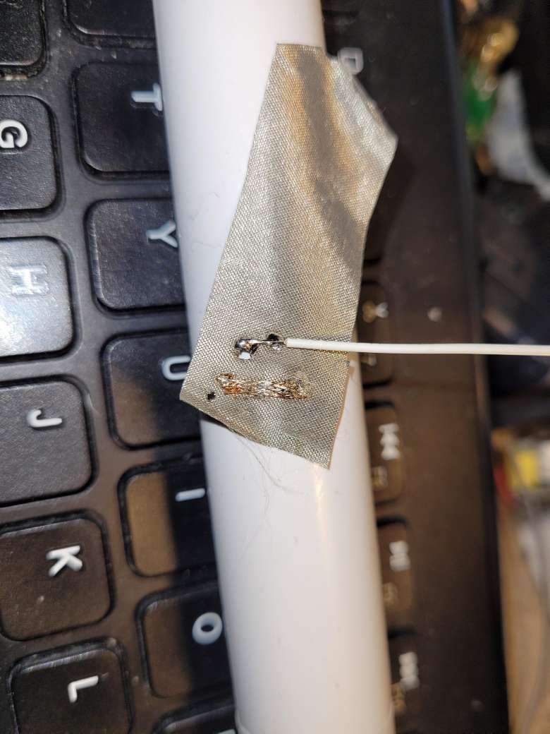

                  faraday tape, I bought a 40mm wide tape thinking I could cut it into the width best suited to wind over a coil.
                  so yes with some care you can solder to it, first I soldered a bit of used solder wick, thinking it might be more gentle (Its plastic ?), then I just soldered a wire direct.
                  This tape has a conductive glue so just over winding it makes a connection on both sides.
                  But yes you can melt the tape with a soldering iron
                    Use extra flux.
