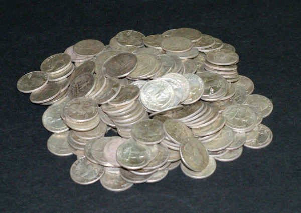

    Here is the cache... 3 pound of 90% silver coins.

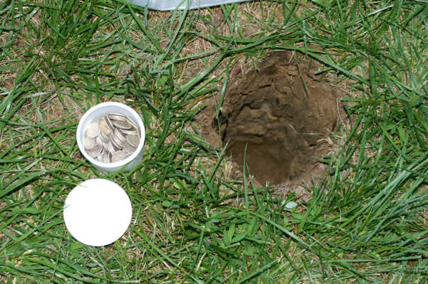

      Here's the hole, with Betty Crocker ready to, errr... go down.

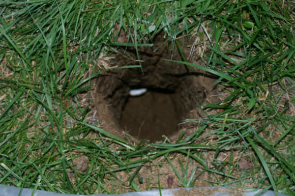

        Bucket o' coins at the bottom of the hole. Like Gary, I also notched out a little side cubby to stick the coins in, so the soil immediately above the cache is undisturbed.

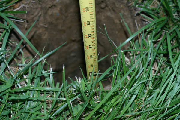

          Depth as measured from the top of the container. Exactly 24".

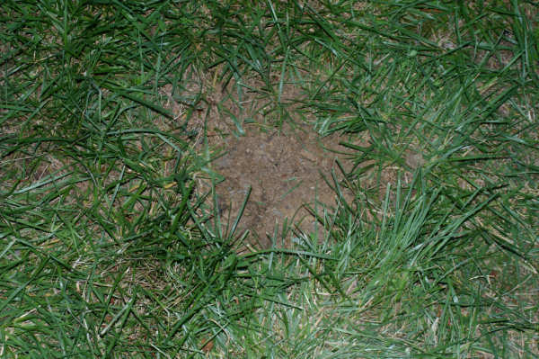

            Hole is covered. I'm seriously concerned that when the grass recovers, I may never be able to find my coins again. I need to add some method of marking the spot.
