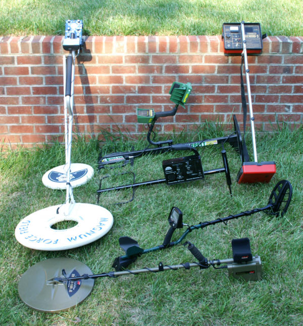

                            Here is a photo of the first round of detectors I tried. All failed. I had high hopes for that 24" coil on the 6000/pro.
                            White's 6000/di Pro with 15" coil
                            White's 6000/di Pro with 24" Magnum "cache" coil
                            Fisher Gemini 3
                            Discovery TF900
                            Minelab 2200/d with 18" mono coil
                            Garrett GTI2500 with Bloodhound attachment
                            Teknetics T2

                              WOW WOW WOW CARL THAT IS AN IMPRESSIVE LINEUP OF DEEPSEEKERS. IF NONE OF THEM CAN FIND IT MAYBE WE NEED TO CALL NASA AND GET THE LATEST MILITARY DETECTOR WITH SATELITTE HOOKUP AND STAR TREK TECHNOLOGY!!!!!!!!!!!!!!!!!! AMAZED AND A LITTLE CONFUSED!!!!!!!!!!!!!!

                                Hey Carl-NC this is the two detectors I would give a shot. The sierra madre by Whites with largest coil available and the X-200 by Compass with 16 in. coil. If these don't pan out try the industrial metal locators made by Whites and Fisher. They seem to be super sensitive to any type metal.
