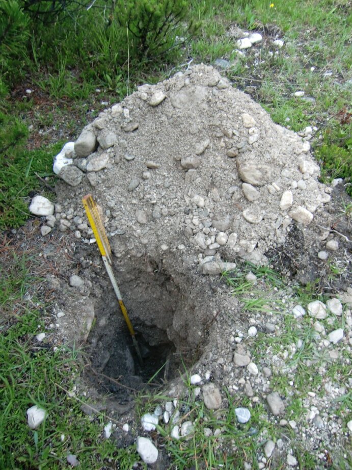

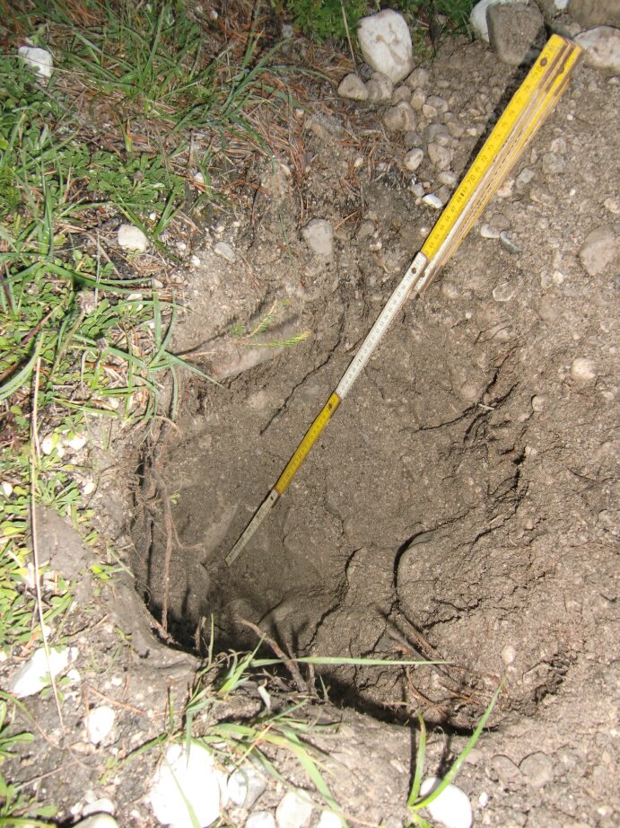

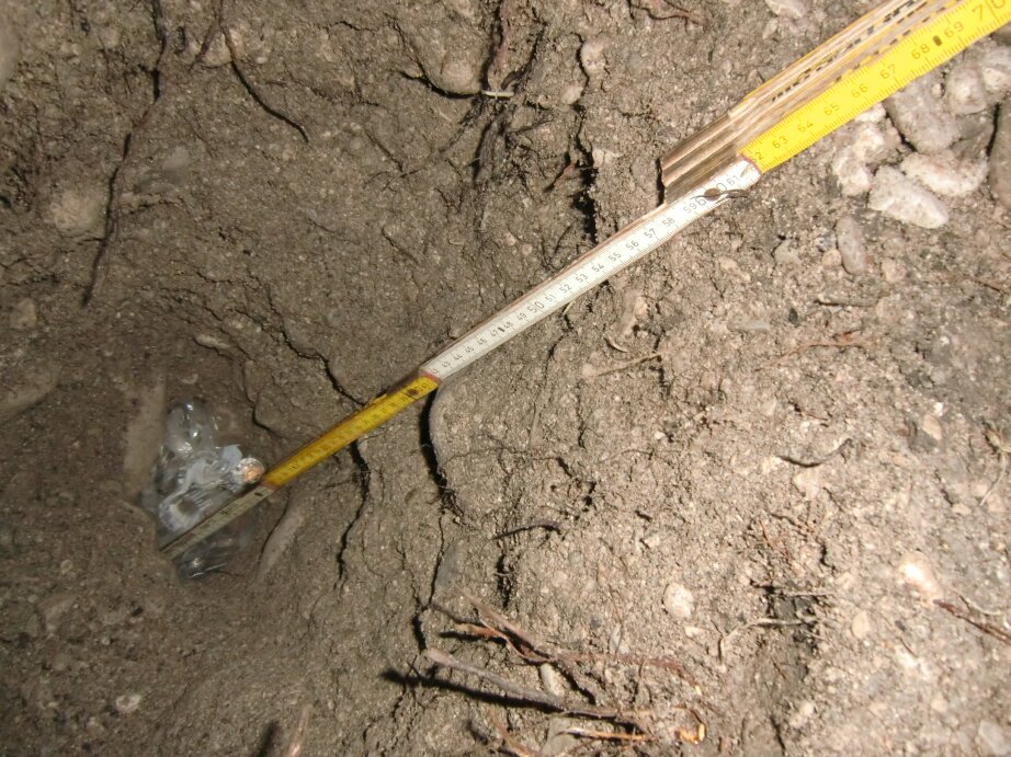

                          • Cache found with Jeohunter!
                            A few hours ago in the evening I reopened the hole where I found 2 months ago
                            that bucket-bottom almost 2 feet (55cm) below and extended it down to almost
                            70cm (2,1 feet).

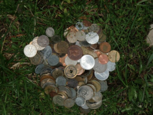

                            Before I gathered selffound and other available coins so I got exactly 1kg.
                            I put them into a plastic bag and down the hole - diameter around 10cm
                            and 1-2cm thick.
                            First detection with open hole at sensitivity 80% was good.
                            After closing the hole with stones and sand I still found the cache
                            but at 90% sensitivity and the signal was smaller.
                            However - the coins-area just was around 12x8cm of size and if it would have
                            been possible to spread them more the detection would have been even better !
                            And because of the not so compact stones after closing the hole
                            compared to the surrounding area the Jeohunter had to compensate
                            this distortion into direction cavity, too.
                            If you don't believe that result get the Jeohunter or Jeoscan 2D with standard
                            45cm coil as example here http://www.metaldetector.cc and test it on your own.
                            btw. those results are almost the same as described at the general
                            search antenna table: 10x10cm object depth = around 75cm
