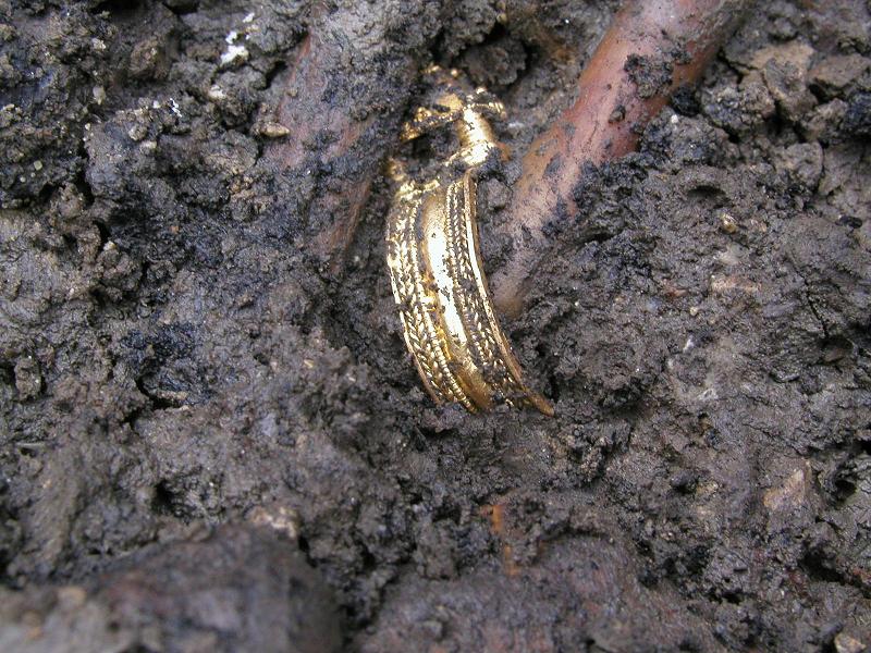

        • Oxidize this.
          In nature gold does not oxidize very fast
          With very fast I meant geological time - in terms of human counting of years or centuries the gold does not oxidize visibly.
          Attached is picture of golden ring from grave 1400 years old (AD600).

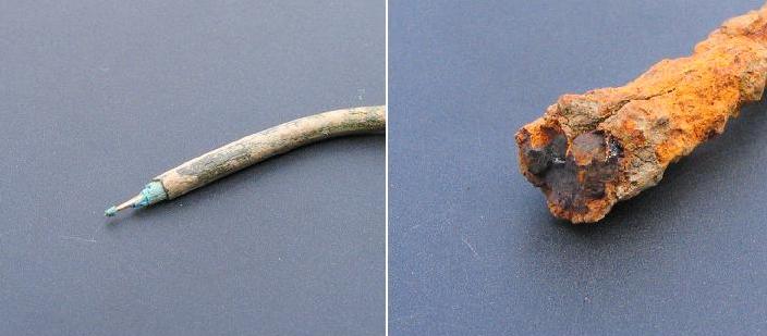

            • Copper Vs Iron
              Attached are two photos.
              Left is a fragment of a damaged bronze needle 2500 years old. You can clearly see what happened: Bronze patina (copper oxide+) completly transformed shiny bronze. Dark green patina is original surface of needle and the golden core is what remains of bronze. Such objects are very hard to detect even with lowest dead times - copper oxide is just too bad conductor.
              Bronze can leave green stains if an object is lying on very poreous material as bone, leather... and usually can not be seen in surrounding earth (except as a thin layer around object), but as said - copper oxide is poor conductor and can not help with detection.
              Right is the iron nail (medieval). The story here is different - the edge of dark core is original surface of the nail and the brown-yellow mantle around it is of course iron oxide. Iron oxide in high concentrations can be detected with metal detector - and here can be the cause of Fe objects having halo effect.
              As other people experimenting with MD I noticed too how some items can be detected deeper in undisturbed ground than air but probably this is not because of leeching ions etc., but we should investigate how magnetic fields propagate throu undisturbed soil Vs air.... I bet there lies an answer to infamous halo effect.

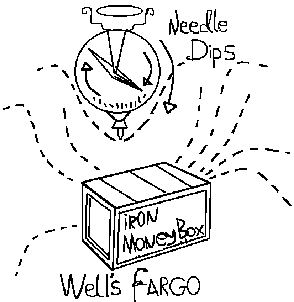

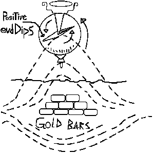

                          • hi
                            why are you trying to find new phenomens.all of us know the truth about gold.does not ionize.
                            but there is something about it.it is diamagnetic meterial.reflects the the energy what ever causes it.Even a detector or earth.
                            have a look at this page .it is the phenomen used in magnometers also.
                            and minoro and zahori uses the same.but zahori and mineoro only takes the +
                            positive signal which comes out of earth.
                            I remembers Esteban's experience for a empty hole which burned 3130.
                            why here nobody else tells about this?
                            do mineoro effected by cavities.?
                            and magnetic flux of earth changes place to place according to resisitivity.is not it?

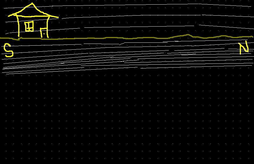

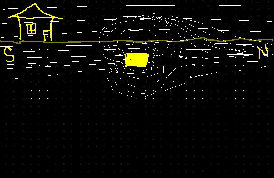

                              • I think it is clear why zahori works north to south.
                                and why it detects farther from the north.
