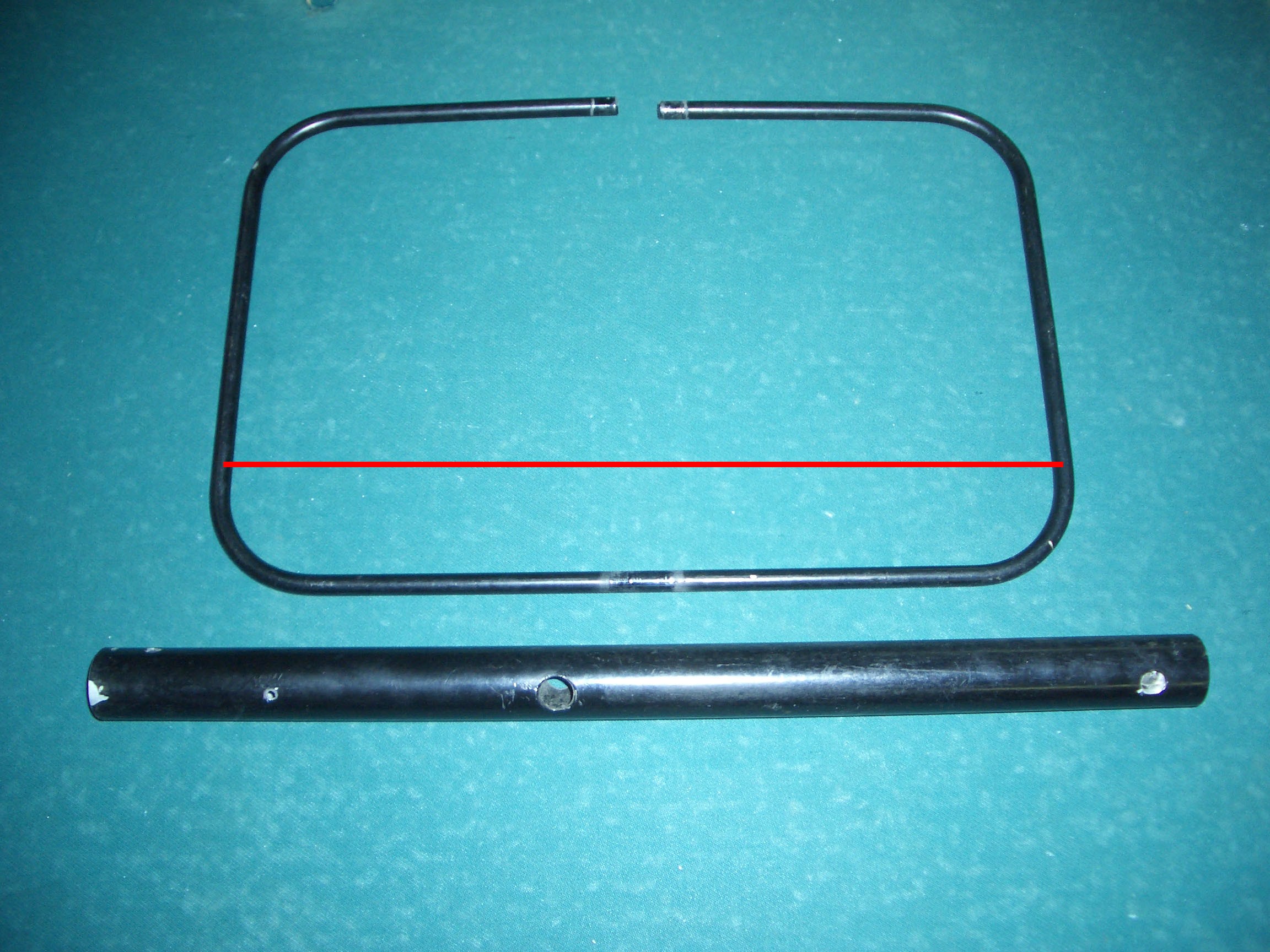

    Bought a Discovery TF-900, with a broken-off transmit coil, but in otherwise good condition, and a Discovery TF-1200. I'd bought an Arc-Geo Logger from the same guy about 3 weeks ago, and it works great. Because he wasn't sure how well the detectors operated, and was clearing out a bunch of stuff he said $100 shipped would be fine, so I jumped. Any Info anybody has on that TF-1200 would be much appreciated. I'd happily pay for a manual copy for it. After following Ivconic's thread about rebuilding the TF-900 (many thanks!), I may be able to repair the 900.

        I visited Discovery not long before the last owner (Roy) died. The only things he was building were Bigfoot coils and the CS9000, which was a rebranded TF900 for CScope in England. At some point Roy may have made the TF1200 but I doubt it would be anything more than a minor tweak of the TF900. The 1200 TX coil should work on the 900 so you would be able to see if it is otherwise good.

                screw off the screews on connection of antenna ring. pull it out, turning itself. you HAVE TO PULL OFF THE RING before to do something.
                  Thanks, Carl. I'd thought I might be able to use the 1200 coil on the 900, and I'm glad to see you suggest that. All I was after in this was to end up with a backup for my TM-800 (TM-808 w/Cave). I'm getting into the Arc-Geo interest, so wanted a backup. The selector/on-off switch in my 808 is getting funky, too, so I've got some work to do.
