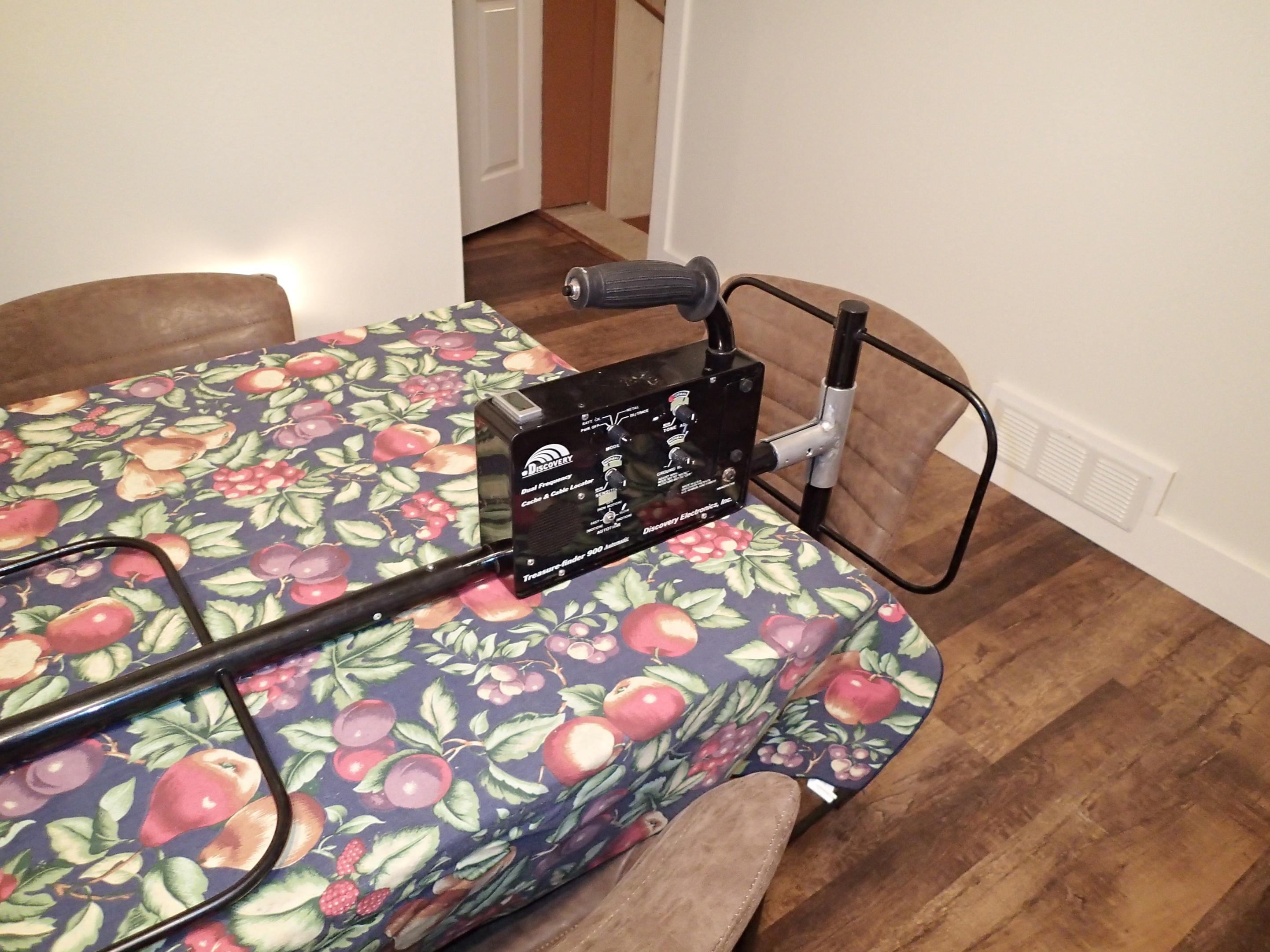

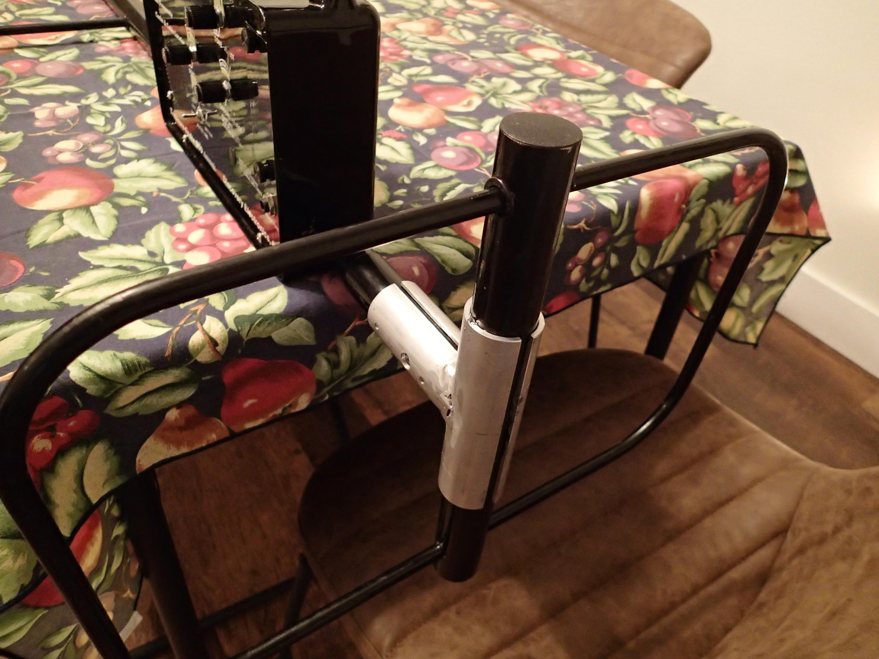

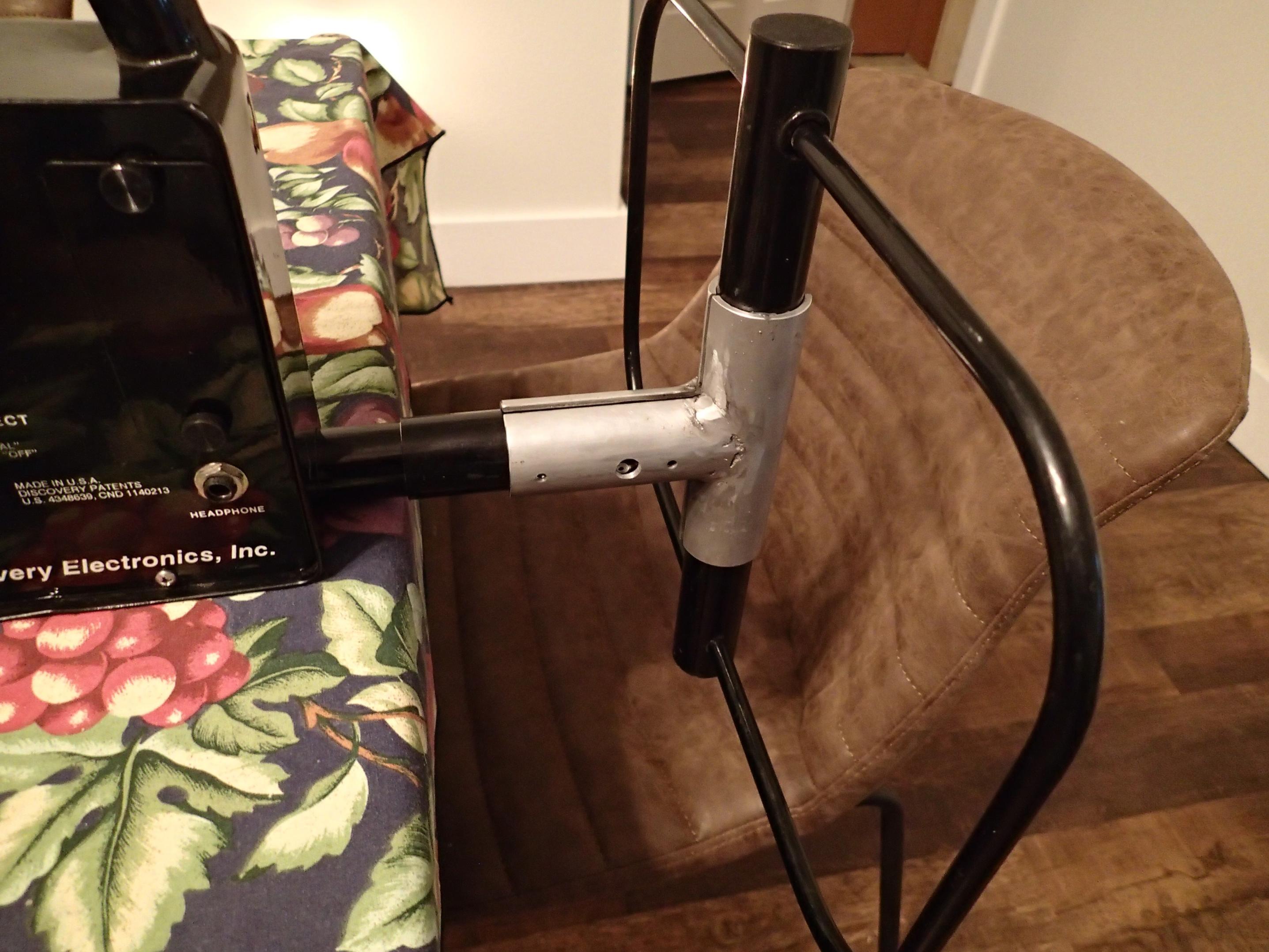

        Well guys, it looks like the deal was very good. Even after sending him $100 more than we agreed on. For $200 I ended up with two very good working detectors. Here's pics of how I repaired the 900's transmit coil. I bought a 12" length of 1 1/4" I.D. aluminum pipe. Put it in the mill and bored 1 1/4" holes in it to make perfect joints. Then sliced the pieces lengthwise so they'd fit over the original tube. Drilled clearance holes so the rivets in the original tube could be accessed when necessary, and MIG welded the sections together. Glued them to the original mast and stub with JB Weld epoxy. I think it turned out pretty good, and a stronger joint than from the factory. I tried the detector and it works great!
        Click image for larger version  Name:	PC050002.jpg Views:	55 Size:	533.4 KB ID:	417361 Click image for larger version  Name:	PC050001.jpg Views:	53 Size:	519.9 KB ID:	417362 Click image for larger version  Name:	PC050003.jpg Views:	53 Size:	575.0 KB ID:	417363

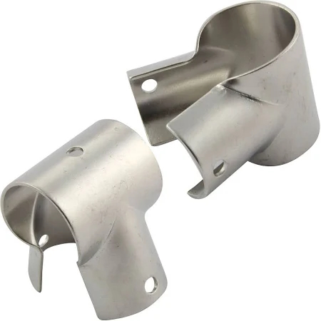

        Hi Jim nice work... but why have you not bought right away a T-pipe connector in a hardware store? Something like this in the picture below.

          Because I wasn't aware of it...LOL. But, mine is stronger, and covers a greater area, MAX. And, I always think of making things first.
          Jim
