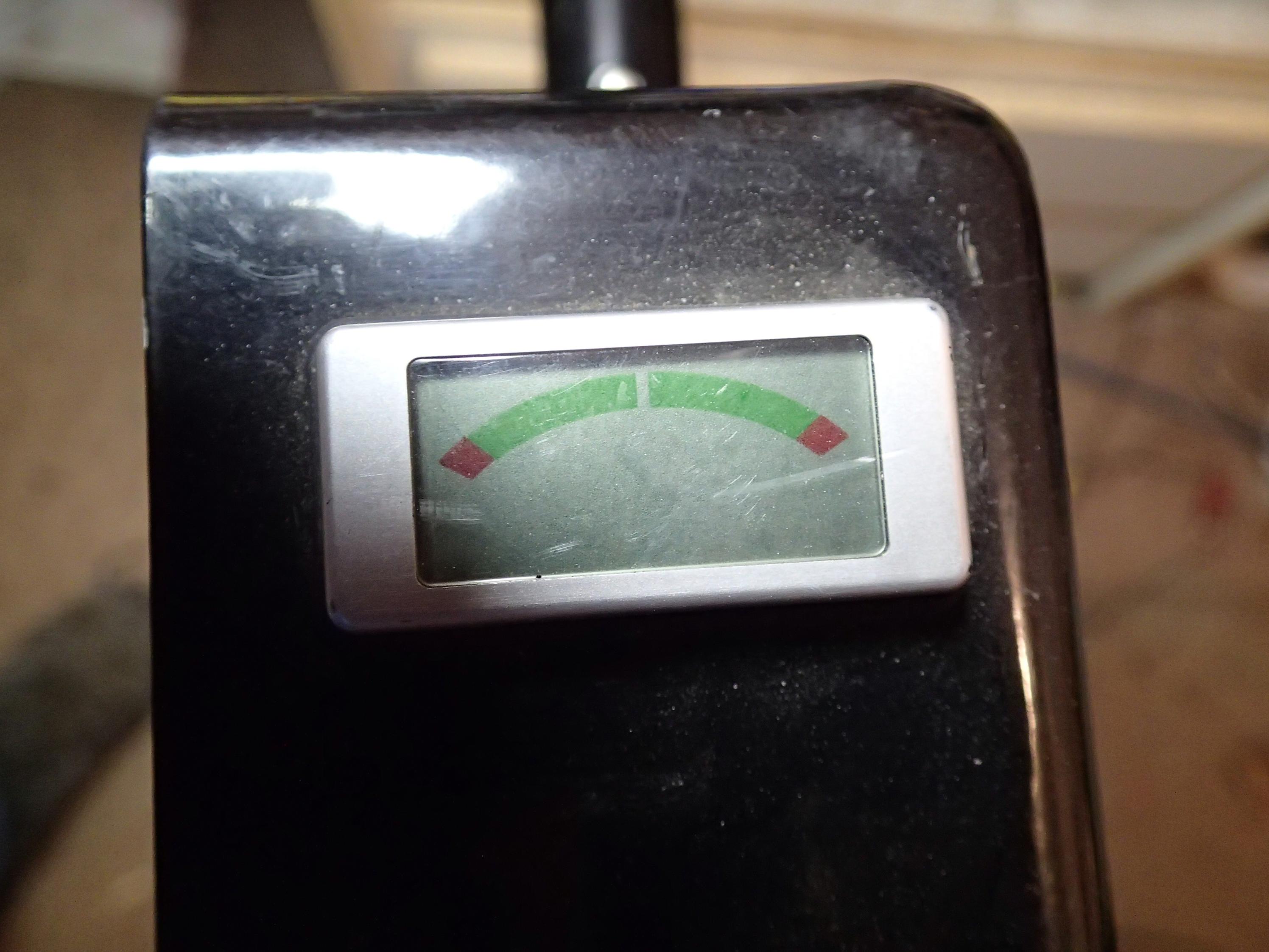

    Here an image of the C-Scope meter...
ID:	417057 [COLOR=inherit !important]
    [/COLOR]
    Nearly identical to the meter in my TM808.
    Jim

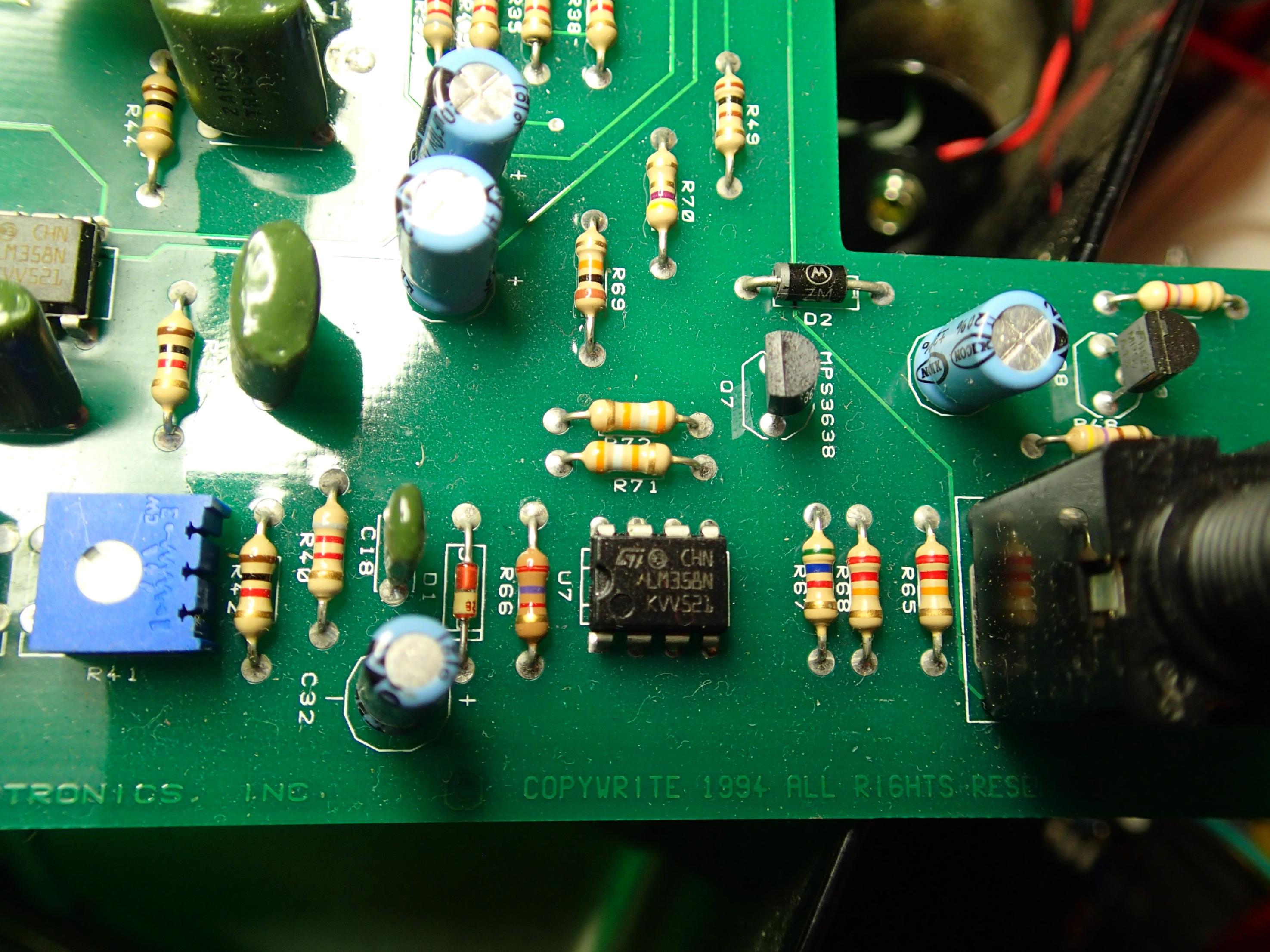

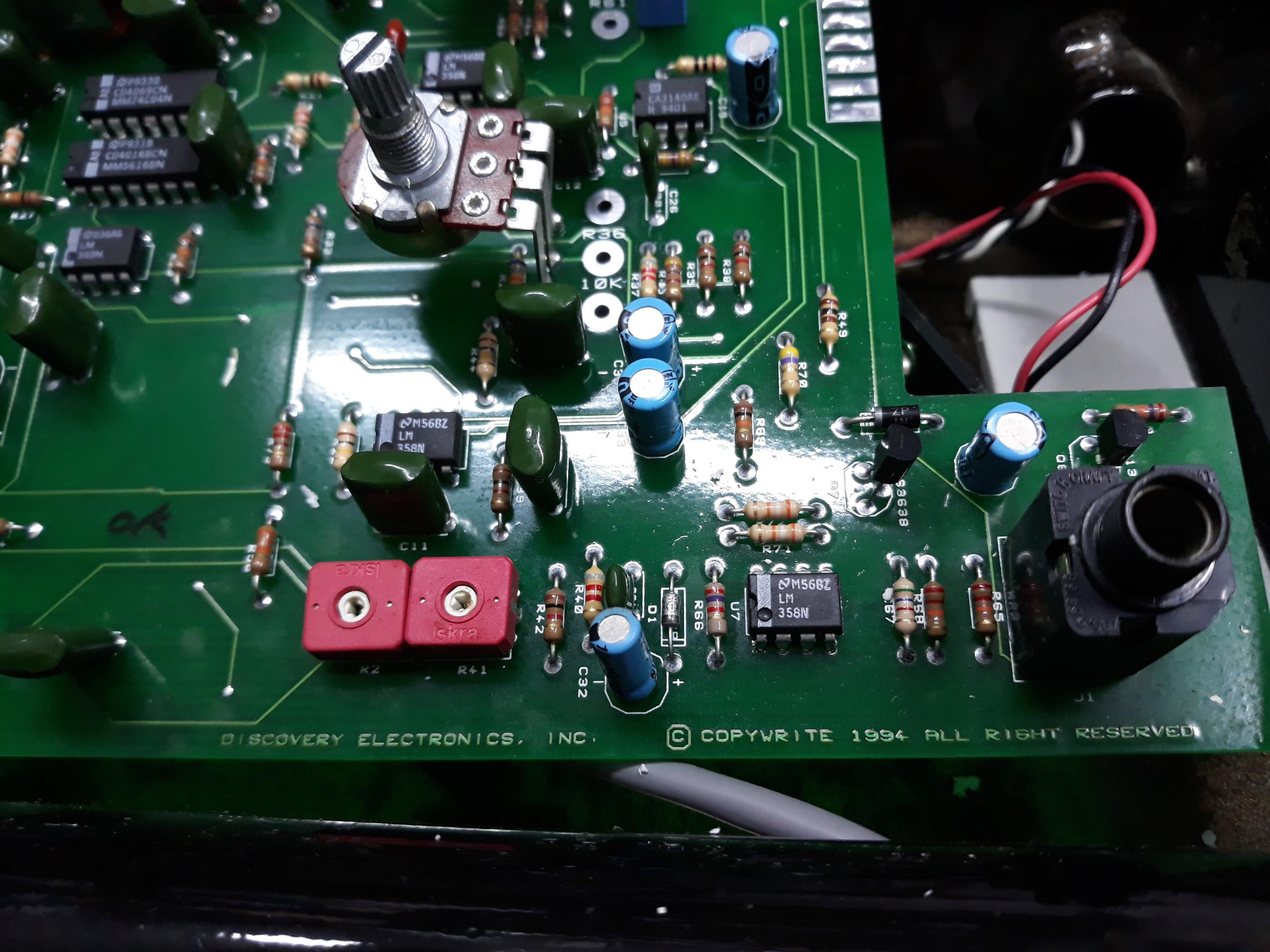

      Here an image from that area around U7... maybe it helps. By the way... on the PCB is also stated Discovery Electronics Inc. but sold under C-Scope UK.
      Click image for larger version  Name:	20231123_180054.jpg Views:	0 Size:	544.2 KB ID:	417051
      • #63
        thank you. sure obviously they changed the meter on another, with different parameters. IMO they 'lost' primary provider, but found another one.
        so they were forced to change the components around the op amp, getting different gain.

          oh mama mia i did not notice your video link. they changed the analog meter on... LCD one!
          so that why TF1200... a discovery for me!
          • #65
            More changes then one would expect, KT!. I think, the little I tried it, the 1200 is better than my TM808 (800). That TF900 I bought has the same LCD meter.
            Jim

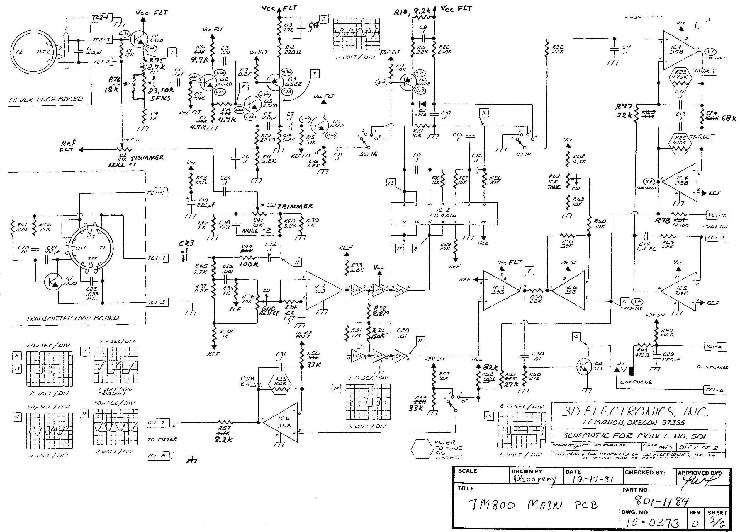

            • #66
              look here Jim c.scope cs9000 HPX - Geotech Forums (geotech1.com)​
              • #67
                TM 808 White's - Geotech Forums (geotech1.com)​

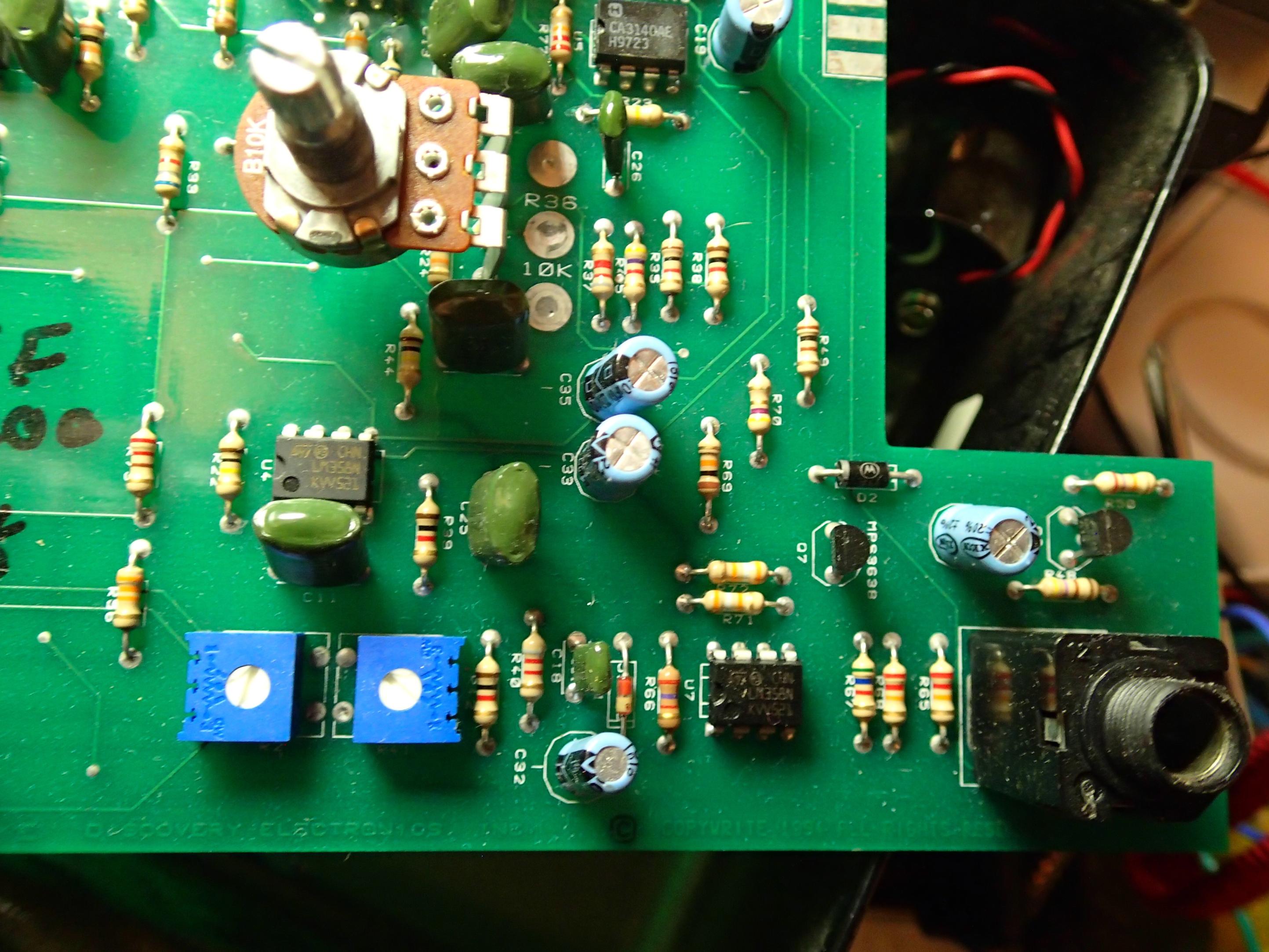

                  The lower right part of the pcb.
                  Close up around U7 (screenshot). ​
                  And check if the zener diode is 5V6 too?

                  Ah, so it's an LCD scale?!
                  It's the first time I've seen such a thing!
                  I have a simple analog scale.
                  That explains the change of resistors on the pcb, from that other picture.

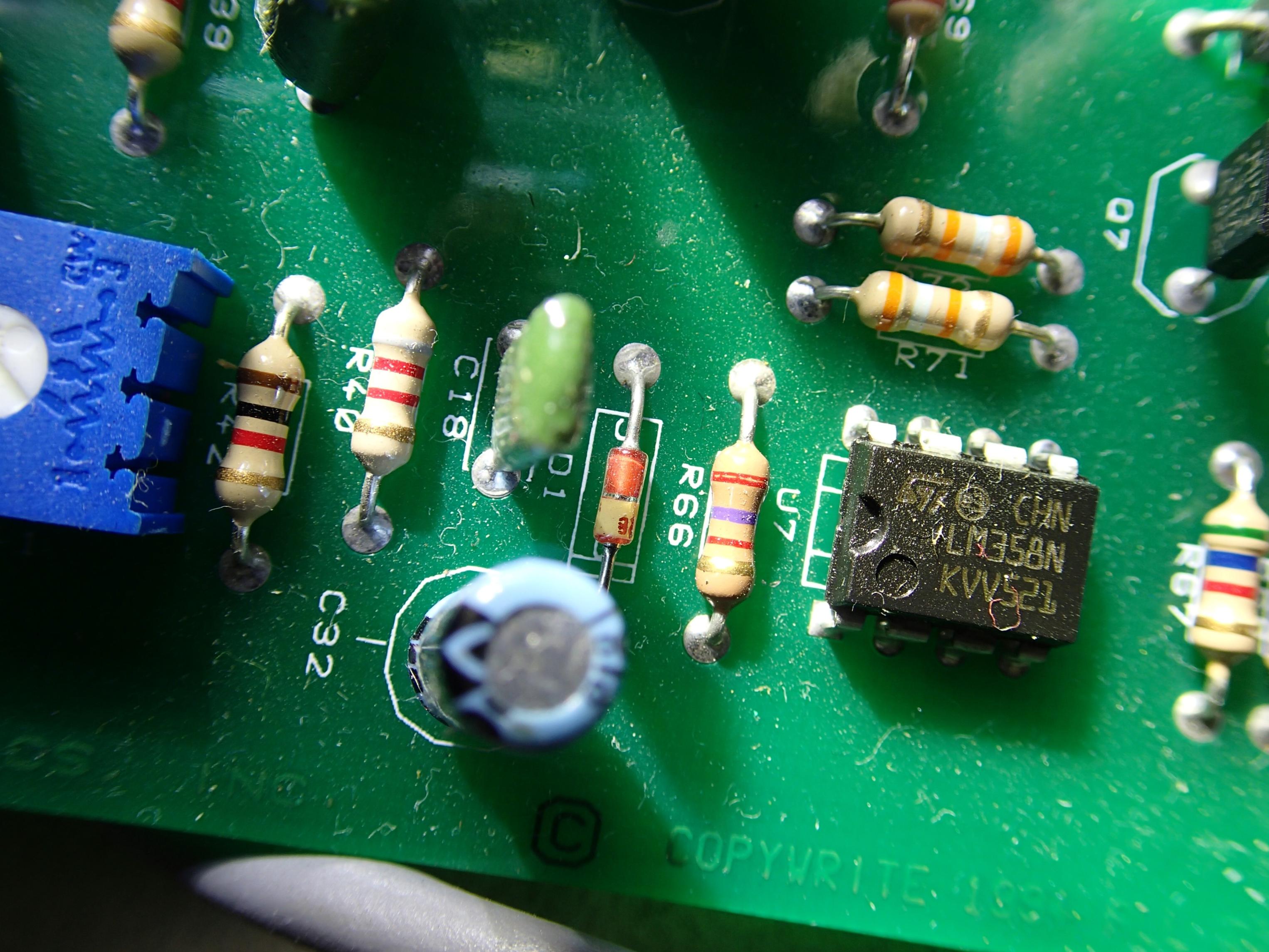

                  Here's the pics, IV. My board only shows "D1" for the zener, and I could not identify the markings, even with microscope. So, I got as close as I could.
                  Jim

                  • #69
                    One more closeup. Last two digits look like '28'.
                    image widget

                      In case someone needs a replacement, I think this is the LCD meter?
                      https://www.digikey.com/en/products/...-1710/10259107
                      • #71
                        really V analog meter is current meter, it has some R internal. LCD has also R internal but another, probably significantly more. that's why there is necessity to change the meter driver op amp's setting.
                        • #72
                          Jim
                          Click image for larger version  Name:	PB250002.jpg Views:	0 Size:	608.3 KB ID:	417086 Click image for larger version  Name:	PB250003.jpg Views:	0 Size:	613.4 KB ID:	417087 Click image for larger version  Name:	PB250004.jpg Views:	0 Size:	559.0 KB ID:	417089
                          in the archive (7GB on my GOOGLE disc) you can find my BOM file on TF900. there you can read - D1 zener 1N5232B
                          i always do my Home Work, Jim.
                          also, you can read on the schematic that on its cathode is sure 5.6V.
                          ok, now a view from my window for u Jim.Click image for larger version  Name:	CIMG7672.jpg Views:	0 Size:	788.8 KB ID:	417094
