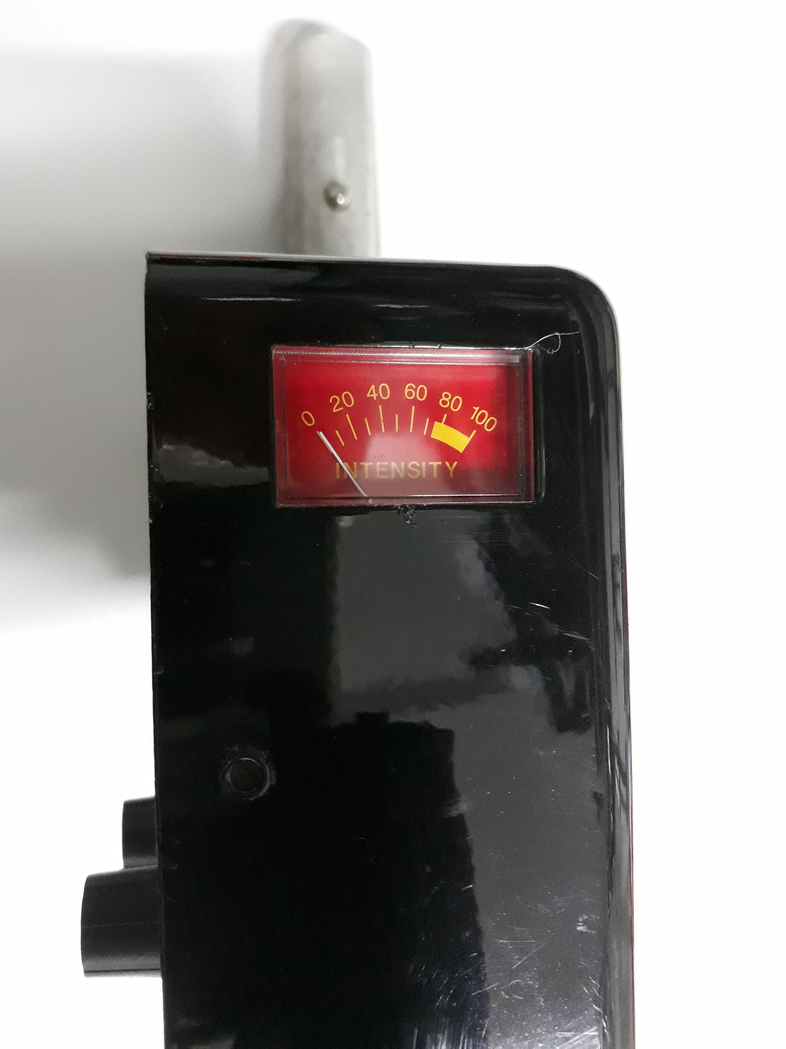

    Check if the scale is original.
    This looks like a modification around the sensitivity of the scale, in the picture.
    they just began to use another meter. it's obviously for me, i hope Jim will give pics of it and we will see. the board is REVISION E. same like in TF900.

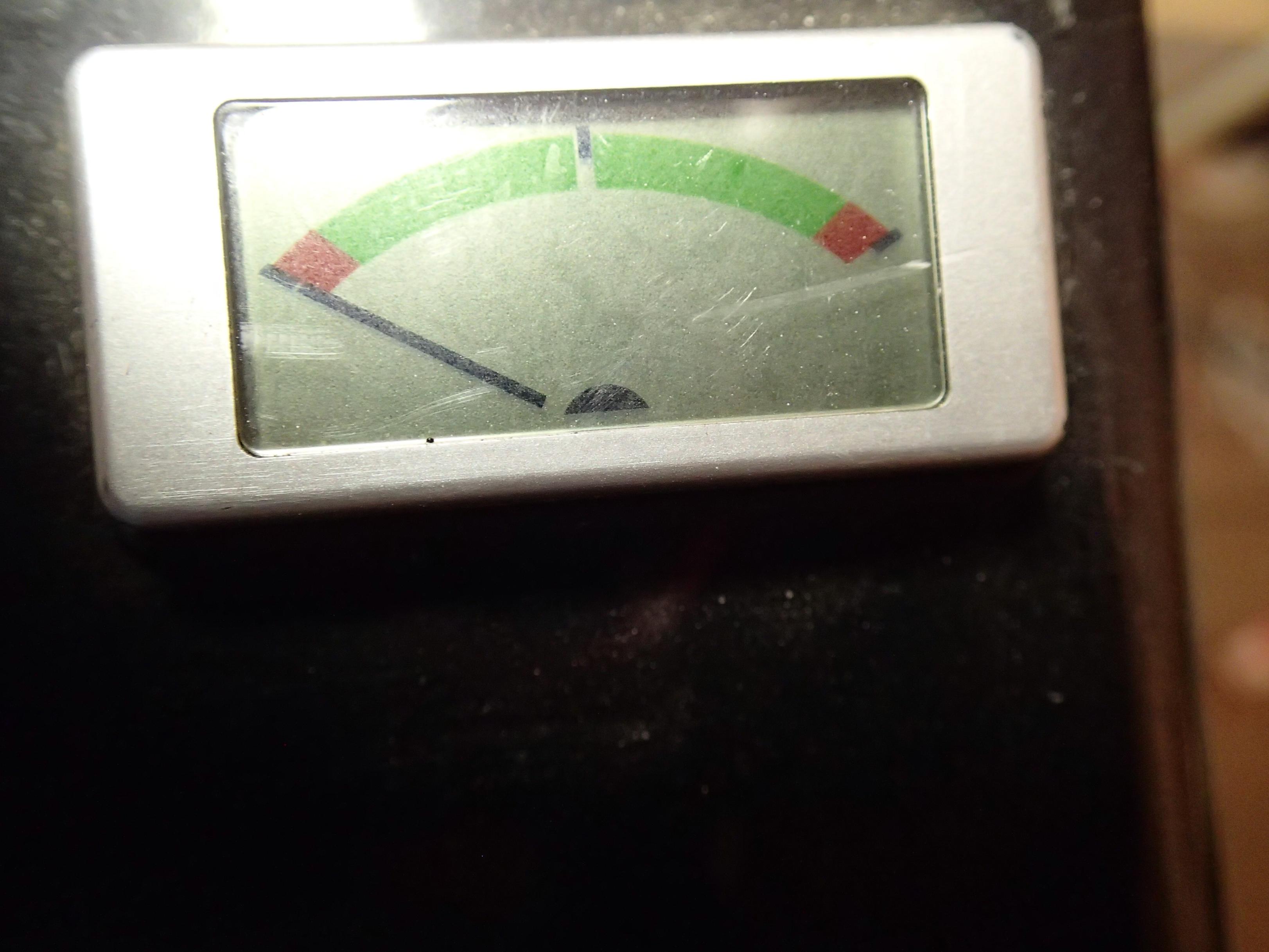

          • #50
            I spent an hour trying to upload everything, and ended up with what you see. First pic is meter with power on. 2nd pic is meter with power off. Link is to video of meter in "Battery Check". Batteries are low and that may be why it's acting crazy. Obviously the meter is digital, and not analog, as the needle and small, dark markings are not visible when power is off.
            Jim

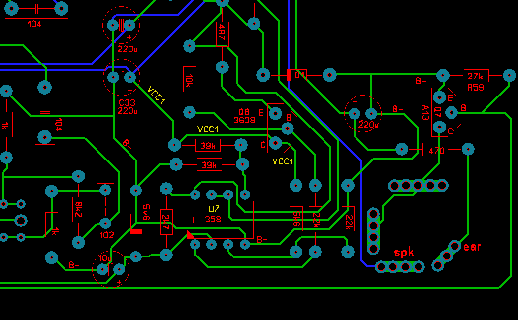

                    The lower right part of the pcb.
                    Close up around U7 (screenshot). ​
                    And check if the zener diode is 5V6 too?

                    Ah, so it's an LCD scale?!
                    It's the first time I've seen such a thing!
                    I have a simple analog scale.
                    That explains the change of resistors on the pcb, from that other picture.
                    • #55
                      Here an image from that area around U7... maybe it helps. By the way... on the PCB is also stated Discovery Electronics Inc. but sold under C-Scope UK.

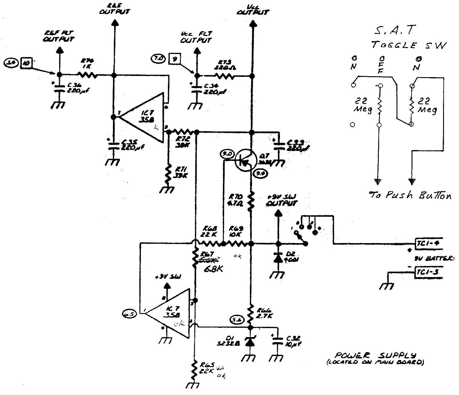

                      • #56
                        The only thing I was interested in was whether the TF900 could work directly on 12v.
                        why not? they used linear stabilizer so 7V on output is good for 9V on input.
                        9V+ will work always. 12... 14... etc. but better way to rego on impulse chinese converter STEP UP and supply from one pc 18650 li-ion.

                              Here an image of the C-Scope meter...
ID:	417057 [COLOR=inherit !important]
                              [/COLOR]
